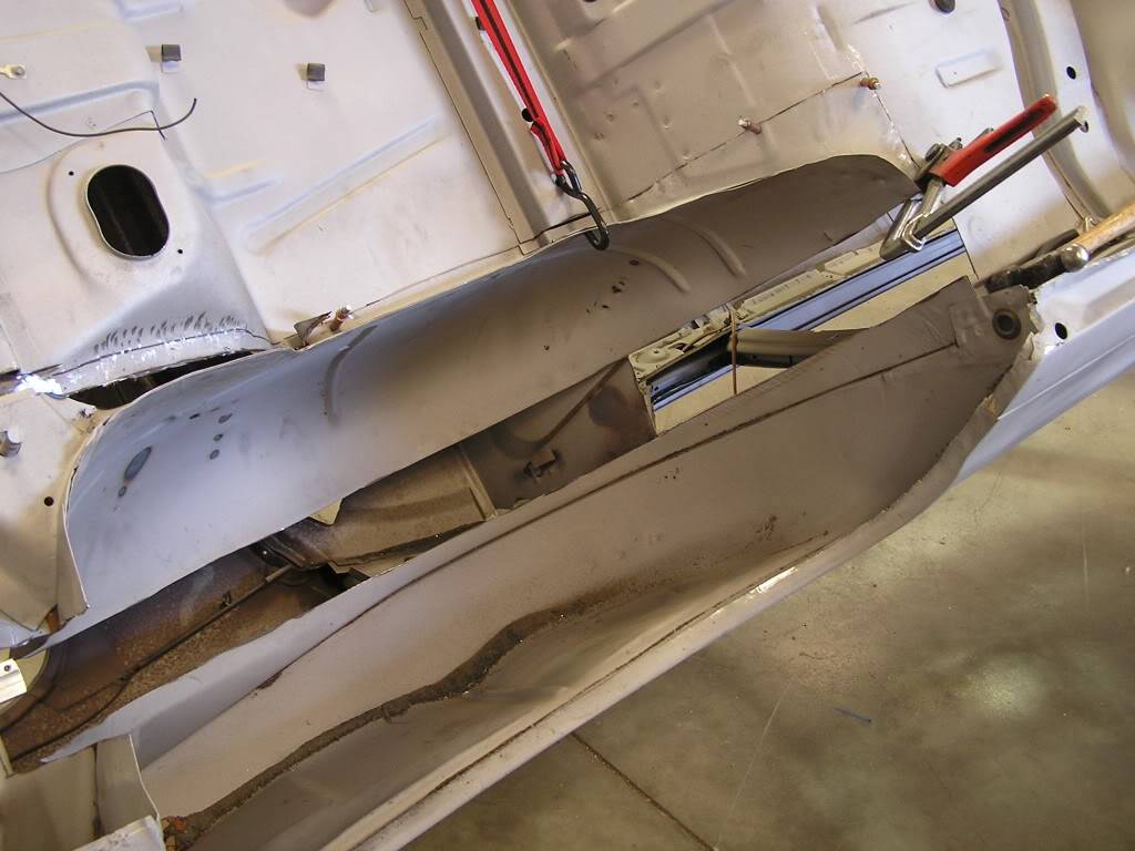

      I have gotten some headway
      Body back from the media blaster it's in good condition just a bit of rot in the window area.
      Removed the drip rail's and are all welded up.
      Have the left side mini tub done working on the right side.

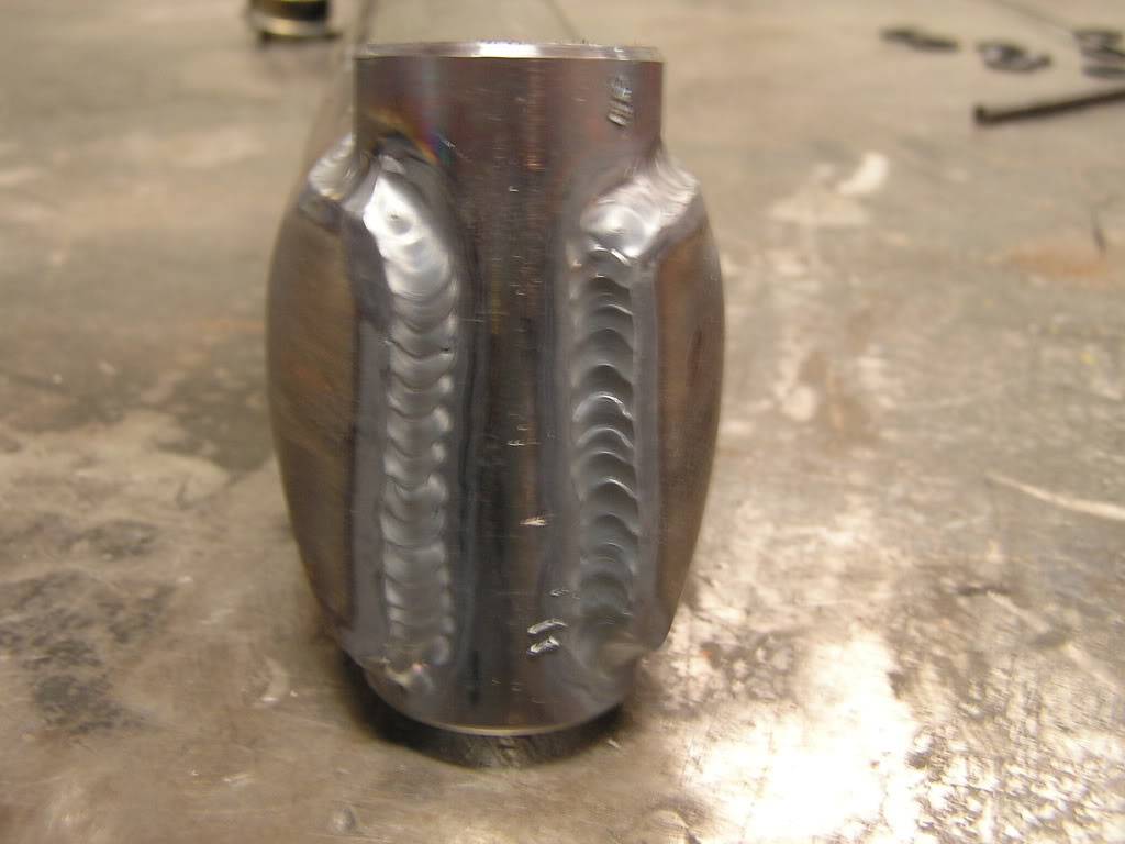

      welds

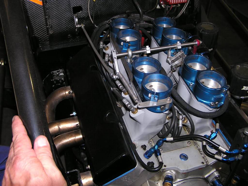

      Ya want to see a picture of the motor?
      Aug 2010
      modesto calif.
      54
      410 chevy

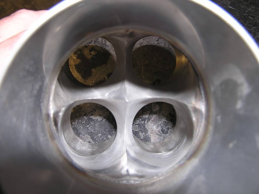

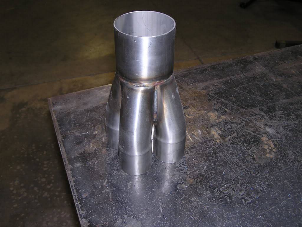

      I build my own headers this is the collector i will be using this on this build
      Aug 2010
      modesto calif.
      54
      inside
