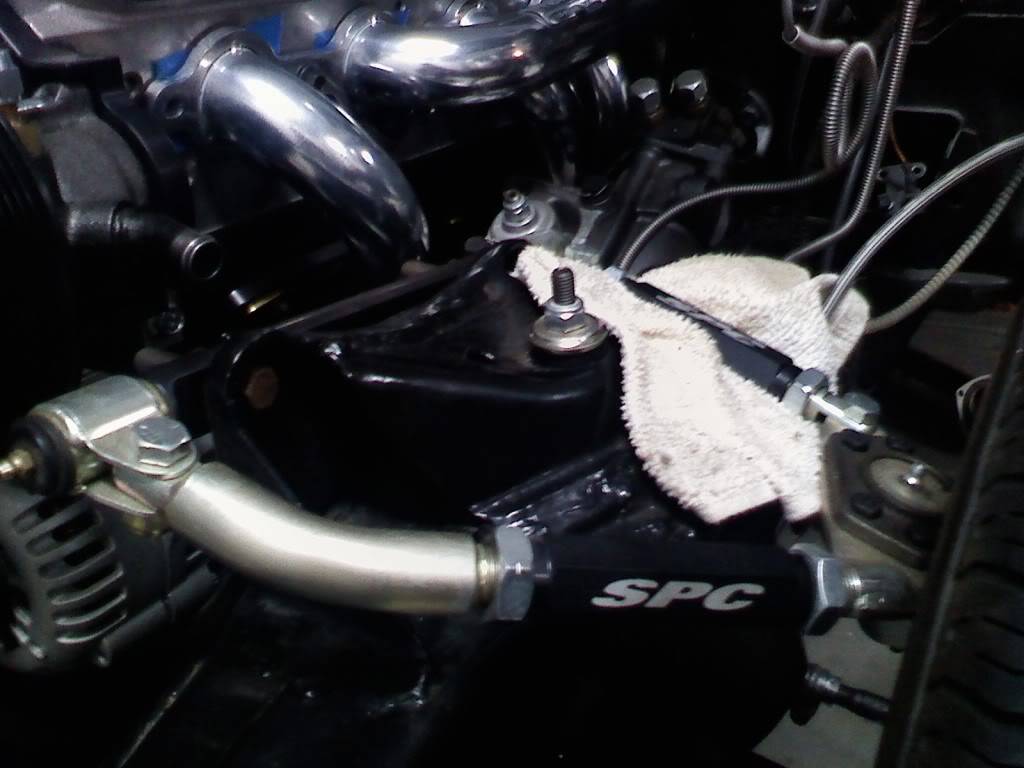

      I'm using ats spindles and spc upper control arms with 550 springs on a stock sub frame. I installed the engine and trans and put the car on the ground for the first time in a looooong time. The upper a arms are still against the frame???? Whats the problem here? It's like there isn't an engine in the car the way it sits.
      Did I install something wrong? My friend and I stood on the frame horns and jumped a little and it barley moved. Do I need to cut the springs? Tyler sold me the coils way back and I installed the front clip right after I received the parts but just now got some weight in the car.

      im guessing your front sheet metal and radiator are not in the car yet?
      may have to trim to get the desired ride height. after you fully assemble the car

      are your bushing bolts loose? you should tighten them at ride heigt. That could be holding the car up also. Loosen the bolts and jounce the car and see where it is at before you tighten them up.

      The ats a-arms bushings are really easy to move and the lowers have delrim bushings. Before I installed the coil, both a arms and spindle moved super easy.

      springs will settle. also roll the car around the garage back and forth. Sometimes the tires can be held in a positive caster postion, this can hold the car up as well.
      dont modify the spring until you at least drive the car.
      also cutting a coil will increase the spring rate. If you remove 1 coil from a 10 coil spring then you will increase the spring rate by 10%. so a 550 is now a 605. the car will sit lower but be a harder ride.

      If they are 550s it will take 1100 lb to lower the front end 1 inch, so it's no wonder you and your buddy didn't have much effect on it. Remember, if you cut the springs they get even stiffer. On your Camaro, each coil would be worth 10-12% increase in rate, so I'm not sure I'd go that route...

      Can you get a finished front axle weight from someone who has the same engine in the same car? Even if you have to add the weight of the SC separately, a starting point would help.
      Then set the car at desired ride height with the front springs out. This is not weight sensitive, so don't worry about the car not being together. Measure the available spring installed height (a-arm perch to frame perch). Lets say you have 10"
      Whatever the total axle weight is (say 1500 lb), subtract 150-200 lb for unsprung weight (depends on tire/wheel combo and brakes...if you have the ability to weigh a complete front suspension/ tire assembly, do that and don't guess). So we have 1300lb supported by the springs when the springs are 10" long. Each spring is carrying 650lb, so we could use an 11" spring with a 650 rate, or a 12" spring with a 325 rate, etc. Lots of circle track racing mfrs sell rated coils in stock diameters and various lengths, so you should be able to get exactly what you need without cutting.
      I'm reading more and more about so-and-so's "lowering springs" not ending up at the correct ride height. There's no substitute for knowing and buying exactly what you need...
