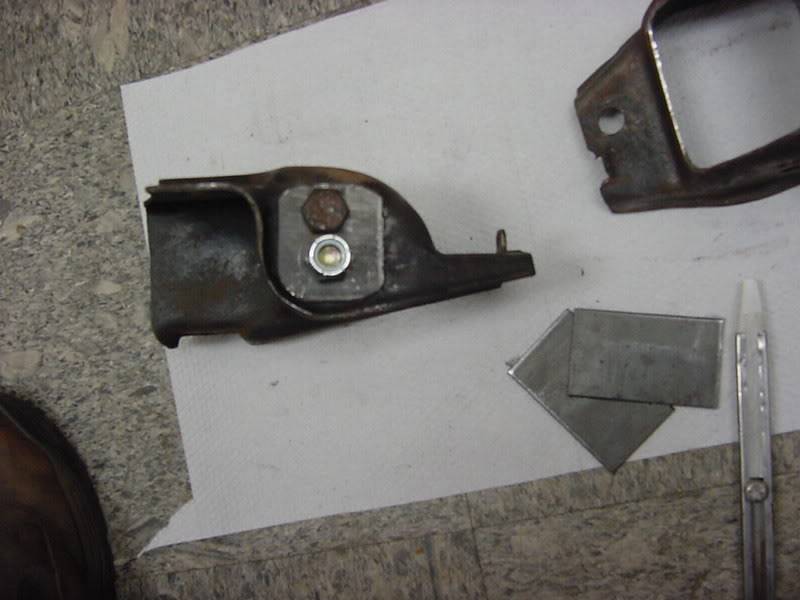

      I welded/plated the sides of my spring perches with 1/8" material, stiffens them up pretty nice.

      Inspired by fellow Forum member John Wright, I beefed up the front leaf spring hangers before mounting them back in their stock location.
      I cut three pieces, 1/8" steel, to go around the hanger. I got the curve by heating with a MAPP torch until it just began to glow, then beat it with a hammer over the anvil. I let the pieces air cool. It sure was fun getting the steel bar to match the curve of the stamped hanger. Not being sarcastic either - it was fun.
      I tacked them together on the hanger. I kept the bushing bolted into the holes to make sure they stayed lined up during welding. I took the tacked piece off and welded the inside joint. Then bolted it back on and finished the outside joint.
      Now that the three pieces were one, I welded it to the hanger 1 inch at a time on the highest setting.
      The finished pieces fit in the stock location after massaging a little more room in the frame - 1/2" up and 1/8" in - for the bolt head and nut to move up higher. Lock washers don't fit now and are not needed because the nut physically cannot come off when the hanger is in place. I'll loctite them anyway though.
