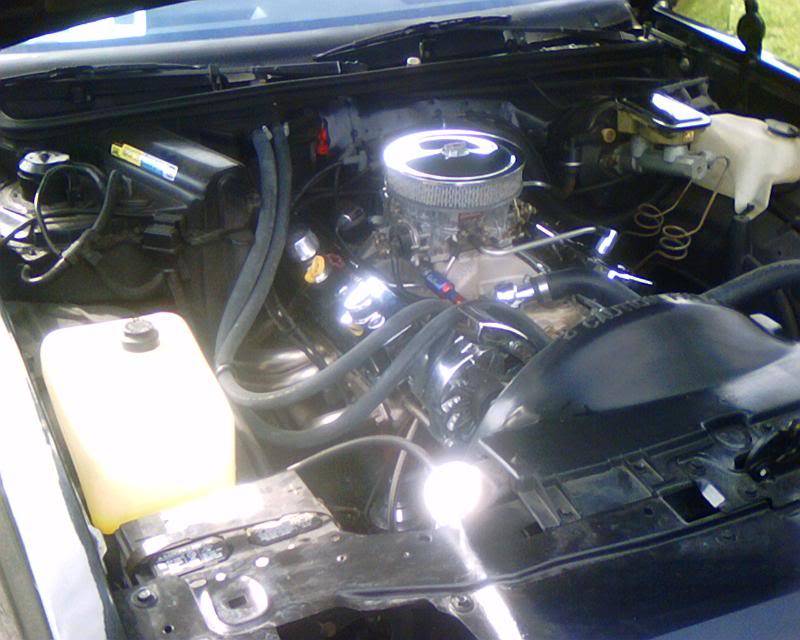

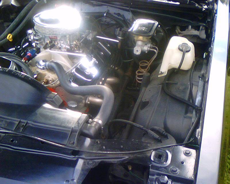

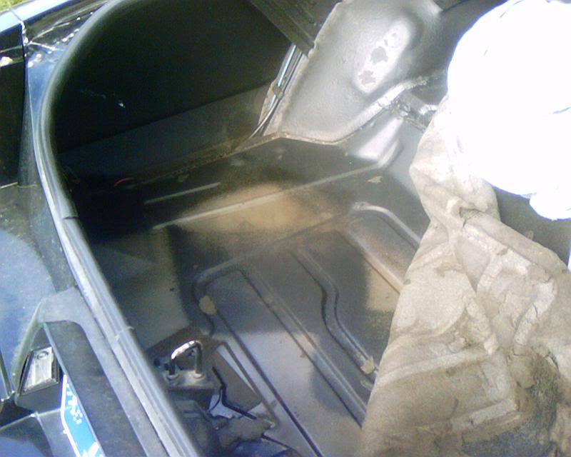

      Here are some pictures of what I am working with. Forgive me as these pictures are what the current owner sent me. My future plans are to remove the ZZ4 and plop in an 376ci carb'd LSX motor and possibly a blow through setup.
      I'll get better pictures when I pick up the car if anyone is interested.
