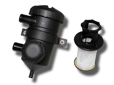

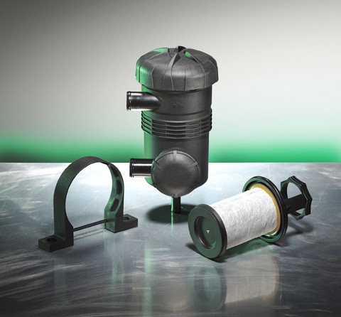

      Mann-Hummel Pro Vent. The best there is.

      The Porsche crowd uses them.
      They are not small or blingy, but they are very nicely engineered and take all of about 12 seconds to take the lid off, R&R/inspect the filter, and put the lid back on.
      http://www.928gt.com/p-40363-provent...separator.aspx
