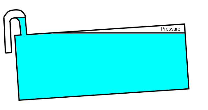

      I have an idea of what might be happening.
      When your tank is full, the fuel might go right up to the fuel return vent inlet. It is possible in this case that pressure can build up in the tank and push fuel out of the vent tube
      That's my theory.

      Dang Sean, diagram with the answer! Couldn't ask for more! I think your right. With the tank pressed up full the vent outlet is in contact with the gas allowing contact and a siphoning effect. However, I thought there was a check valve in there in case if rollover? Maybe it's just enough pressure to allow fluid to go by. Drove the car a bit and with the fuel level down some, hasn't done it.

      It was easier to draw the diagram than it was to try to describe what I was thinking...
      Hope it can be helpful!
