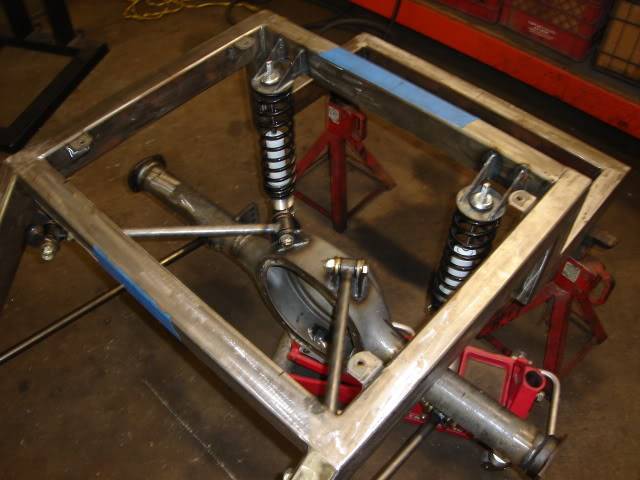

      I am new to this site and I know that there are not a whole lot of VW folks out there, but let me tell you about mine. It is a 1969 Volkswagen Squareback station wagon. The only thing VW is the body. Chassis: 2" x 3" tube with Mustang II front suspension Engine: Small block Chevy 350/330 horse Transmission: 700R4 Rear end: Narrowed 9" Ford, 4:11, triangulated 4-bar.

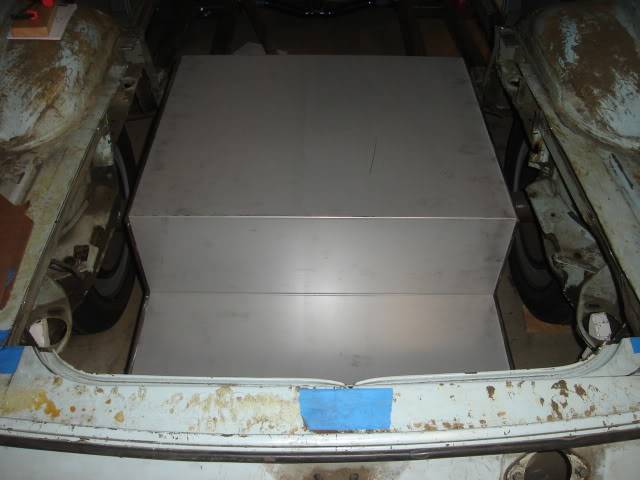

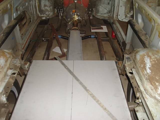

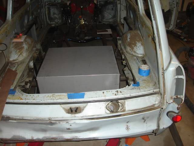

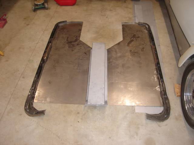

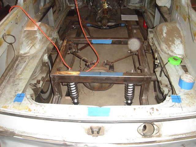

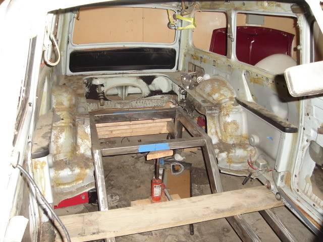

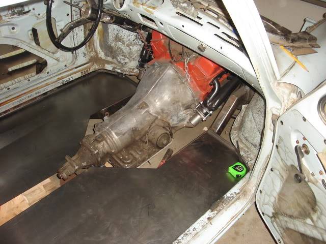

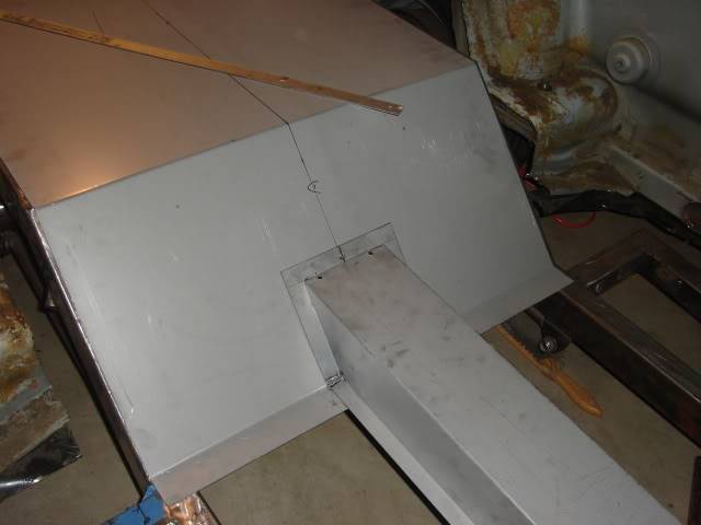

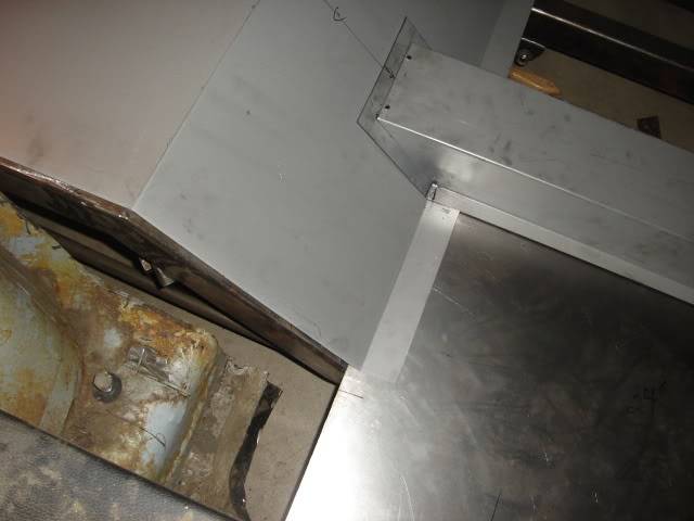

      Thanks for the replies. Here are some more pics. Look at the interior shots before and after cutting.
      Before cutting out the rear engine area.
      ...after

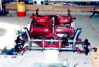

      Yeah, I think it should be a good little "grocery getter" for my wife. Here is a shot of the '69 Bug my son and I built while he was a senior in high school. It is Porsche powered. Kind of moves right along. He is now 37, lives in Chicago with his wife and 3 sons and I still have the car. Go figure.
      The chassis after we rebuilt it.

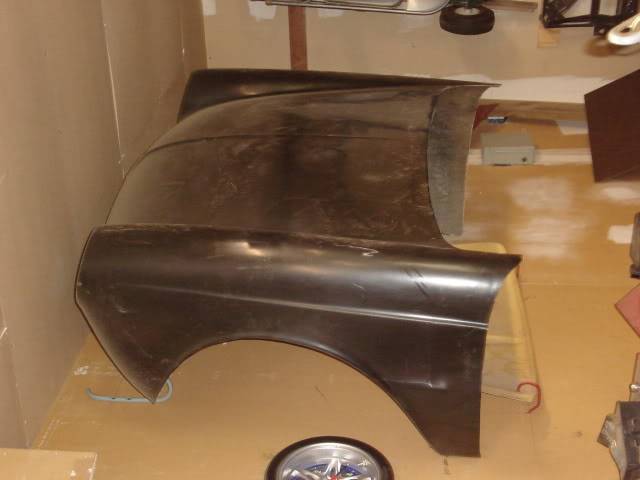

      Glass front end I will be using
