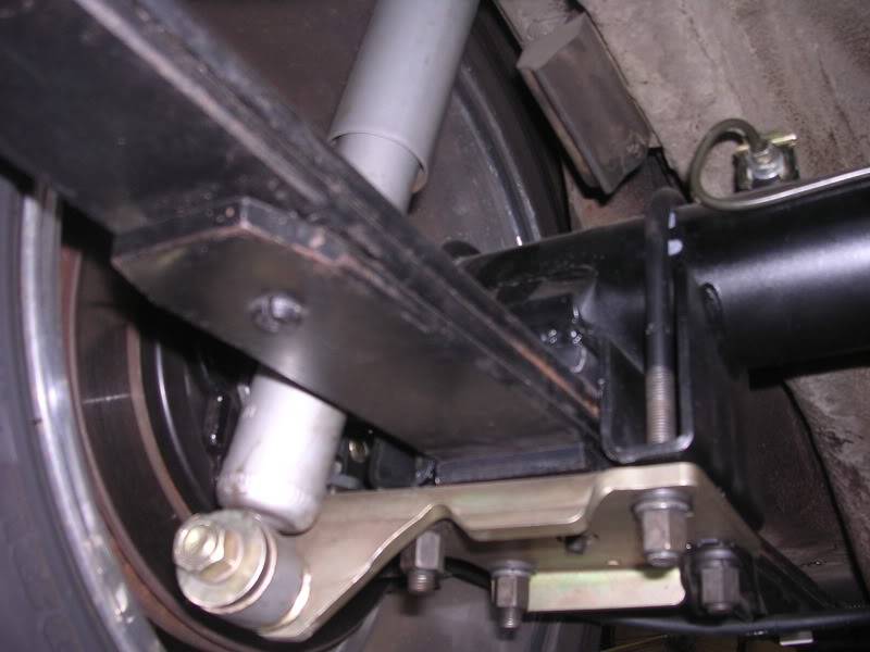

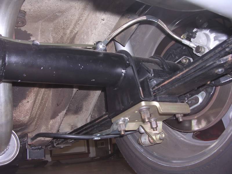

      If you are replacing drum brakes, then yes - you need to modify the hard lines on the axle. You will need to mount a bracket on the axle tubes for the hardline/flexline connection. Lots of different ways/places to mount the bracket. I welded mine, but some guys use a bracket that can be attached with a large hose clamp. Here are the best photos I have of my setup.

      Yeah it's got staggered shocks, but the rear end is an 8.5" 10 bolt out of a later Camaro or Nova (can't remember which) so it's slightly wider than stock. Calipers fit fine, which was pretty sweet, lol.
      You think JB Weld would hold the bracket? Seriously, lol. I don't have a welder so that's the best I can do, haha.
      Matt

      As much as I love JB weld, I don't think that's a good place for it. The vibrations will probably crack it off fairly quickly.

      just use a 3"-3 1/2" hose clamp Matt.

      The JB weld - as good as it is - would fail just tightening the flex line to the hard line. You can use the hose clamp style bracket, or find a buddy with a 120V mig who can come over and weld it for you. It's a simple job. http://www.kore3.com/proddetail.php?prod=10021-02

      Awesome, thanks for the link. I'll just use those, then.
