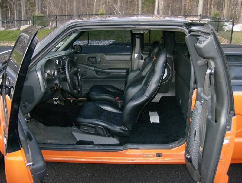

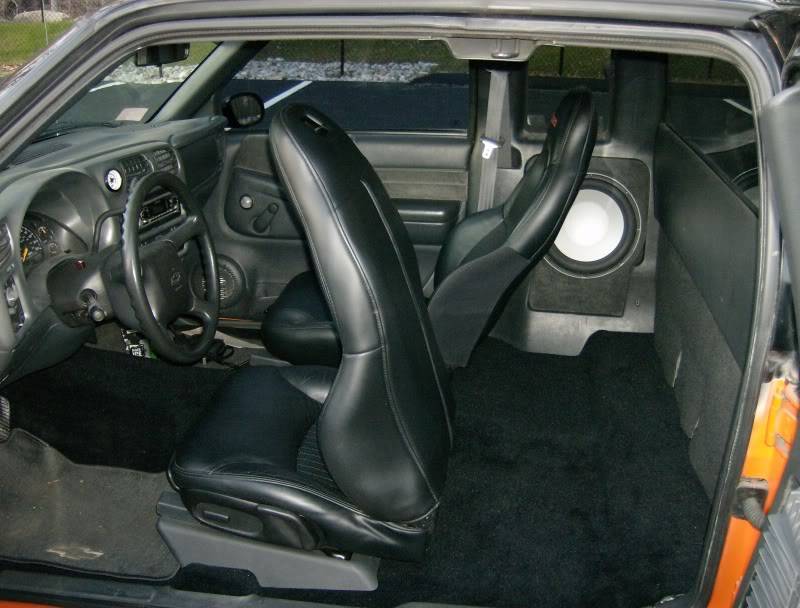

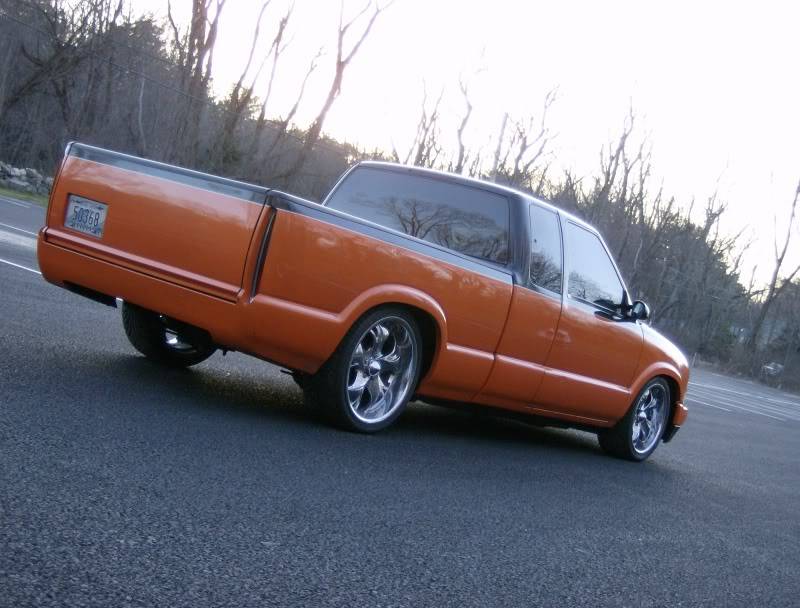

      Ok here it goes, front has stock zq8 springs, stock lower arms with delrin bushings, blazer 2wd drop spindles, zq8 sway bar, c5 brakes, 18x8 with 245/40-18 tires, vari-shocks s1, sc+c stage 2 plus. The rear has stock zq8 leafs, replacement bilsteins, c5 brakes, 3.42 posi, and stock rear bar. Hopefully this weekend I'll have the poly rear leaf spring bushings in and its done for now (until I get my ls1...) Also I re-did my interior with 02 zo6 seats, moulded my dash bezel, custom sub box and black carpet.

      These pics show the front with bilstiens, for some reason they weren't stiff enough to keep the tire from hitting the wheel well when I hit a bump so I had to get the vari-shocks. I'm at 10 clicks.
