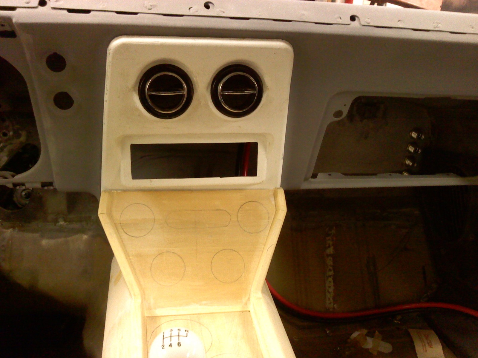

      How does this strike you?
      Name:  Center dash Consol.jpg
      Mike South
      1968 Camaro SS/RS LS1/T56
      Ride Tech Tru Turn, Ride Tech T/Q Coil-overs
      Ride Tech 4-link
