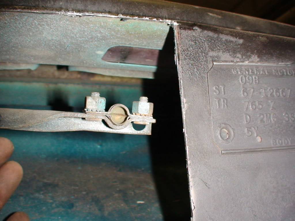

      you can cut and weld 3/8" threaded rod (one left handed) to your old linkage ends and use http://colemanracing.com/store/shopexd.asp?id=892 to connect the two.

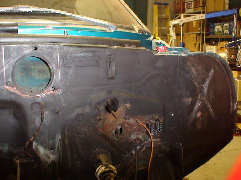

      Just cut out your old mounting ring and re weld it behind the fenders where the X is located. This is what I did a few years ago.
      Then cut the end of the rod off and extend it over to your new location. It's pretty easy. Then use a piece of metal to patch your open hold with.
