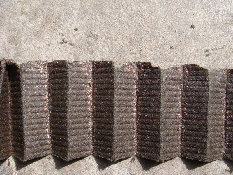

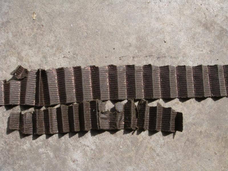

      Drained the oil and pulled the filter and opened it up. Oh my god
      Sent these pics to my builder. He thinks that the mech advance failure may have had its effect on the timing and may have taken out the bearing on the mains. I am pulling the motor and he is going to examine the whole engine and determine ther amount of damage.....

      If the timing was retarding itself everytime you re-checked it then that probably wasn't causing your your bearing problem but if it was advancing itself a bunch that would have caused detonation which would have hammered the bearings (usually the rod bearings) did the flutter that you mentioned sound like detonation (pinging)? if so that is what probably caused the bearing failure. As the bearings start to fail you will lose oil pressure because bearing clearance is increasing. To answer the main question the failure probably was caused by distributor.
