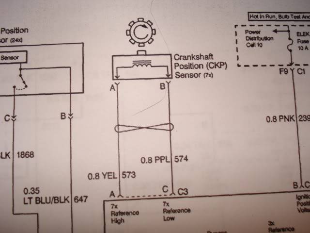

      The little circle loop between the a and b wire what does this mean? I have a problem with my wifes van and I think i found the problem but the loop thing is throwing me off.

      never mind it just means the wire is twisted

      (twisted) for shielding

      twisted pair for attenuation in a single jacket. If it were shielded there would be a line coming off it to ground.
