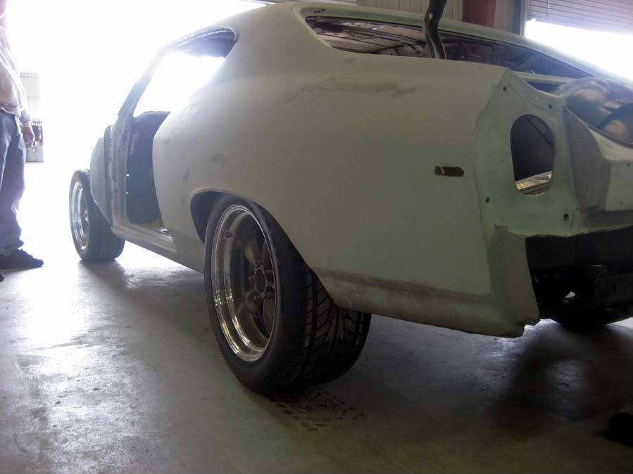

      I have C5 wheels on my 69 chevelle using a 2 inch spacer front and rear. I will be using a 275/40/17 on the front and a 285/35 on the rear. The rear has room for more tire could probably run a 305 with no problem and a 315 by rolling the quarter lip. The front is about as big as will fit. The fronts are 17 x 8.5 with the spacer it makes them have 5 in back space. The rears are 18x 9.5 with the spacer they have 5.5 inches of backspace. Best pic I currently have

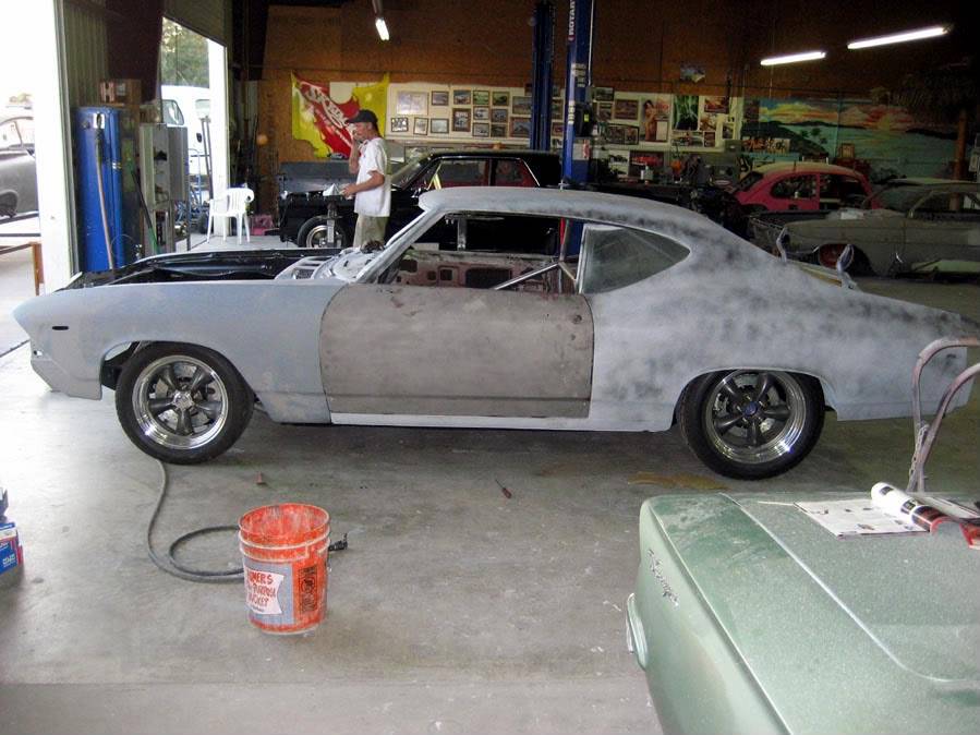

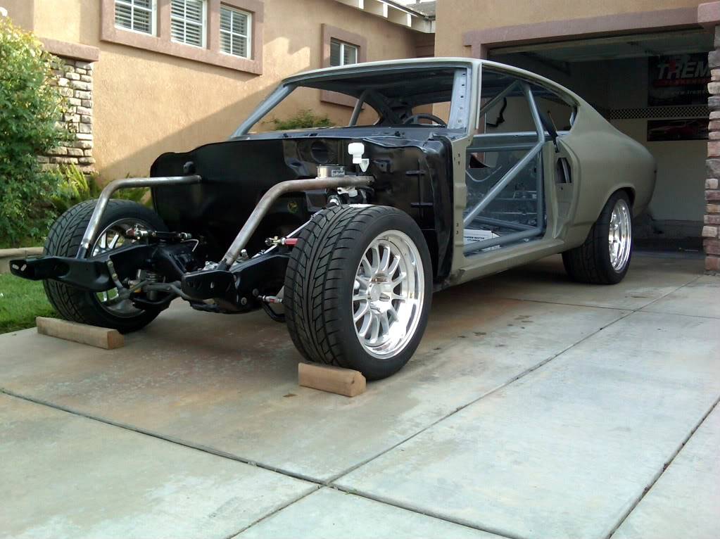

      Front: 18" x 9.5" , 275/40/18 tire, Rear: 18" x 11", 6.25" BS, 305/35/18
      Front: 17 x 8" 4.75" BS, 255/45/17 tire, Rear: 18" x 10", 6" BS, 295/45/18

      No tubs but I did roll the fender lips although I don't think you really need to for 305 or 295 size. I know there are others running 315 tires with no tubs. There is a member here I think by the name gmorris with a really nice chevelle but I can't remember what size tires he had.
