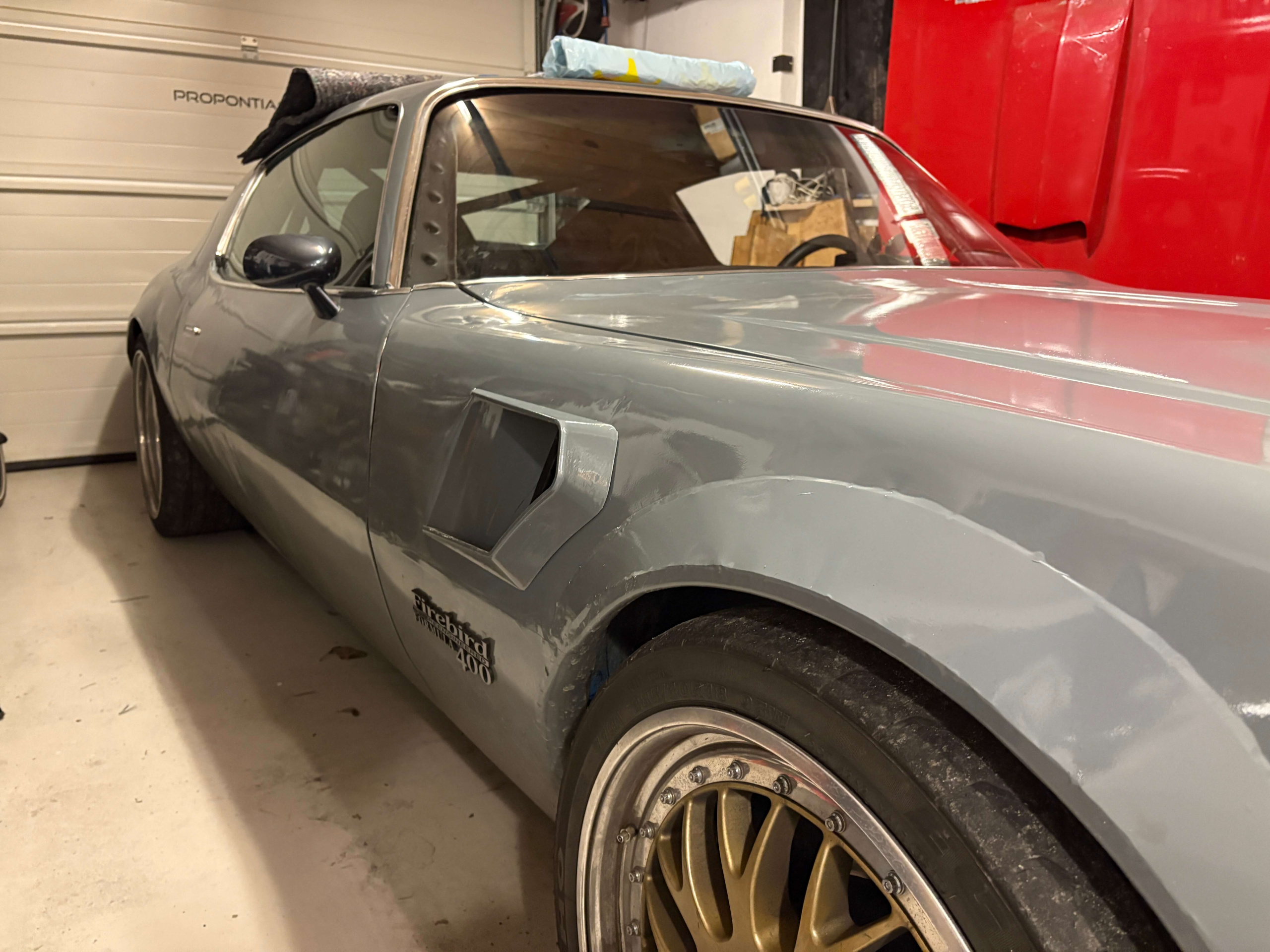

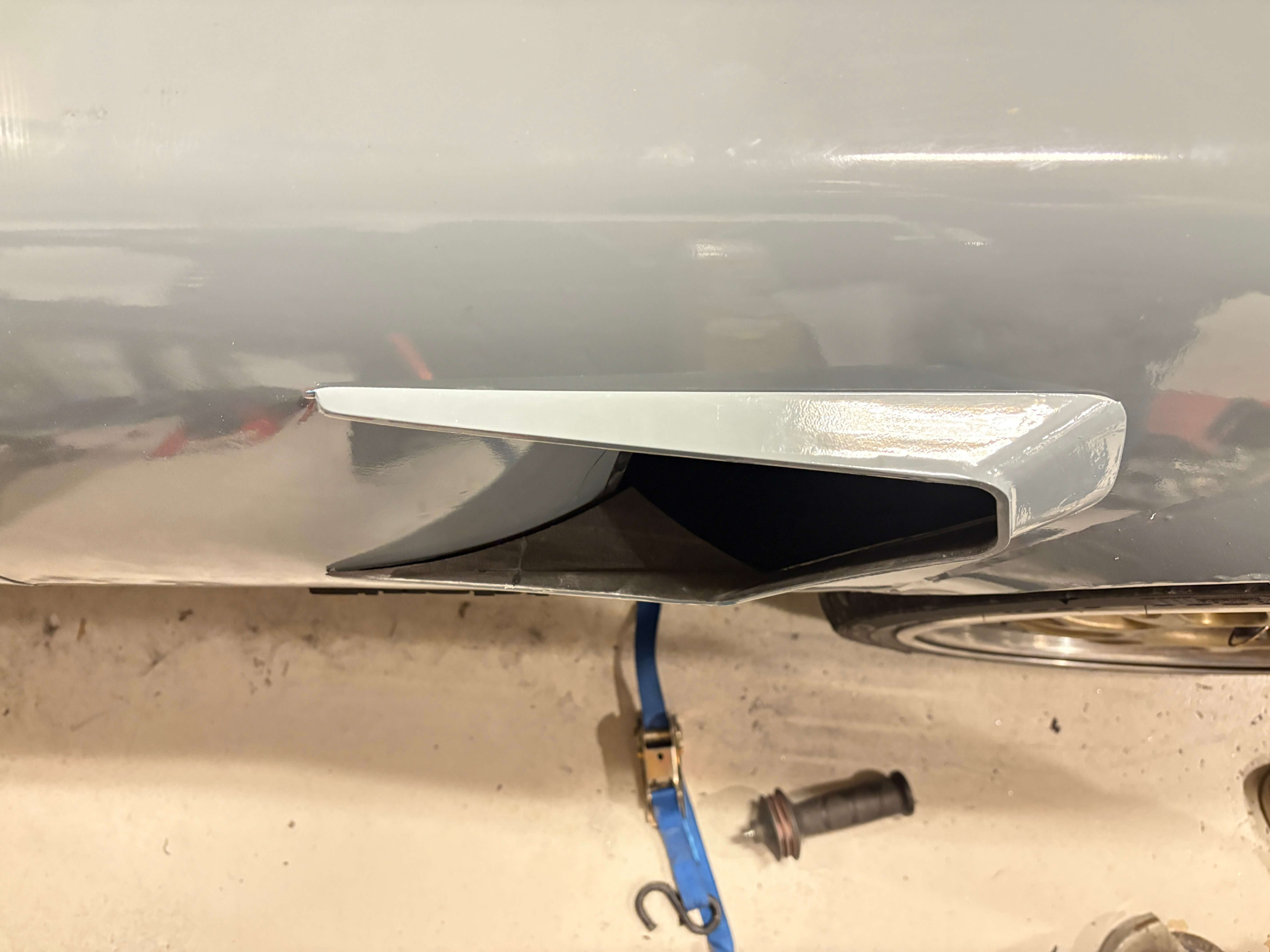

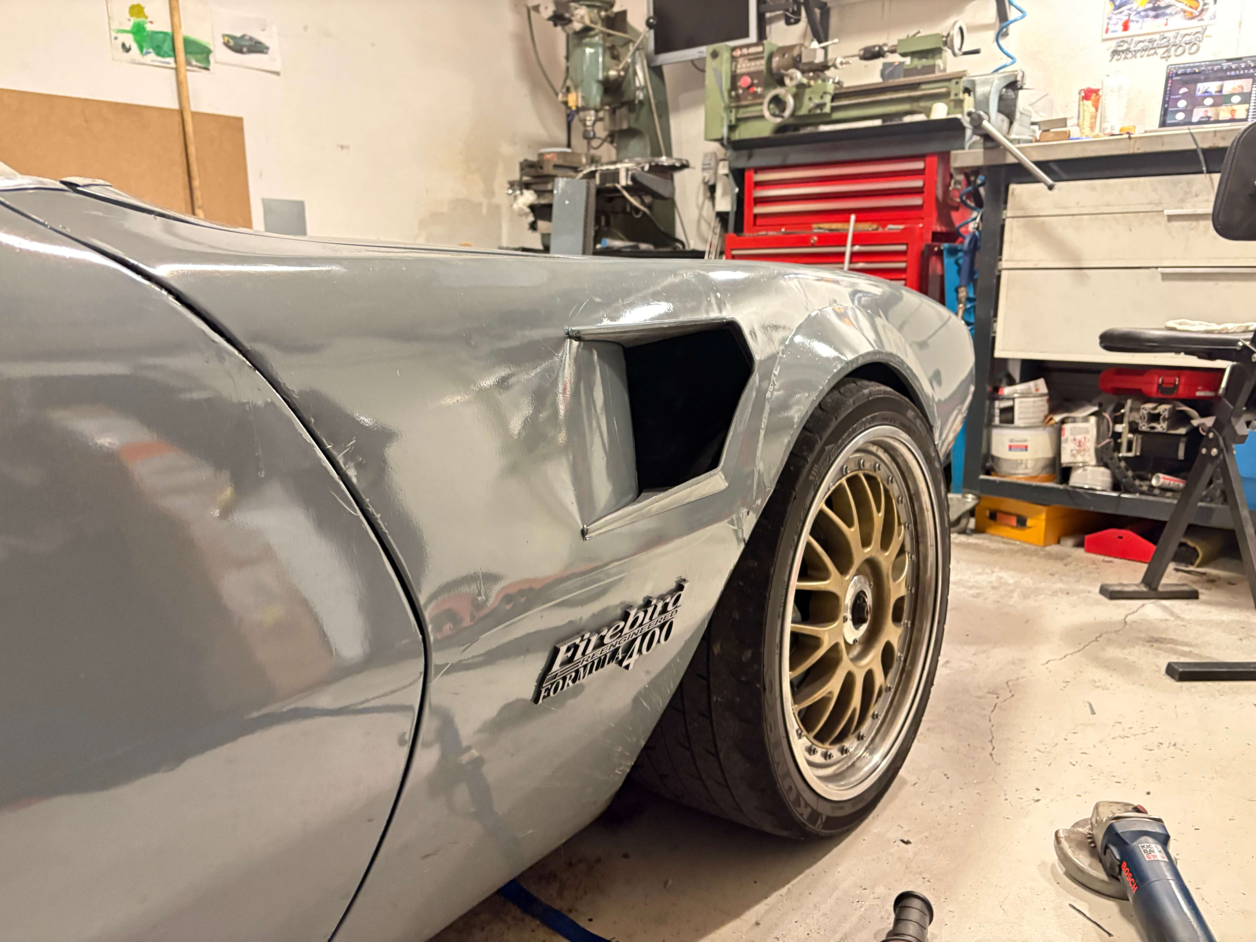

      Needed some air extraction from engine bay

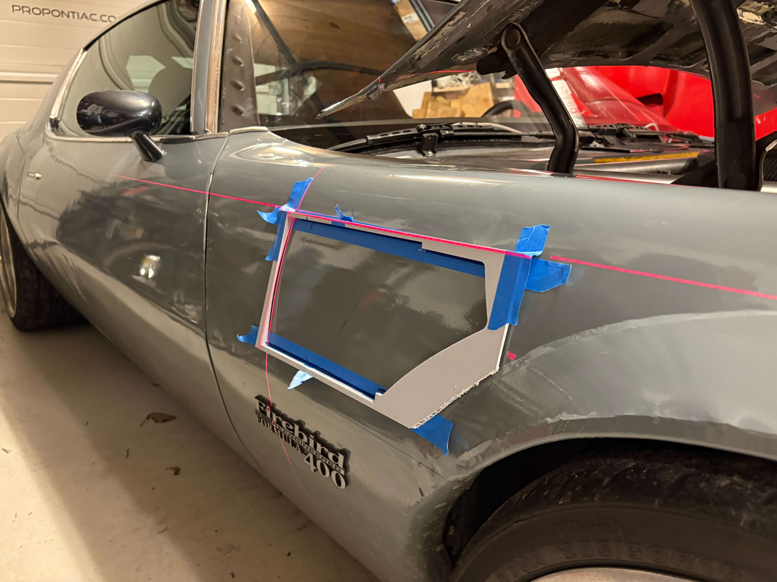

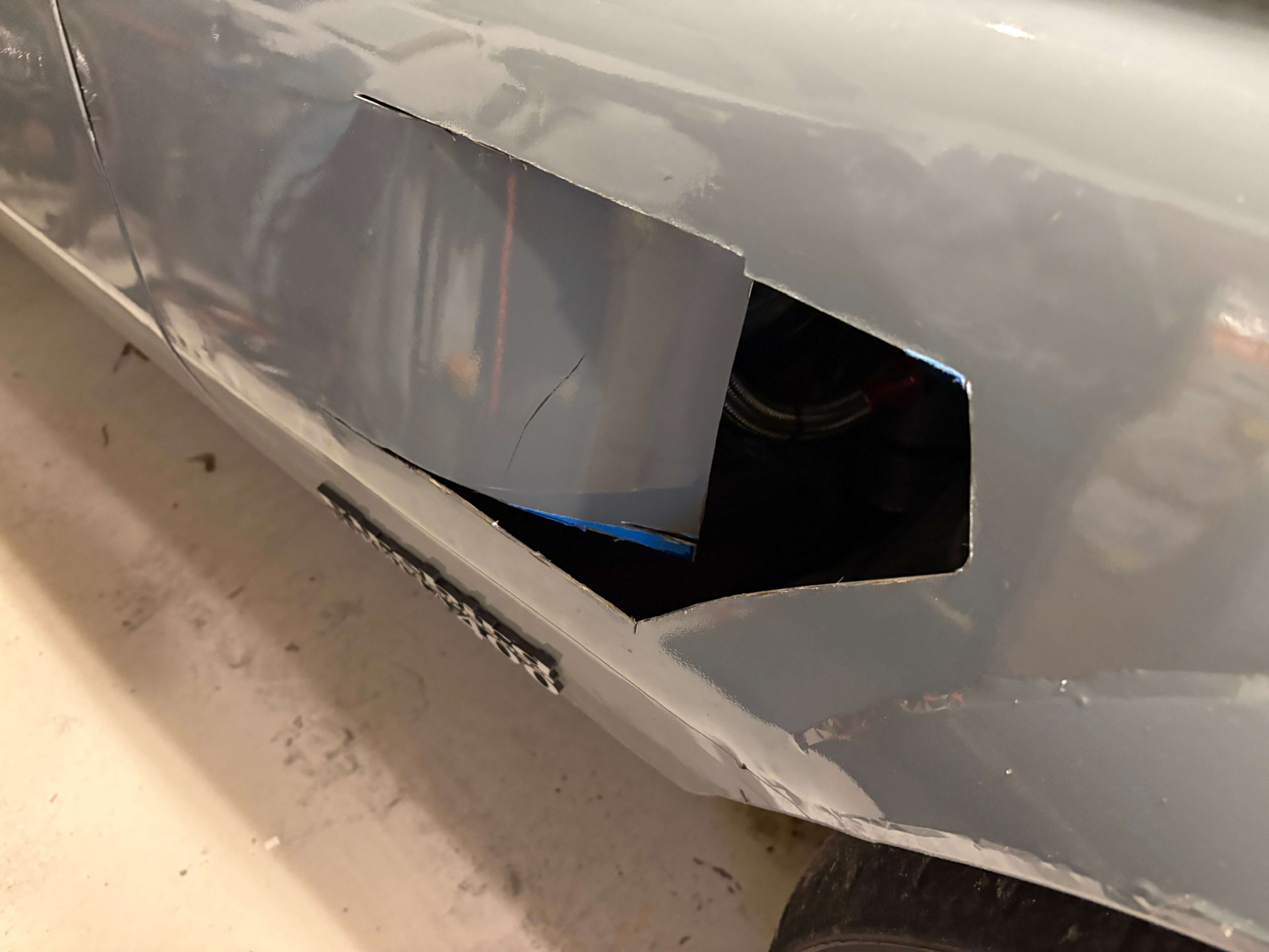

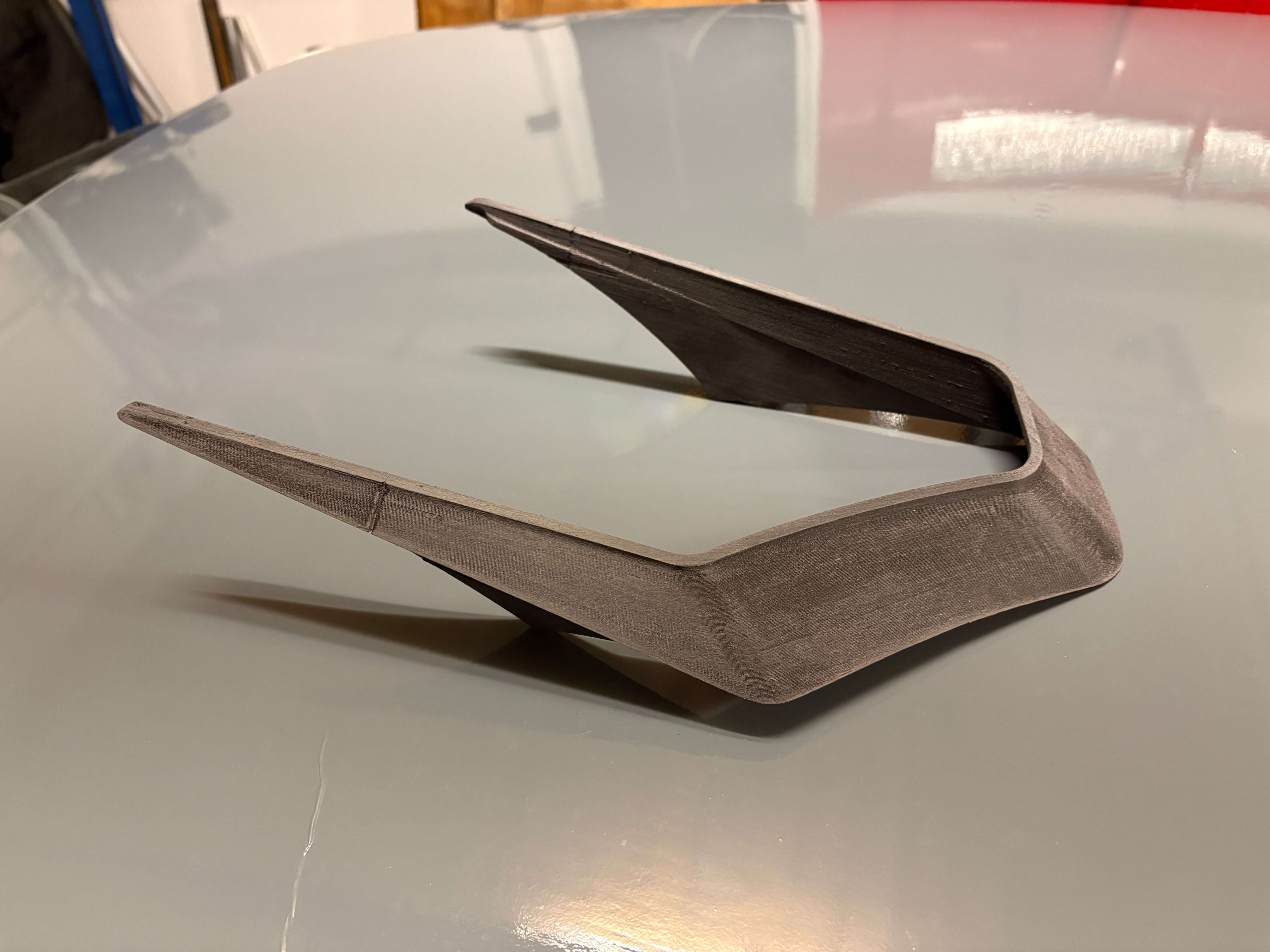

      Stock Trans am extraction looks good. Didn't find any used, and didn't have the patience to try to adapt them. Needed something quick to see if it made a change since it's only one week left on driving season here...
      So I printed something similar...

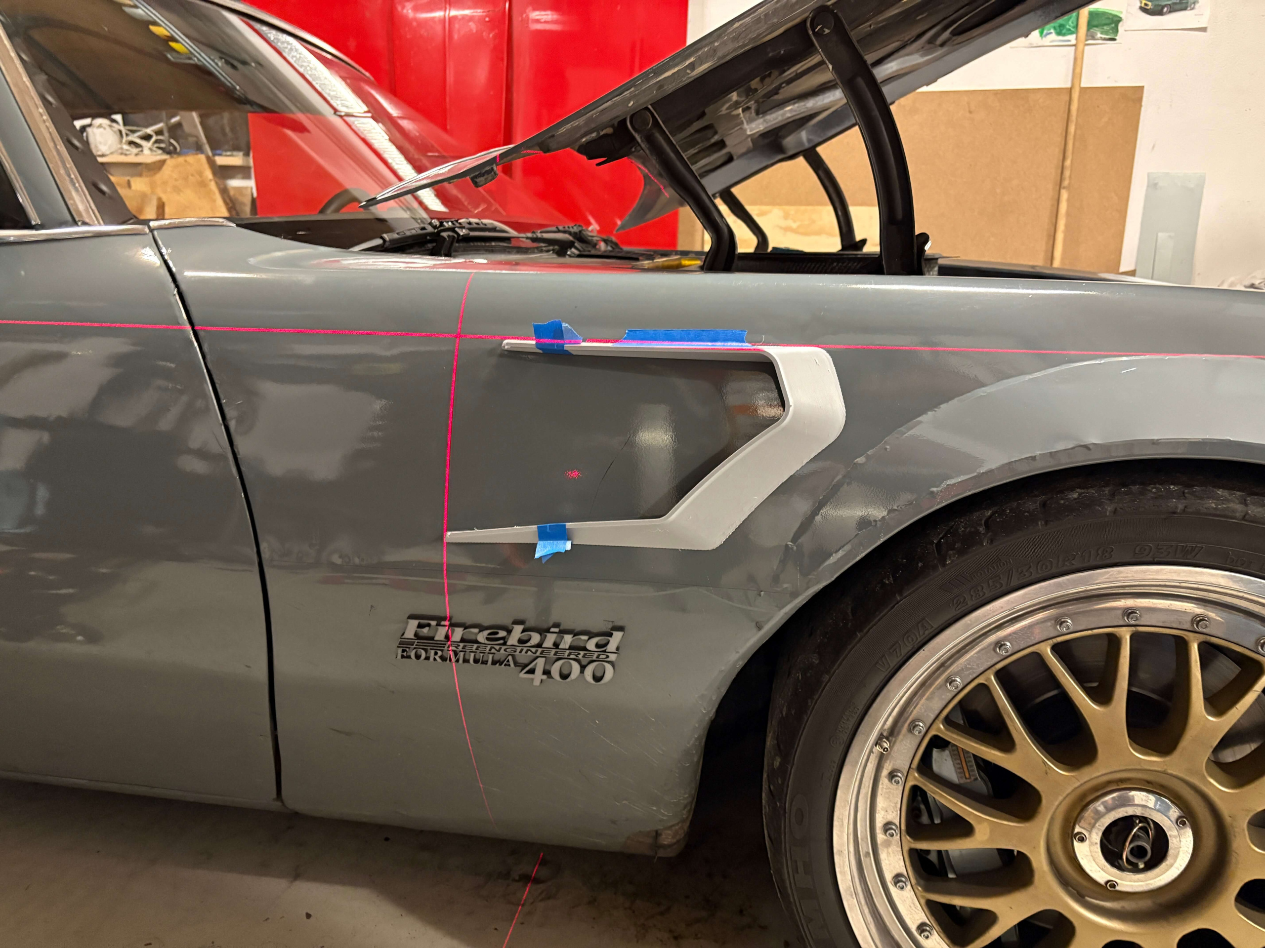

      But first, print a prototype and position it
      Then print a guide for cutting
      As I said... quick.

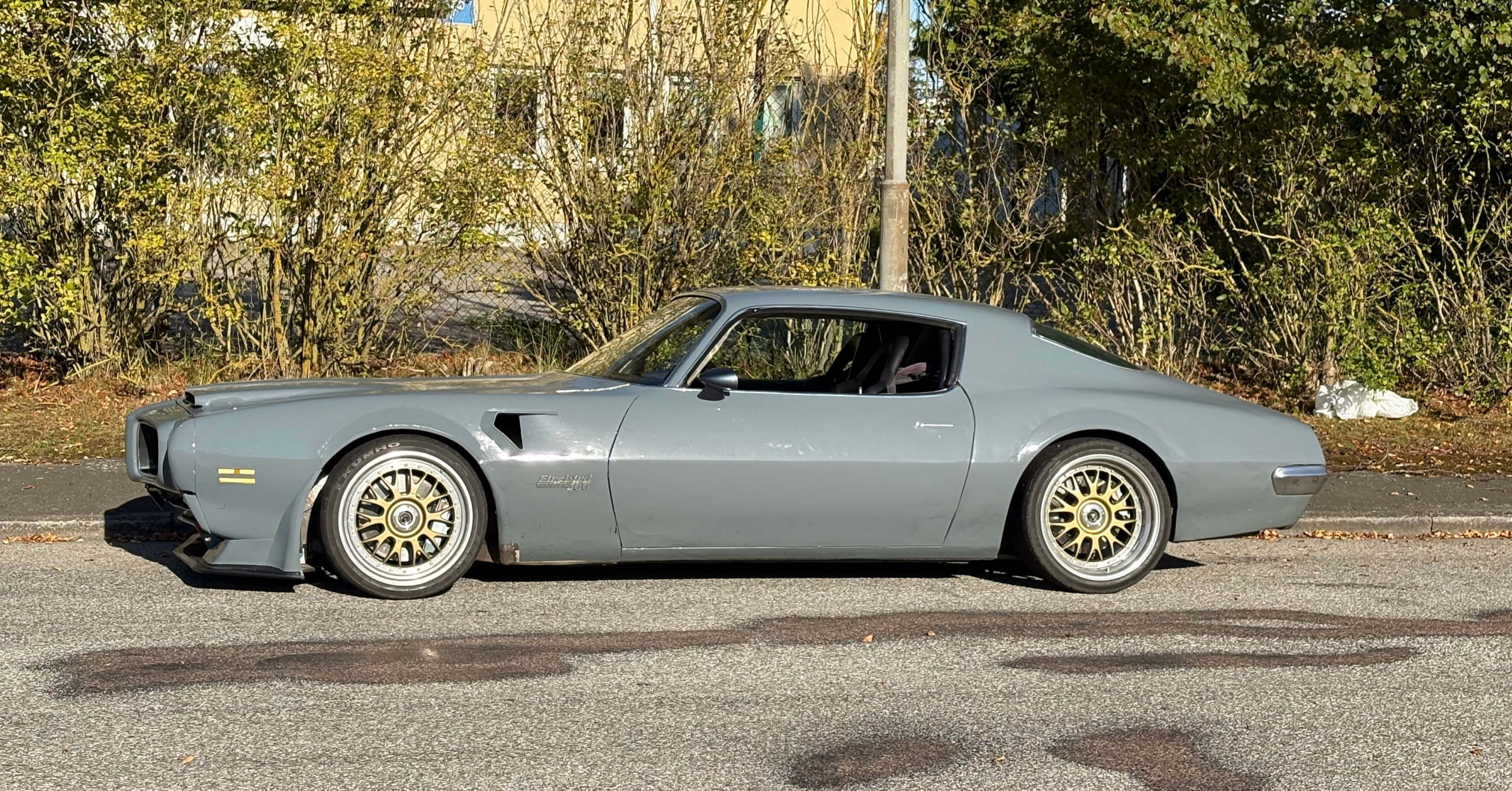

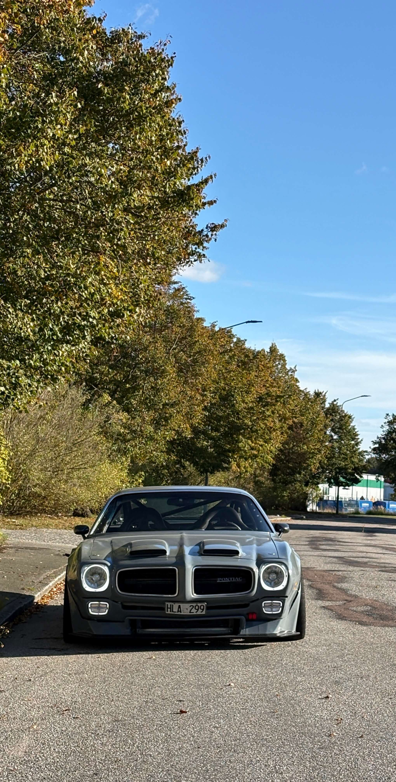

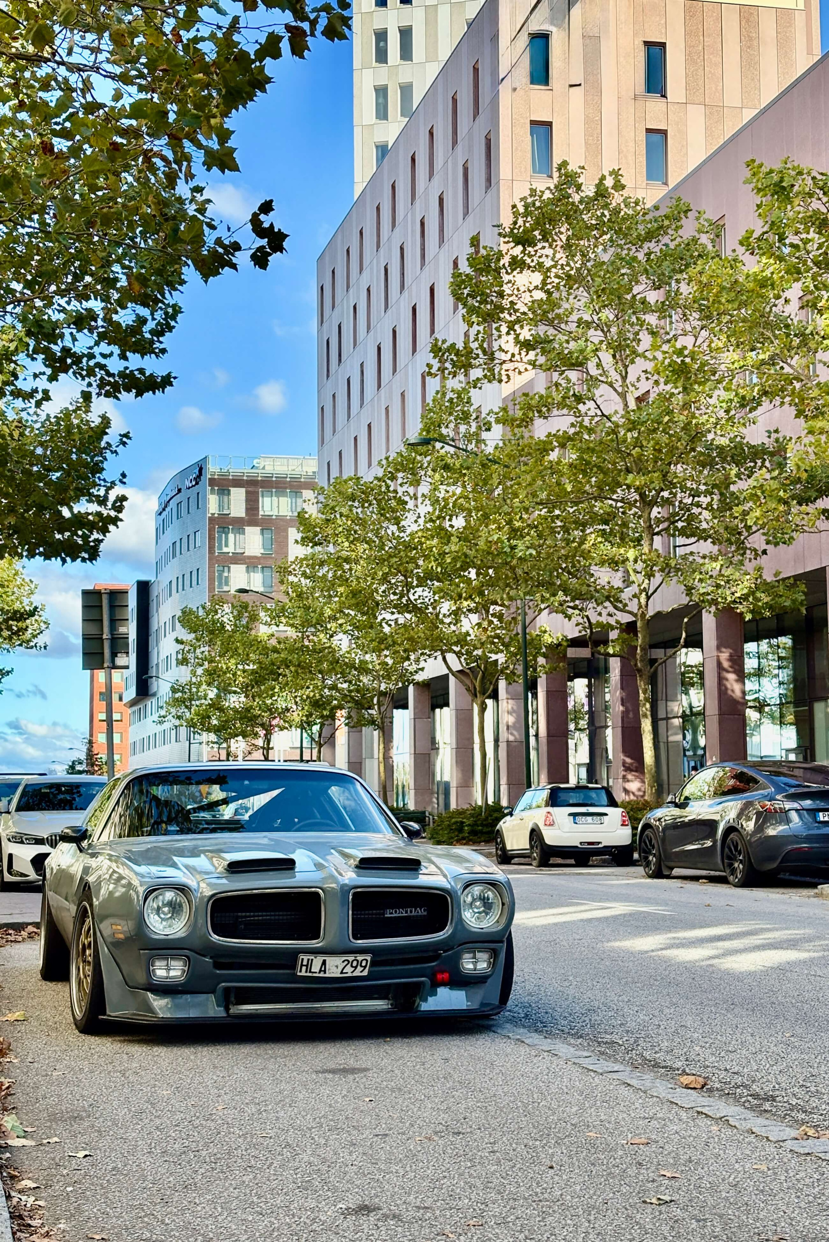

      Last drive for the season! Winter season starts now...
      Didn't have time for more than a job commute, but at least the weather was with me
      Sep 2009
      2,996
      Looks killer man! Did the fender modifications help with lowering temps?
      Aug 2002
      Sweden
      910
      Country Flag: Sweden
      it seems to have helped a bit. Of course it was slightly colder in september than in august. Nevertheless it runs a lot cooler in lower speeds than before so I guess it has helped some.
