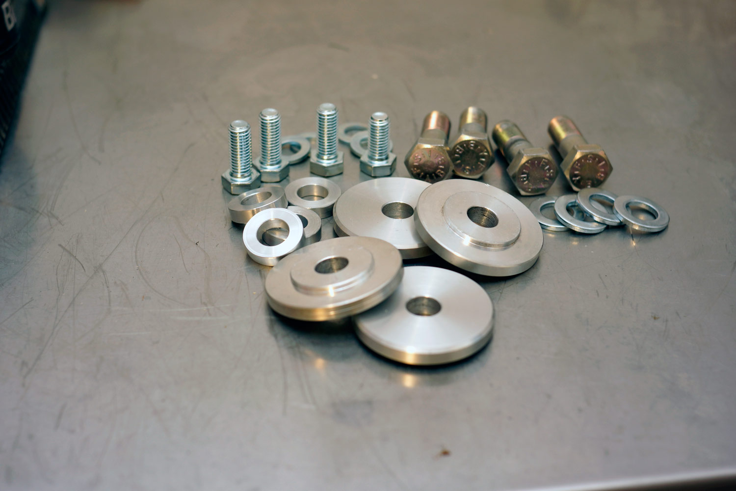

      Quote Originally Posted by AMPZ28 View Post
      In my quest for lowering my camaro I seen your post. If I may ask. on the solid bushings you made there is a machined area to center the bushing in the frame hole and then its bolted in without a bushing on the topside (between the frame and body) is that correct? Thanks
      Yes, correct!
      You'll gonna have to cut the top of the frame too if you want it to sit close to the body. No clue how it works in the front though, since I don't have the stock radiator support

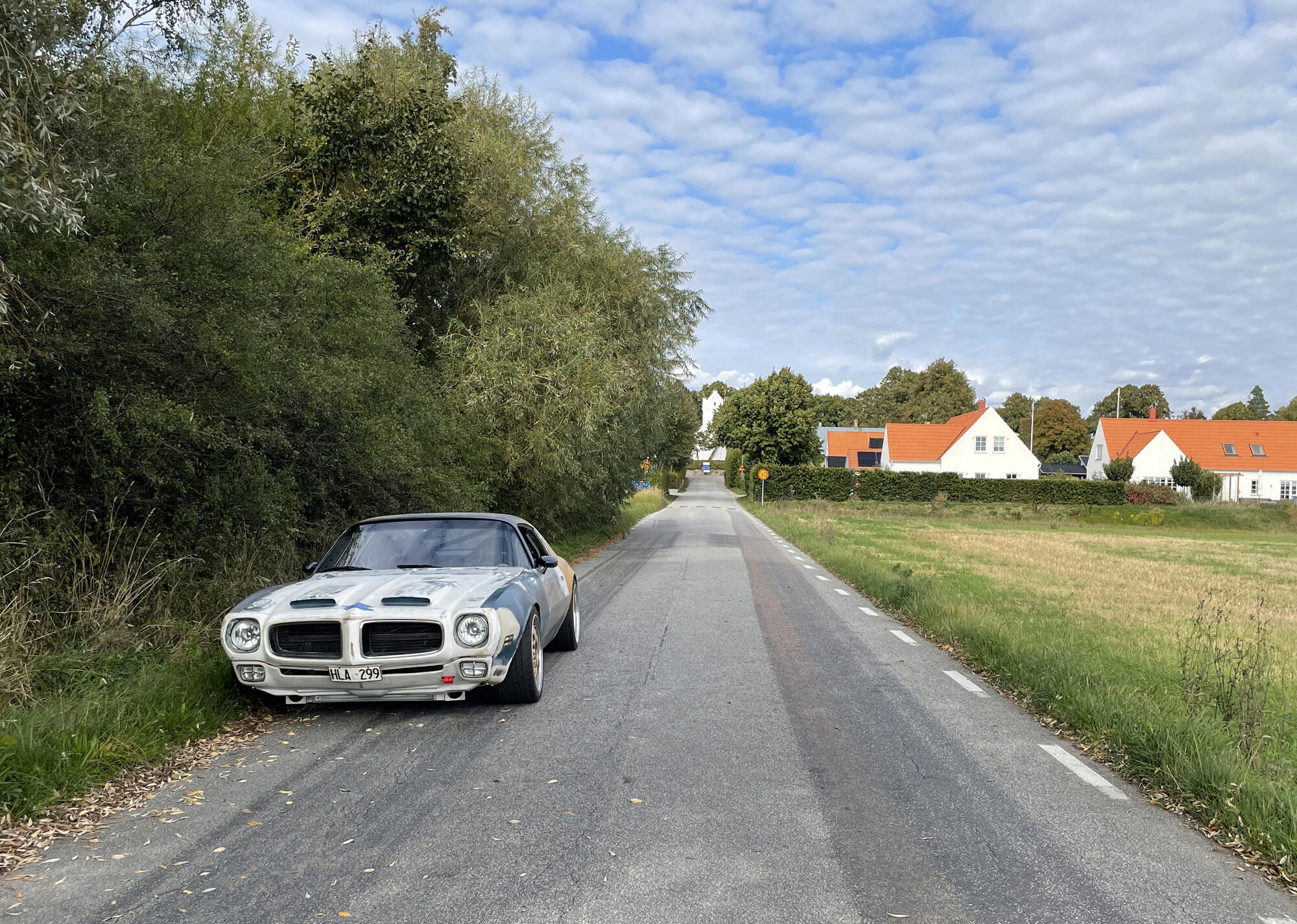

      Yes! I've been out driving!
      Two weeks ago, I was able of taking it for a longer drive, sorting out some stuff and updating the to-do list for the winter. Snow arrived the day after my test drive, so it was literally the last chance before winter.
      It's definitely not dialed in yet. No sway bars, and springs coefficients are just what I had laying around when i built it. But handling is already great! (Or to be honest, as great as you can explore on a public road with a fresh build…)
Steering is direct (2.1 turns, lock to lock) and the adjustable electric assist is already over expectation. A small play somewhere in the linkage which prevents it from being perfect, but that must be addressed this winter.
      And it brakes! It brakes d*mn well, even though pads and rotors aren’t even bedded yet. I measured 1.05G with cold tires from 70-0mph which is way over expectation. One part of that is probably the 295 front tires. But still - cold tires, new brakes, cold asphalt. It can only get better from here!
      Entire engine compartment is covered with brake dust after the balance bar has been dialed in, so inner fenders are high up on the priority list too.
      There’s a ton of minor things to solve this winter and except for that, I’ll be focusing at building a temporary interior (because it’s like sitting inside a drum right now) and fix as many small issues as possible. Other than that, I’m looking forward to start the final steps of making it road legal during summer -23.
      A huge huge huge milestone, considering this project started in may 2009.
