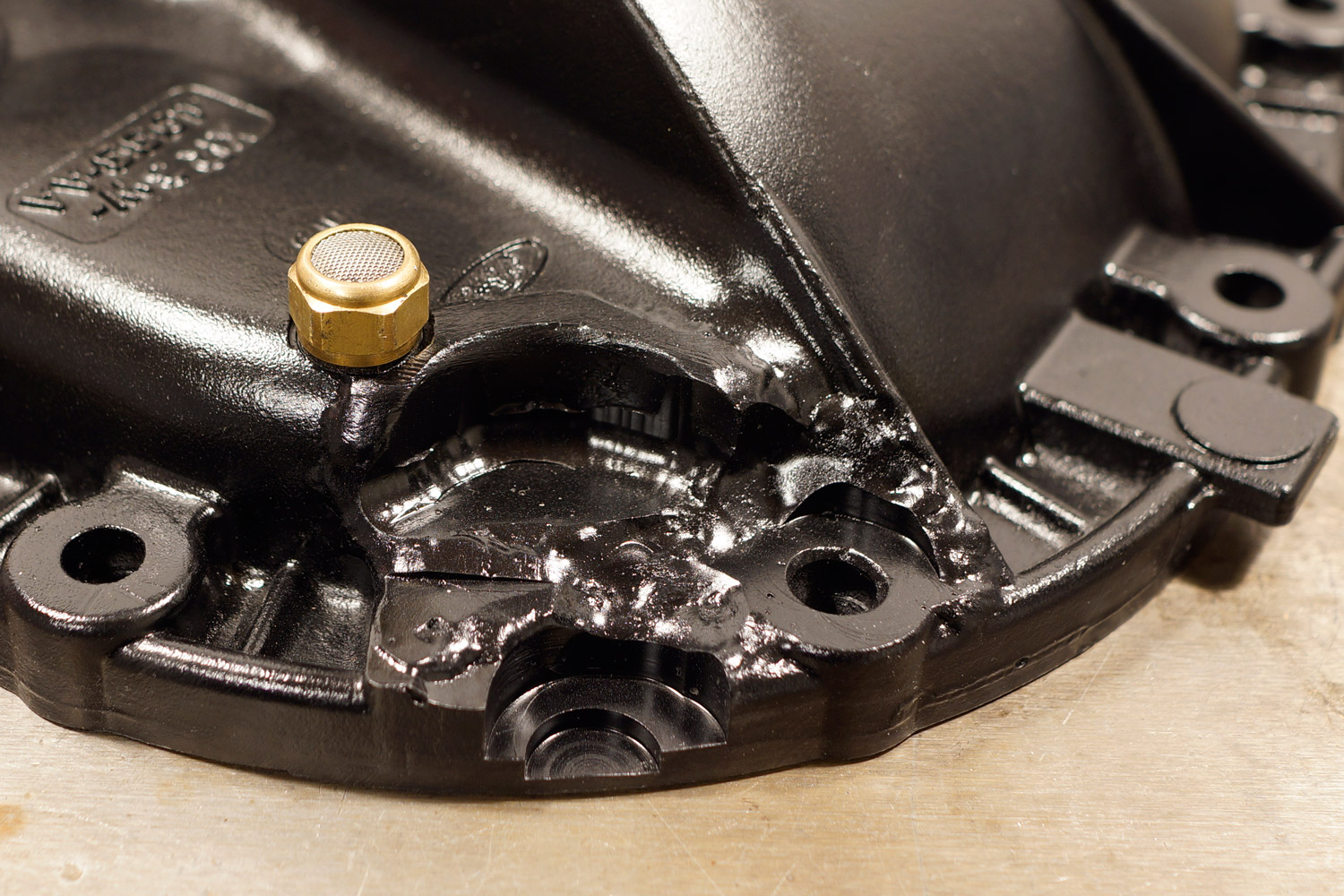

      I had to adjust the housing to allow clearance for the dedione. It's aluminum but it looked like sh*t, so I painted it black instead.
      Not exactly the best looking job, but it'll do. I had to move the original breather, but I managed to keep the new one behind the cover plate.
      Mounted. I hope I'll never have to take it down again! Heavy and really hard to fit it.
      And here's with the dedione in the correct position.

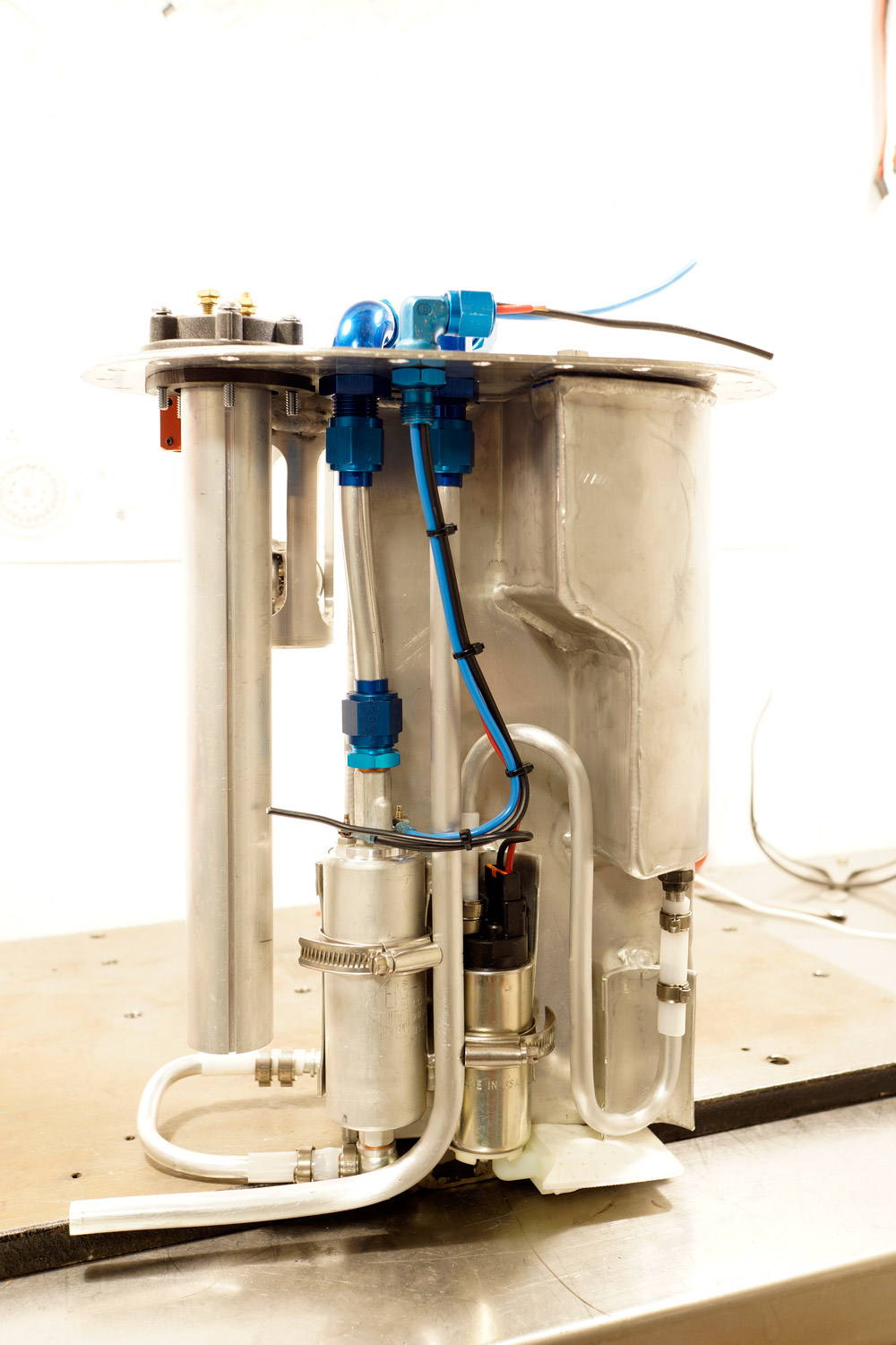

      Here's my internal catch tank for my ATL 22gal cell. Internal pumps, roll over valve and a (too short) fuel level sender. The one that was long enough costed like 300 USD. The complete catch tank in the picture costed like 250 USD total, so I felt that was slightly out of budget. I guess I'll try to lengthen the one I have when the car is finished.
      Generation 1 and 2 of the fuel filter mount. I tried to squeeze it inside the ATL-cell, but I had to shrink the catch tank too much so it ended up outside instead.
