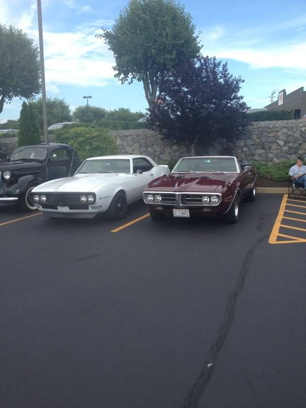

      Plasti dipped my rims black last night and finally got to a small cruise night tonight.

    20. #380
      Aug 2011
      Connecticut
      925
      That should be my car it's next too :-/
