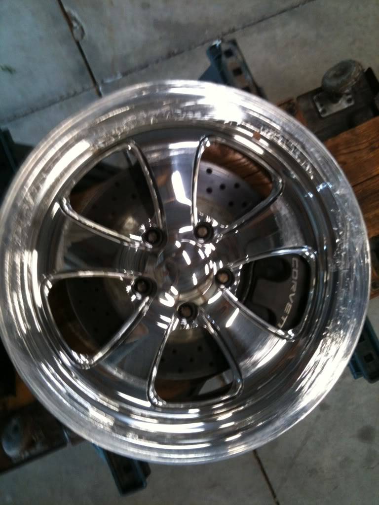

      I have been looking to upgrade the wheels and brakes on my '69 Camaro and it has been hard to piece together a pair that I like. I am starting this thread as a fit guide that simply lists the rims known to fit with the C5/C6 brakes. Ideally you know they fit because you own them or you have some first hand experience with the fitment. Please list the specs of the rim and anything you had to do to modify the fit, for example wheel spacers. Pictures never hurt either Thanks! Hope this guide helps others too.

      Billet Specialties Street Lite 17, C5 325mm Rotors, C6 calipers.
      Will not fit without a 1/4" spacer, minimum.

      Hey dan great post to start it off. Thanks for the detailed picture too, very helpful to all us looking for a new rim/brake setup

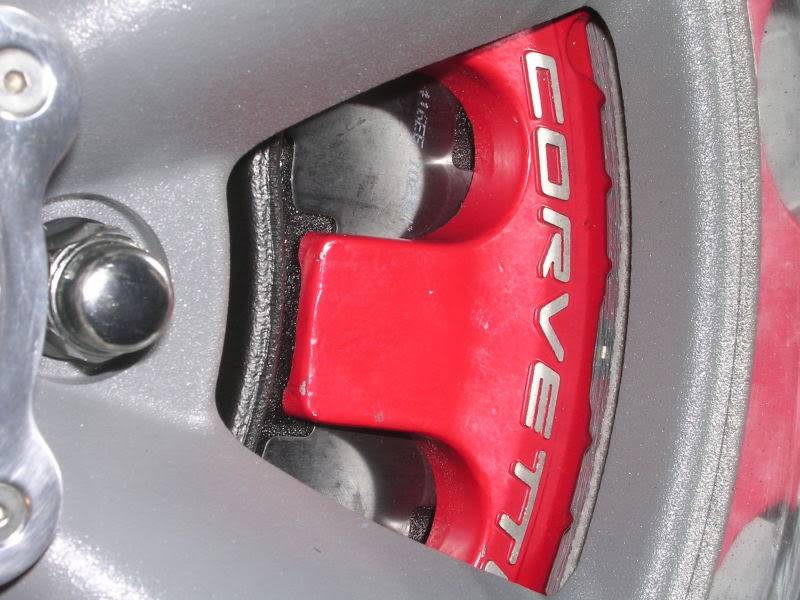

      I don't think they make them any more, but I had no clearance issues with ROH snypers (17x8 front, 17x9 rear) with he c5 brakes. This year I changed to the c6-z06 stuff and believe it or not they just fit. (14" rotor/caliper) The big thing to look for is a rim with a lot of spoke offset to get the clearance on the caliper. (pardon the water spots in the pic...) -Dan
