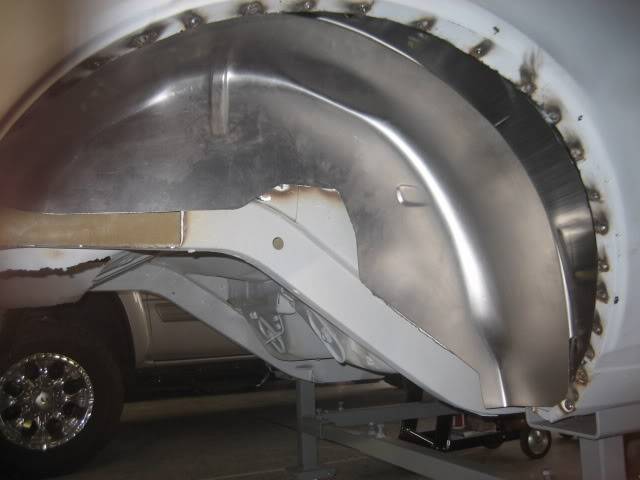

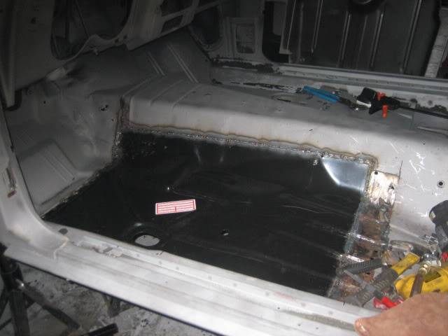

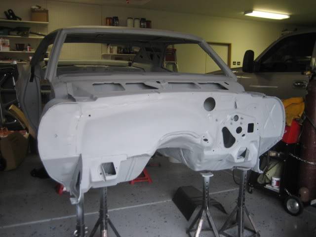

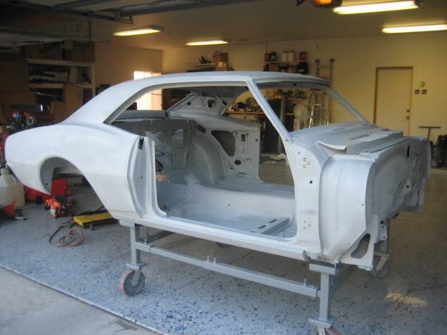

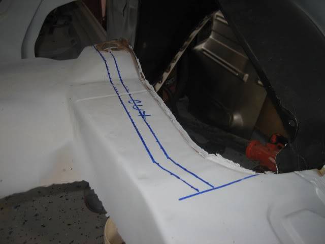

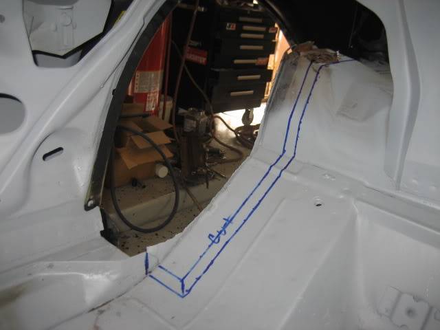

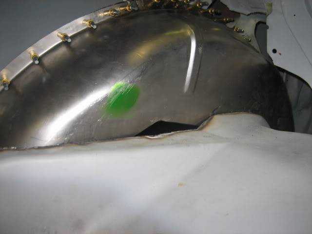

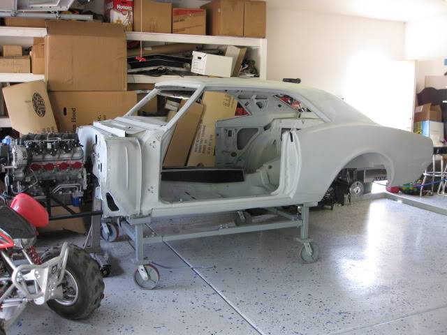

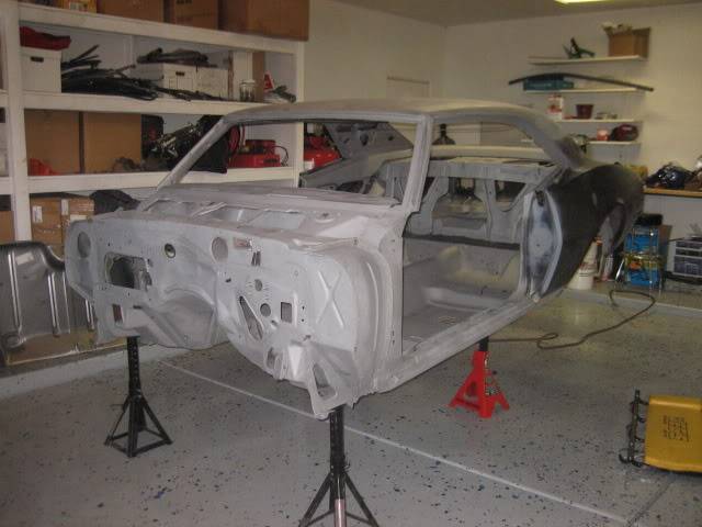

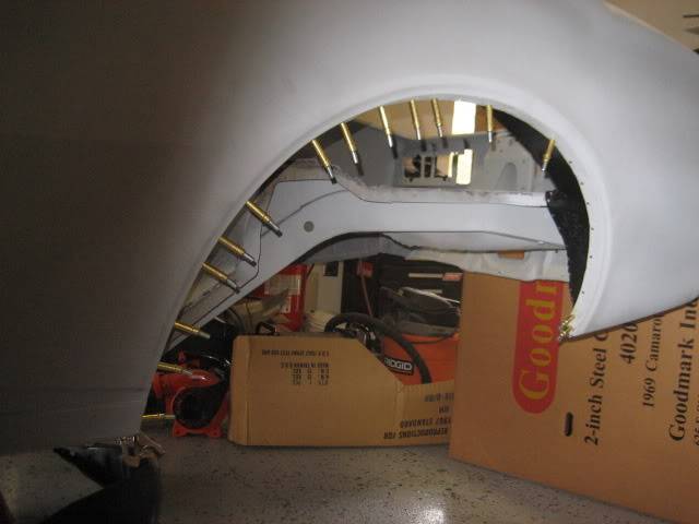

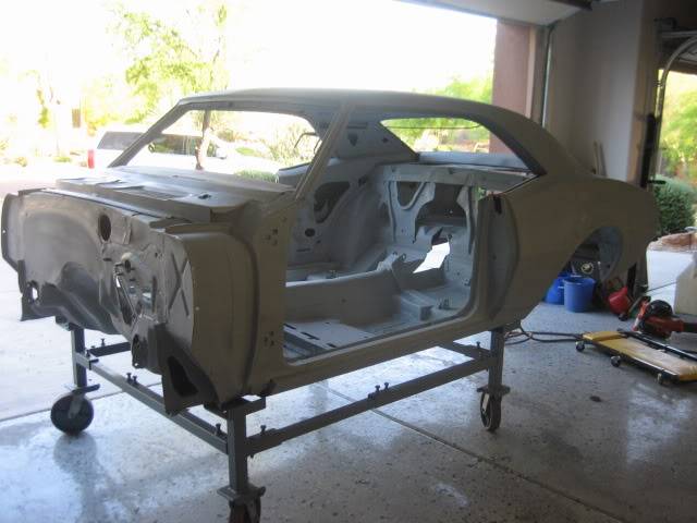

      My build plans. So far I've had her media blasted with crushed glass, filled the firewall with 18 gauge plate, sprayed it with dtm primer, repaired the drivers side floor with a patch panel, replaced outer wheel wells, dse tubs and a new trunk pan.

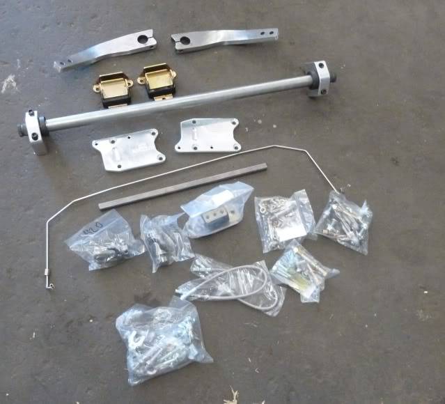

      I just picked up a Lateral Dynamics rear suspension from a board member and a LS7 with everything but an ecu. My next big purchase will be a AM front subframe and a TKO 600. I'll update with pics as the build moves along.
      I've done all of this since early February when I found a set of DSE tubs for $375 in phoenix craigslist.
      Thanks for looking!

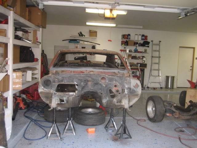

      Here she is in her un restored glory.
      After Blasting.

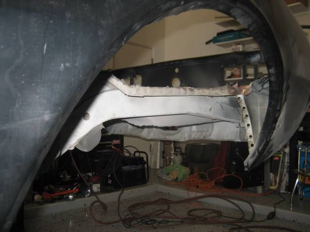

      Rear tubs out.

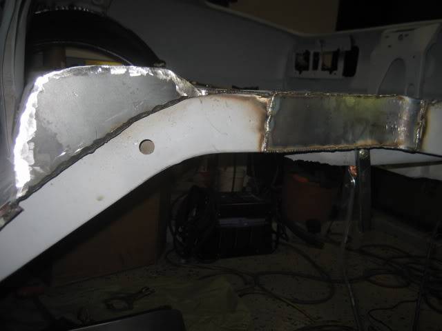

      Thank god for plasma cutters.
      New floor pan.

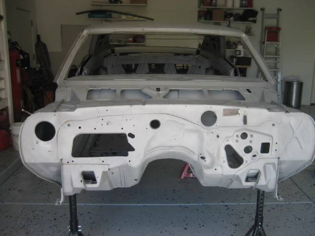

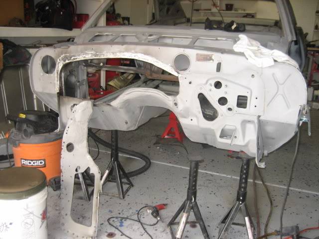

      Firewall. Hei retro goodbye.

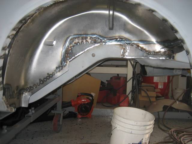

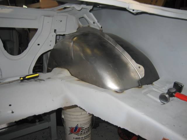

      Outer tubs going in.
      Fitting DSE tubs.

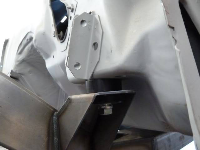

      On the 67 Camaro the drives side tub has a gap that need a fill plate welded in since the 67 is the only year out of the 1st Gen without the staggered shock mounts.

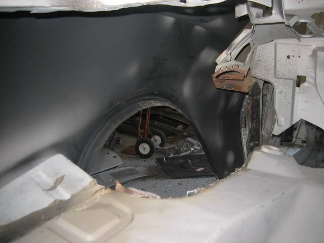

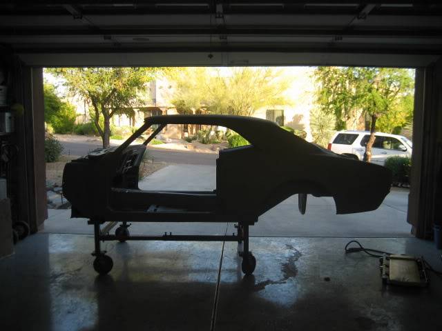

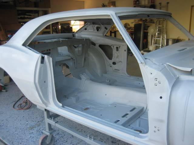

      More pics.

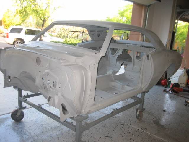

      After DTM.

      More pics

      Very nice matal work! I love it!

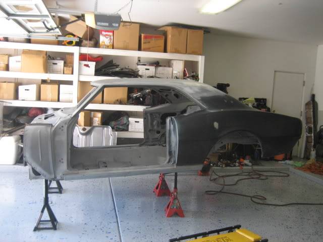

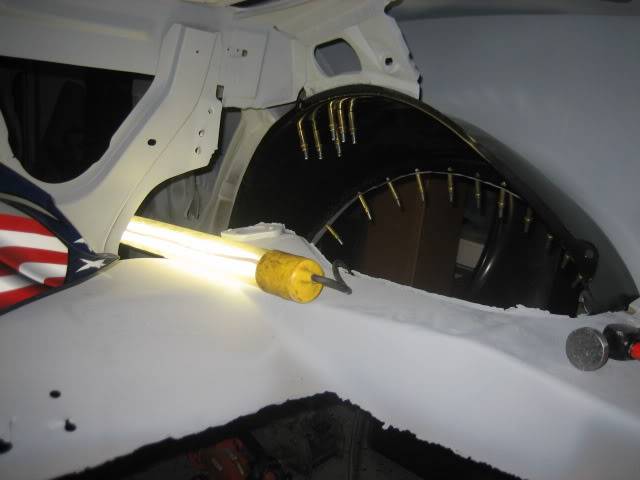

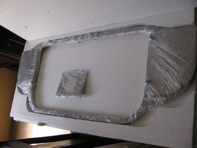

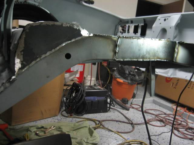

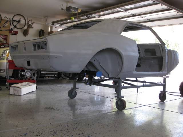

      Thanks guys! Here's some more pics. I'm on hold for a couple of weeks. I need to order a Subframe so I can put in the subframe connectors. I have a fuel cell and auto rad on order.

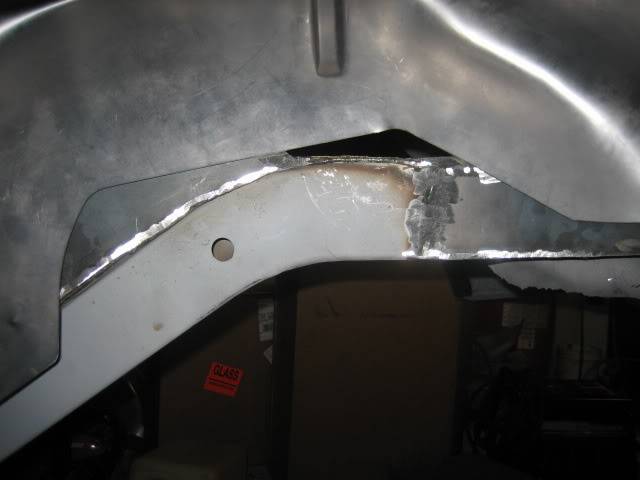

      Looks great C dog, make sure you seam seal those welds. Keep the moisture out.
      You do nice work.

      Hey thanks! It's been a while since I've done any of this stuff. Not bad for a RE broker. I'll be putting on 3m seam sealer this weekend. I'll post some pics after it's done.

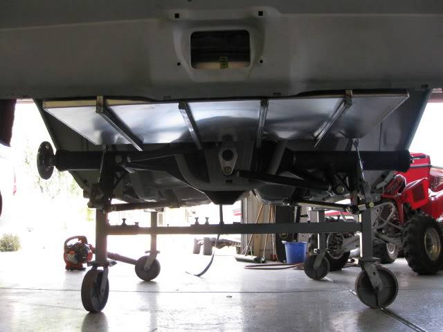

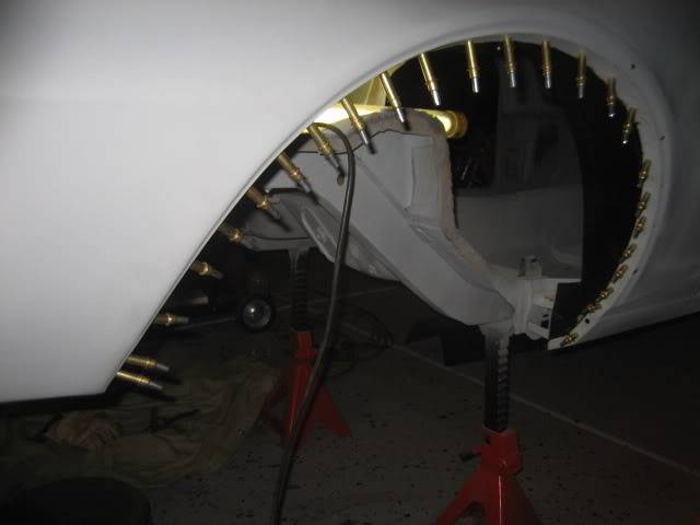

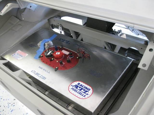

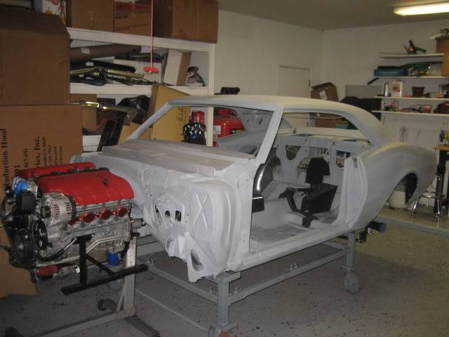

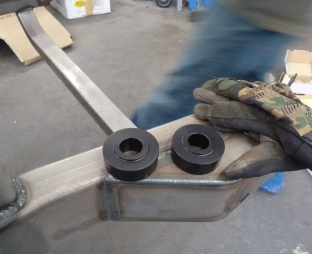

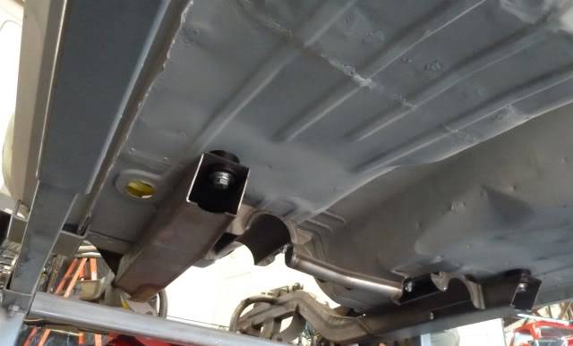

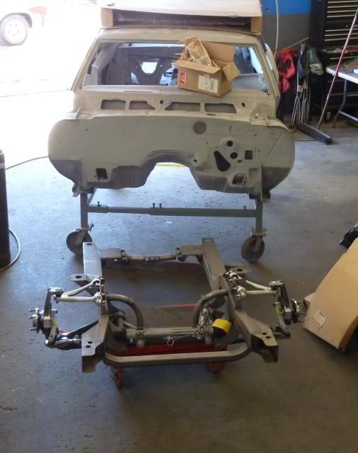

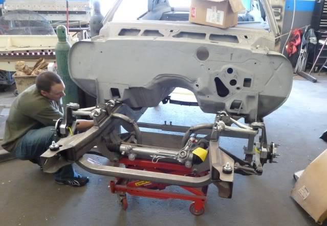

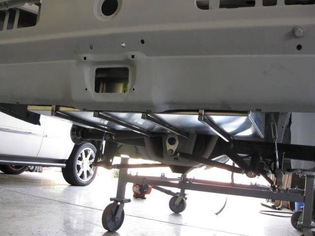

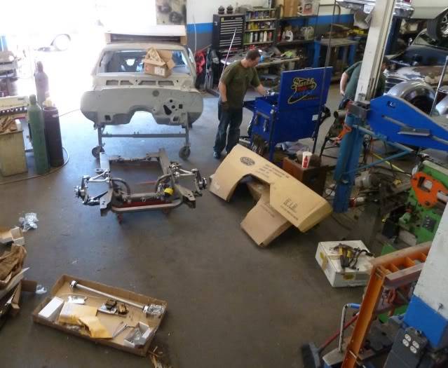

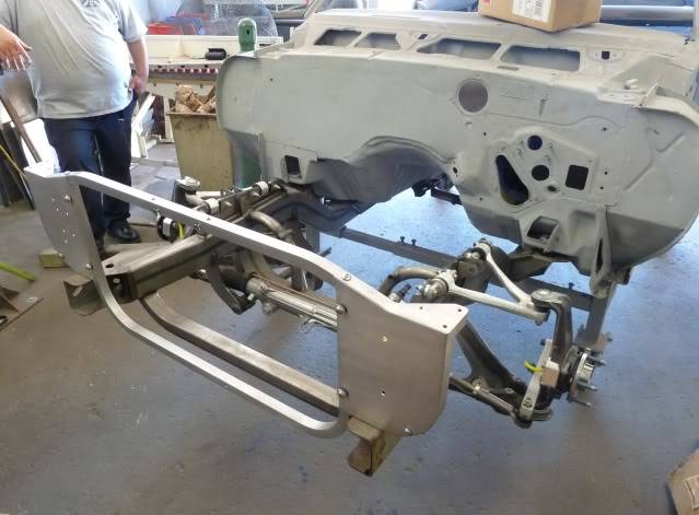

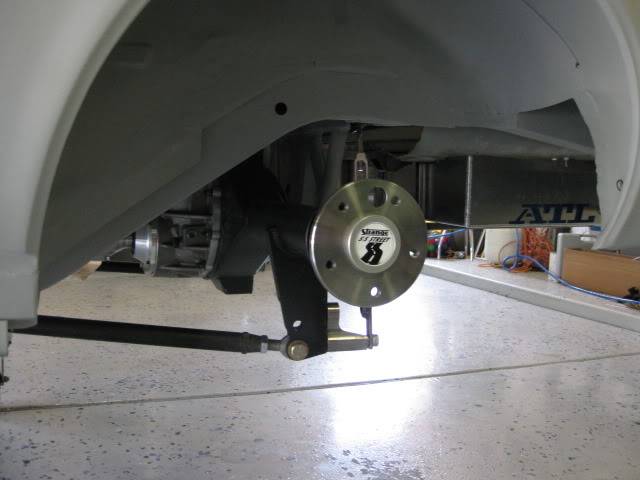

      So it's been a couple of weeks. Had lot's of parts on order and had a new baby girl named Giselle. Here's some pic's of what I've been up to. The ford 9 inch center is a Yukon aluminum bolt through unit with 370 gears, billet yoke and a Trac lock unit. The fuel cell is a ATL unit. It's their vintage racer unit with a custom top that has the flange set 3 inches down from the top so it doesn't hang down low below the rear of the car. I spent probably the last sub 100 degree weekend in the garage for the summer cutting out my new trunk pan and gas tank supports. I also went full retard on a Auto Rad radiator core support and radiator set up. Dual fans, shroud, controller and close outs. Art Morrison just hit my visa for a subframe so that'll be on the way to Los Angles soon.
      Next Tuesday I'm packing everything up and hauling it to LA to Starlite Garage in Torrance for a cage, Art Morrison front subframe, paint & body and finishing.
