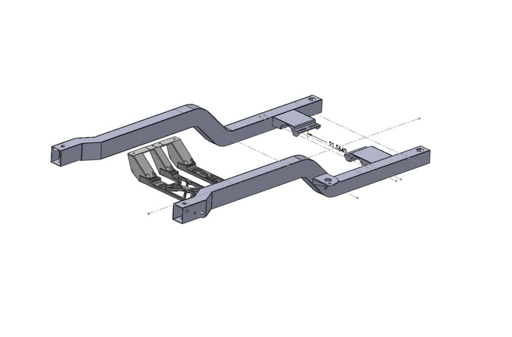

      This is what we have so far! I am doing the frame rails to use the JME Pro Series suspension..
