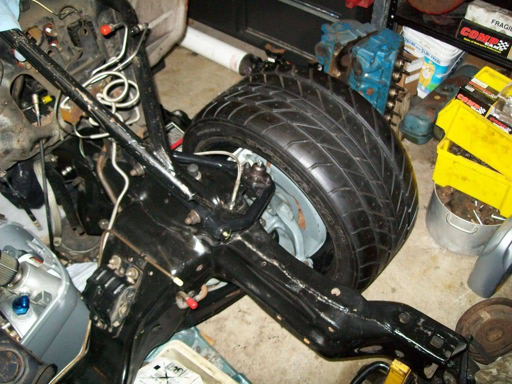

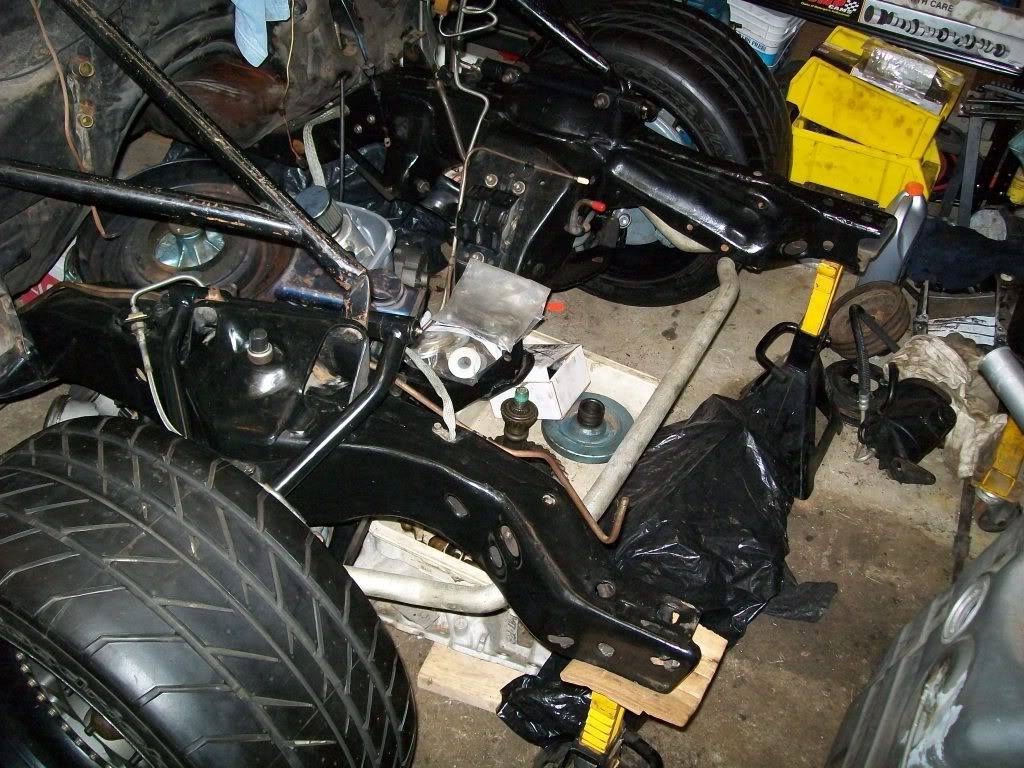

      Well, it's been a little while but I have a few updates. I am leaning toward painting the car white with the blue TA decals and hood bird. I am contemplating the blue SE strip kit as well??
      There is progress on the front suspension. I had the rotors machined so I could press in the 1/2" x 3" studs and the wheels are back together. I have yet to see if they still hold air . Anyhow the Koni shocks are in, the rotors, Willwood calipers, VSE sway bar and Jongbloed wheels are mounted. Now I need to mock up the cooling ducts for the backing plates. I threw the fender on to see how it looks. It's amazing how fast a car can take shape! I'm also working on fabbing up some heim joint rods for the shifter.
