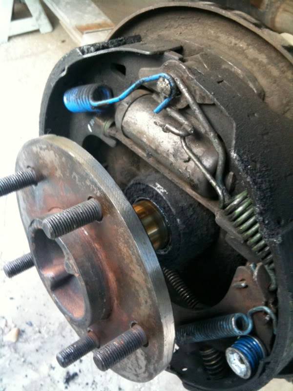

      Due to negligence on my part, my rear end basically grenaded itself. For as long as I can remember, there had been a black dirty/greasy substance on the right rear wheel. It basically looked like a little trail of oil with dirt and grime in it. Kind of like what a 40 year old engine looks like, lol. Anyway, I always assumed it was brake fluid with dirt that had accumulated on it. So I checked the brake fluid regularly and it was never low.
      Then one night while on my way home from a friend's house, the rear end started making horrible grinding noises. If I pushed the clutch in it got quieter and if I let it back out it got loud again.
      You've probably figured out by now that it was diff lube leaking through the brakes onto my wheels...well, I couldn't even make it home that night. Eventually I got to a stop light (literally like...3 miles or less from my house) and when it turned green, I gave it gas...but the car wouldn't move.

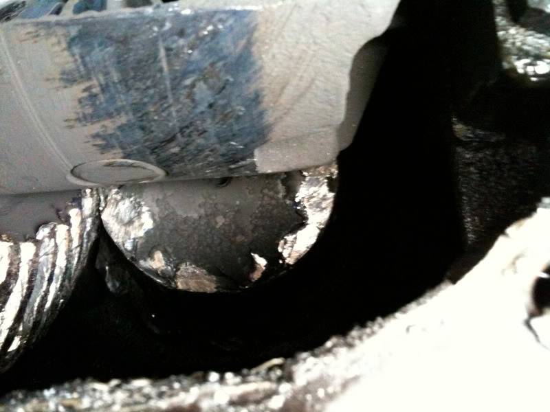

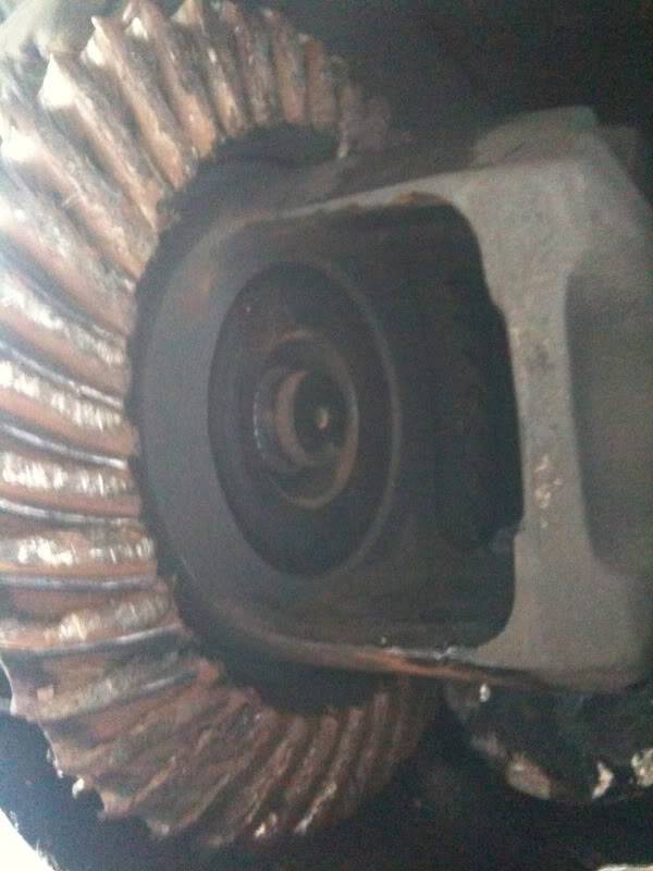

      I took a couple pictures the day after it happened and basically it ran itself dry and the pinion gear got annihilated. Here's a couple pics:
      I wanted to pull it apart today but I can't find the key for my wheel lock. I hate those stupid things. I won't be able to see if there's damage to the axles until I find it. Anyway, I'm basically wondering if it's even worth trying to rebuild it. I'm hoping that all I really need are a ring and pinion and a bearing/seal kit. Do you guys think it got hot enough to maybe warp the axles and/or housing? I've been scouring ebay, forums, and junk yards and I can't find any rear ends that would fit my car.

      Which rear end is it? Looks like the 8.5 10 bolt, but I can't say for sure because the pictures don't give enough details about the housing. If this is the 8.5 then it is worth rebuilding. I have built many of these with upgraded parts and they are very strong. It cost some money, but it's worth it if you run it hard.

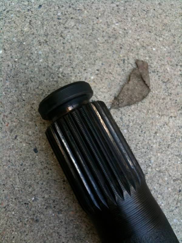

      Well I started to take it apart today. Got the passenger side axle out with no problems, but the driver's side doesn't want to come out. It comes out maybe about an inch and then stops. I don't know if I should try to pound it out from the passenger's side because I don't want to damage it. Here's some pics:
      Any ideas on how to get it out?

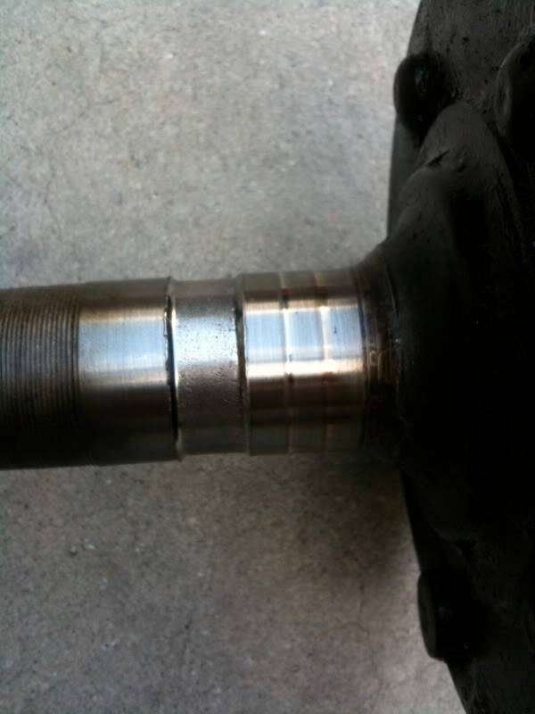

      I also took a couple pictures of the axle that did come out. I don't know how to tell if it's bad or not.
      Pics aren't the greatest, but all I had was my phone. Hopefully they're good enough.

      Wow, that is one of the worst axles that I have ever seen. It's a wonder that it didn't break. I can understand why the seals were leaking, and I can understand why the other axle won't come out. You are probably going to have to drive the other axle out. Don't worry about damaging it, it's already trash.
