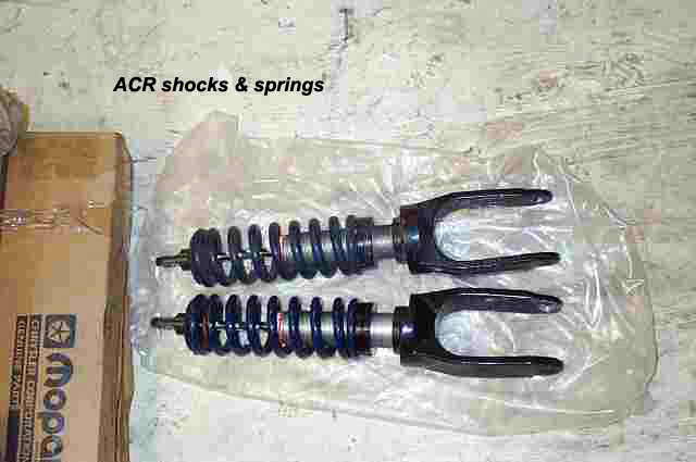

      This is a pic of the shock mount. Hard to see how it screws in but it gives you an idea anyway.
      The bottom shock in this pic is the rear and you can see the threads at the bottom where it screws into the mount above. I may be able to use the stock shocks but I haven't been able to determine the size of the springs to see if I can buy a different set of springs. I've been on the Viper boards asking other questions and I haven't gotten a lot of help from those guys so figure I'll try guys I know are cool.

      I dont like this for one reason. it looks as the legs on the horseshoe pivots then you have the movement allowed by the bushings thats on this part that will put huge stresses into that little center bolt that runs through the bushings..

      That's a good thought. As I thought about it a bit more yesterday, with the movement on the horseshoe pivots, it would be quite a bit of stress on the stub, and likely a fair amount of additional unnecessary deflection in the bushing. Likely why Chrysler went with the design they did. Also why I'm intrigued by what Ride Tech is working on.
