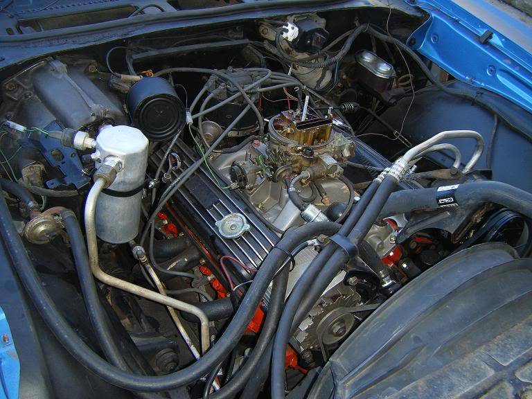

      outlaw 03, here is my low buck A/C in my 70 El Camino. I replace the whole system with later model parts. Replaced evaporator,condensor, all hoses and lines, compressor. Cost me about $150.00 I can give you more details if you want. Randy

      Quote Originally Posted by spoilersbyrandy View Post

      Oct 2008
      125
      Quote Originally Posted by outlaw 03 View Post
      I like your setup kind of what I had in mind but I'm wanting to use an under the dash unit out of a FWD car. What controls did you use?
      It still uses the factory controls.
      what under dash stuff are you using
      1,753
      Probably still factory. looks like he replaced the factory system (think it was a TXV/POA system if memory serves correctly) w/ a CCOT system as used in late 70 systems and later. Uses the same heat exchangers and ducts

      Oct 2008
      125
      Everything inside is still factory A/c 70 El Camino. I just replace all under the hood stuff.
