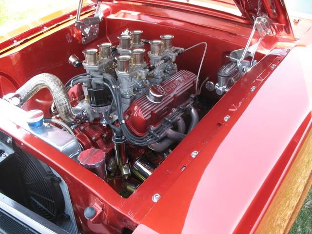

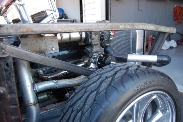

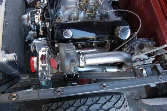

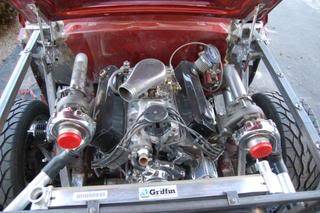

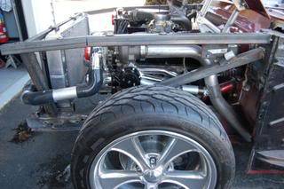

      I decided to remove the webers and go with twin turbos. I am repainting the car black and powder coating all trim flat black. Shaving the drip rails and installing the Shelby quarter windows to replace the vents. I was thinking about powder coating the spokes on the Boyd wheels. What do you think? I have included some before and progress pics.

      I wish twin turbos were in my future! Looks great. The blacked out look is one of my favorites, I like all black wheels.

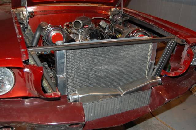

      i like the radiator support. anymore pictures with out the fenders? also what kind of header/turbo manifolds did you choose

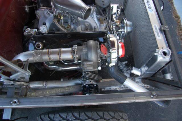

      I still have the 1.5 drop leaf springs in the rear. (tubs next year) I actually am still in the process of completing the rad support so I don't have any pictures with the fenders off. I will be welding on the fan and overflow supports this weekend. I will post some pictures when I strip the front end and prep the chassis for paint. The manifolds are polished stainless for a later model 5.0 Mustang. I had to cut off the turbo flange and reweld them on so the turbos faced straight forward and at the proper angle.

      Twin turbo's is a pretty sweet way to go.

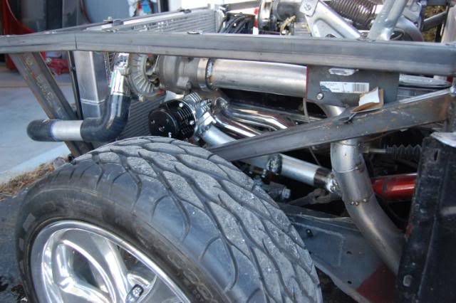

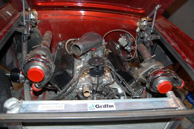

      Front sheet metal removed, intake and wastegate tubing added. Need to install fuel system and ignition components then I can remove the motor and start body and chassis finishing.
