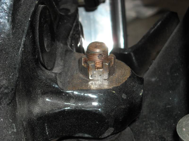

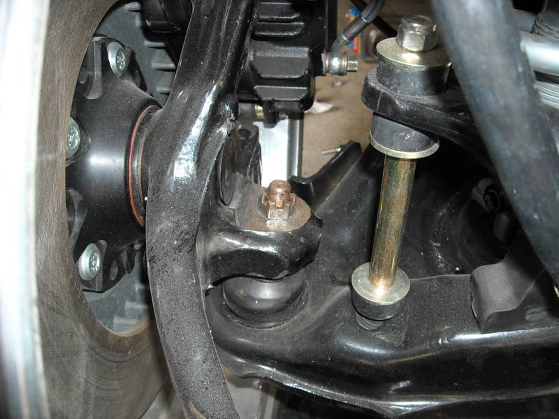

      Yes, its my stock spindle. I double checked the measurement and to get the hole in the stud to be centered within one of the notches in the nut, the nut would need to be raised another 1/4".
      Here's a few pictures:
      I thought maybe my spindles were worn but if they are, then all the ball joint holes on both spindles are worn the exact same.
      When I first assembled everything, I checked to make sure the ball joints were seating properly by using machinist dye on the studs and then tightening everything down.
      The patterns looked fine and the ball joints are seating really well in the spindles considering it took a mallet to get them separated again.

      To me it looks like a short nut. But either a taller nut or a thick washer will fix it. I would make sure the pin of the balljoint isnt in the bore of the spindle too far just to make sure. You dont want the flat of the pin (the section past the taper) to be contacting the spindle. If the spindle is clear of the non-tapered part of the pin then I think you are ok. Just raise the nut up with a washer or get some taller nuts. JR

      Well, I haven't heard back from Marcus but in the meantime I tried a few high grade steel washers and it seemed to work out perfectly.
      One washer under each nut and then torqued to spec. Slid the cotter pin in and everything looks kosher.
