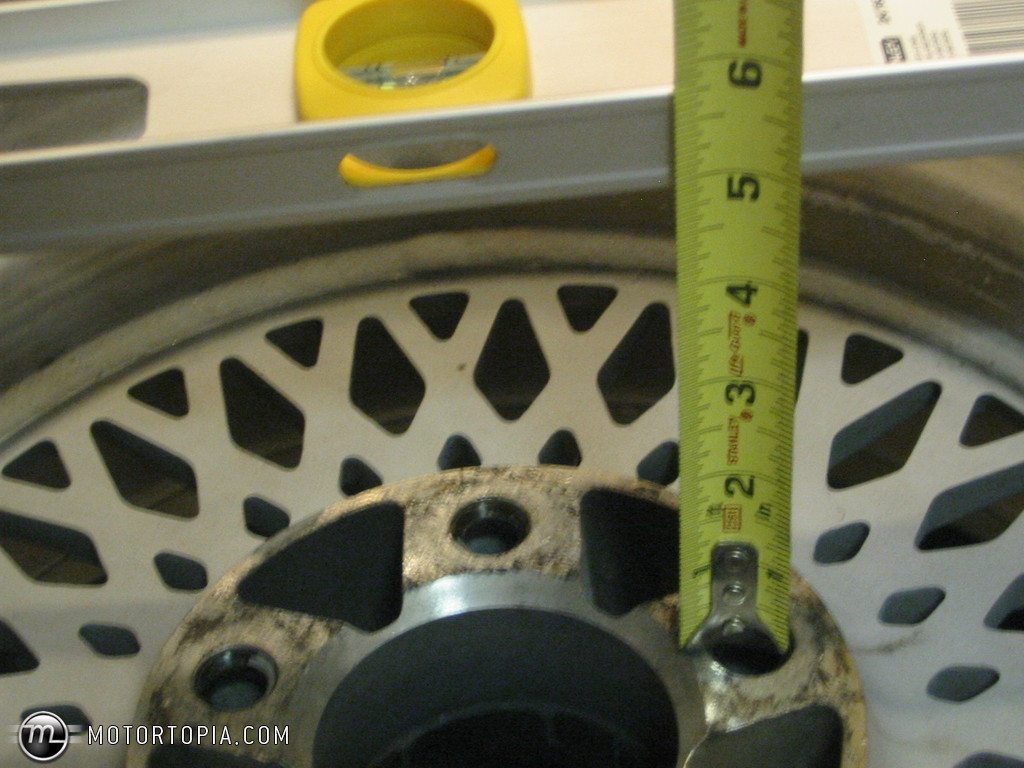

      Here's a shot of a Monte SS, same problem. A little over 5" of backspacing from hub plate to frame rail.
      The wheel hub to the outside of a mounted tire, just under 5":
      It is a tight fit.

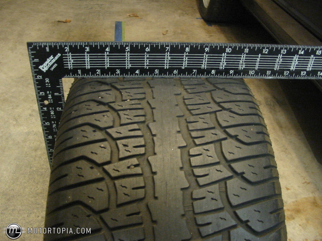

      The tires are BFG 255/50/16, on a 16x8, -10mm offset, 4" BS. They are 10.5" wide on the outer tire bulge.
      A 8" wide wheel is 8 inches wide on the inside lip where the tire mounts, the external lips of the wheel are 9" apart.
      A 255 tire would be 255 mm wide = 10 inches almost exactly, but the sidewall adds a extra .25" of tire
      for each side. A larger diameter wheel/tire, usually show less tire bulge due to a lower profile.
      A wheel with 5.25" backspacing may already be rubbing on the inside rail, a tire on that wheel would be need an extra .5-.75 to fit.
      You might be able to use a 1" wheel adapter to get those wheels on.
