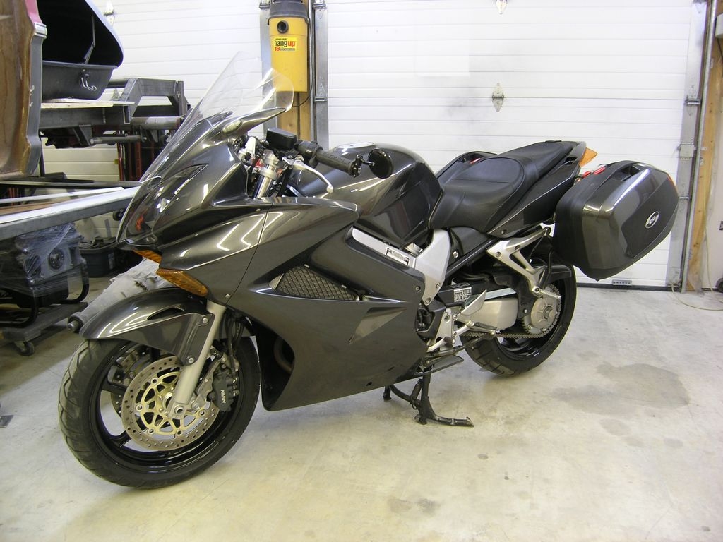

      Hey Guys,
      I posted this a while back on another forum but seeing as I'm spending a lot of time here I though I'd post it here.
      Painting 101
      First of all I am far from an expert on this stuff. I spent a few months reading forums, articles, asking experienced friends as well as reading product data sheets. I am writing this for a record for myself on the next jobs as well as for others like me who want to learn. I’m an Engineer and try to understand each and every step of the process to the fullest, just like I do at work. Hopefully this will clarify certain aspects and not muddy things up too much.
      Enjoy,
      Wesley J

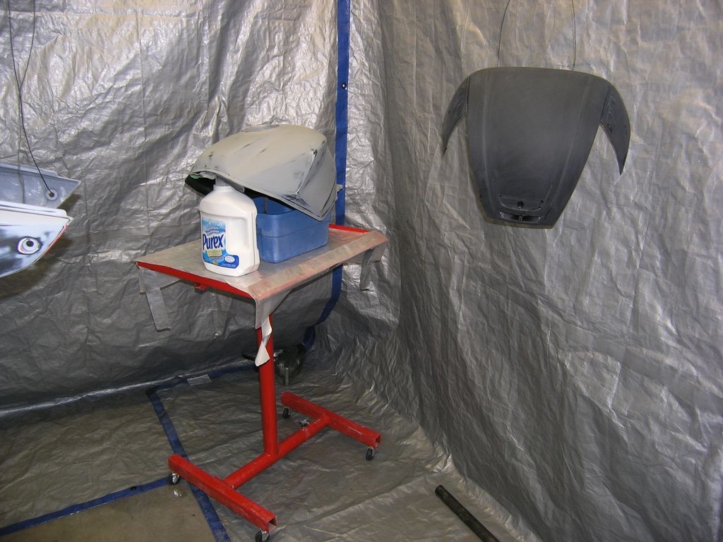

      Paint booth
      This is an area that I really need to improve. While I was painting my bike it was consistently between -40 and -50 degrees C (-55 F). Because of this I wasn’t able to ventilate my shop. This sux. Although I don’t believe it effected my paint quality much, it did make it difficult to work.
      As you can see from the pictures I used tarps that go from floor to ceiling. I inserted some hooks in the ceiling. This was IMHO is a very good system, easy to put up and take down and the tarps were only about 1” down from the ceiling. This meant there was very little are movement in the “booth” and resulted in very little dust in my paint. I have a radiant heater in my shop so the only air movement in the shop is due to convection.
      The day before spraying I took my car washing sponge with soap and water and washed the tarps down from top to bottom and rinsed them very well with a hose. The day of spraying I wet the floor down extensively to keep dust on the floor from becoming airborne as well as keep product from sticking to the floor.
      If you have the ability, have a couple of lamps standing around to cast reflections to help you see if you’re laying down an even coat. My booth was too cramped so I wasn’t able to do this.

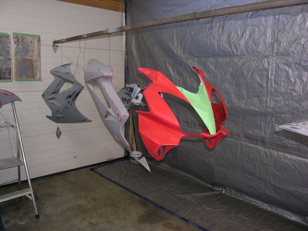

      Hanging of parts can be bit of a challenge. As you can see from my pictures I hung the majority of my parts from a bar which hung from the ceiling. Due to my shop size constraints this was about the best I could do. What happens is that you end up trying to paint a moving target; hence my left arm getting painted while steadying parts. If you have the space and stands, parts sitting on something can give you a better quality finish assuming you can still get to all of the surfaces.
      Edit: In hindsight I think I rushed my booth setup. I could have moved my frame table that my truck is on for some more room. Then I could have spent a bit of time building some wooden stands for parts. Yes it would've taken another evening but it would have improved the quality of my finish.
      A note on metallics: when hanging panels try to hang them in the orientation that that go on the bike. This way the metallic particles all lay the same way and therefore all panels have the same color when out in the sun.

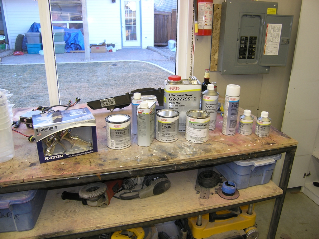

      Paint Products
      I used Dupont’s Chromabase system for a few reasons. It’s easy to spray, reasonable priced, very good quality, durable and is easy to mix. All products share the same reducer/activator which makes messing up the mix procedure difficult. The PDS’s are very well written and very self explanatory. I made myself a summary of each product as well as a checklist for when I was painting. I’ve included this list later on in this post.
      Edit: I used approximately 500 ml sprayable per coat for all of the products. So, I bought at least twice as much product as required, with the exception of clear which I bought about 3-4 times as much as needed. It was my first time buying product so I wanted to make sure I had enough.
      Total product cost was $450 CND so I'm guessing I could do it for $250 with what I know now.
      Link to Dupont’s page: http://tinyurl.com/2gsqmd
      List of products:
      • DuPont™ Plas-Stick® 2320S™ and A-2320S™ Plastics Cleaner
      • DuPont™ Plas-Stick® 2322S™ Adhesion Promoter for Plastics
      • DuPont™ 7704S™ ChromaSurfacer® 2K Urethane Primer-Filler
      • DuPont™ 7710S™ / 7740S™ / 7770S™ ChromaSeal® 2K Urethane ValueShade® Sealer
      • DuPont™ ChromaBase® Basecoat
      • DuPont™ ChromaClear® G2-7779S™ Multi-Mix Panel & Overall Clearcoat
      • Tack Cloths (for automotive paint)
      • Mixing cups and sticks
      • Filters
      • Cheap thinner for gun cleaning
      • Evercoat Fibertech Kevlar reinforced filler
      • Evercoat Poly-flex glaze
      All of these products are the best I’ve ever used by far. I’ve done a few single stage jobs in the past (5+ years ago) and you really can’t compare the quality.

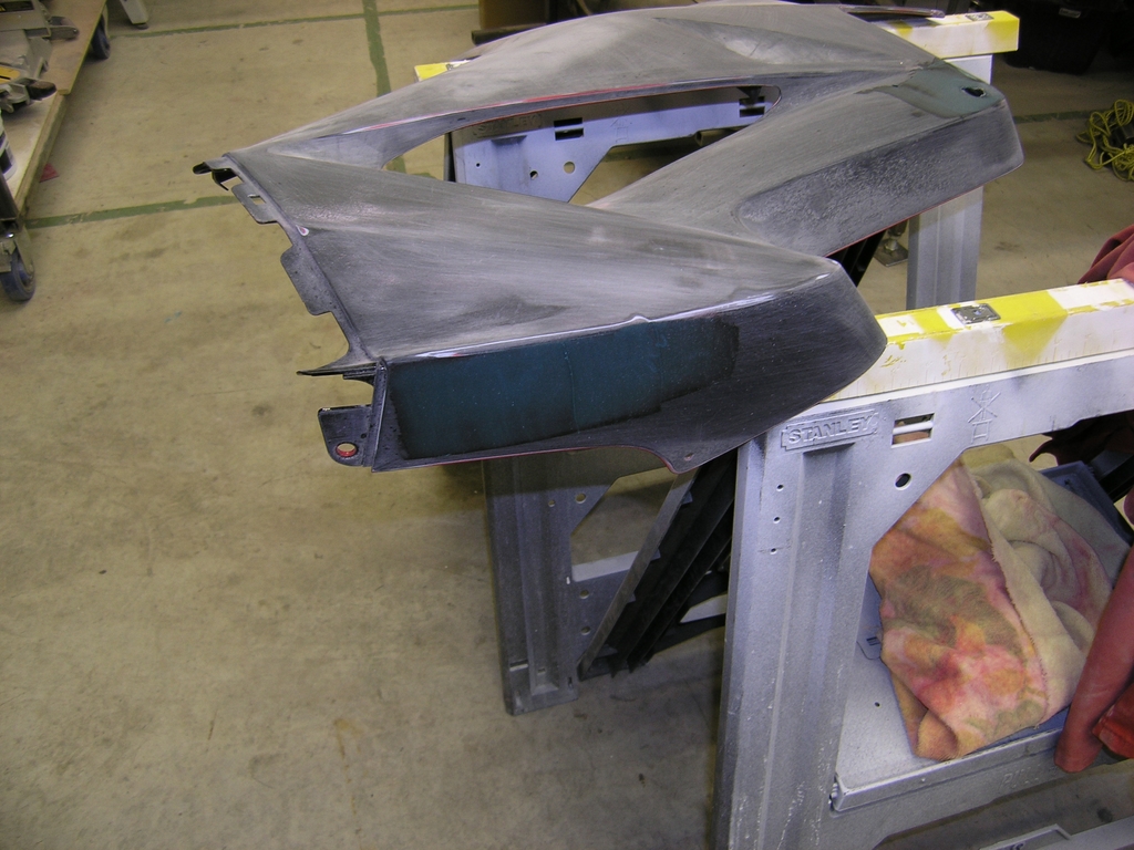

      Prepping for Sanding/body work
      I started by washing all of the parts with soap and water followed by the DuPont plastics cleaner. The reason for this step is so that you don’t force oils or waxes deep into the first bunch of scratches you create when sanding. Start with a very clean part and you have a better chance of successfully putting down a durable paint job.

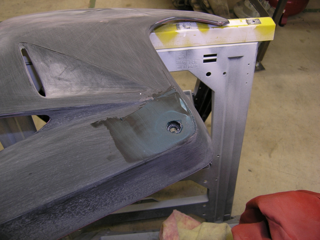

      Sanding
      For all sanding that I did, I used an X pattern whenever possible and covered as large of an area as possible. I used a small flexible block that allowed all but the tightest spots to be sanded. Do not use sandpaper and your hand only or you’ll end up with a wavy panel that won’t be seen until you get a nice coat of clear on it. Always use a block unless it is completely impossible otherwise.

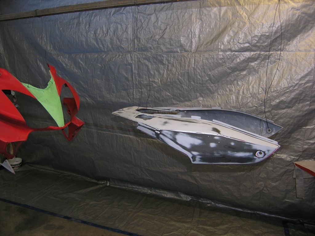

      For parts that required extensive repair, I started with 60 grit dry paper. This give the filler something to grip to. I then proceded to do the rough shaping for the filler with 60 grit. The filler I used does not clog the paper whatsoever, that in itself makes it a really good value.
      All parts that I felt needed primer filler, I sanded completely with 180 grit dry in order to give it a good base to adhere to. The primer/filler will likely fill 60 grit scratches with ease. The primer/filler is truly amazing, it will fill and hide much more than I expected. 2 coats of it then I blocked all panels with 180 to knock the roughness off (this stuff really builds) then switched over to 320.
      At this point I used spot glaze to fill any small imperfections/deep scratches. The stuff sets up very quickly and is sandable without clogging the paper in a mater of 15 minutes. 320 dry paper is used for this step.
      I then switched over to wet sanding.
      From above:
      “When wet sanding, get yourself a good spray bottle. I fill mine with luke warm water and add a bit of dish soap to it. This reduces the interfacial tension of the water which has 2 effects. Firstly, it lays flat on the surfaces you’re sanding rather that beading up. The second and probably more important effect is that the water entrains the particles much easier. So, in essence you have a layer of water between the particle and the surface, reducing micro scratching.”
      I started by sanding all of the panels with 400 until I felt I had covered all areas equally. The goal here is not to shape panels of remove imperfections, it is to smooth out the surface so that and existing scratches do not transfer through the base/clear. Once I was comfortable that my job was done with the 400, I repeated with 600 grit.
      It’s actually surprising how quickly this goes by when you are using the proper paper and methods. In 2 evenings I completed all of the body work and sanding.
      Prepping for paint.
      I started by washing all of the parts with soap and water followed by the Dupont plastics cleaner. I was very anal about these steps, really making sure things were clean. For the plastic cleaner step I used a 100% cotton fiber free automotive style polishing cloth. Beware using old hand towels as they may have lingering detergent/fabric softener in them.
      Allow the parts to flash dry then tack them clean religiously. I’m used to tacking wood furniture prior to finishing but these tack cloths are much less aggressive. You pretty much have to tack in one direction to pick everything up and not re-deposit it on the panel.
      You are now ready to start laying down some product!
