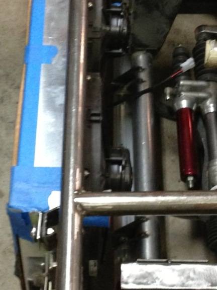

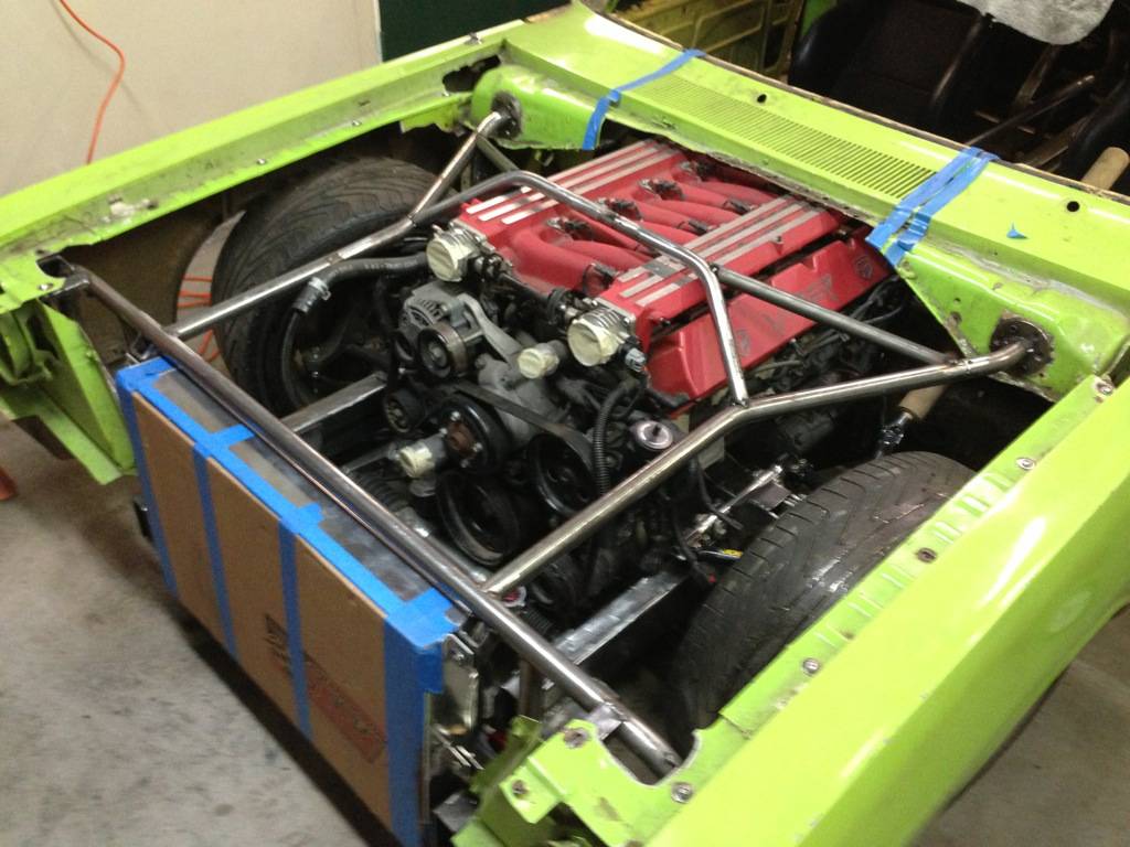

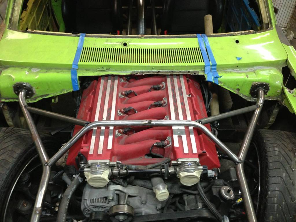

      After over a month off because of illness, travel, and other fun stuff, I'm finally working on the car again. My firewall/core support bars have been completed and I raised the engine/trans 1-1/4" to gain additional clearance for my steering system. Today I added my version of a monte carlo bar...
      Still need to finish the fender mounts but the engine compartment is coming together. Mocked up my radiator...

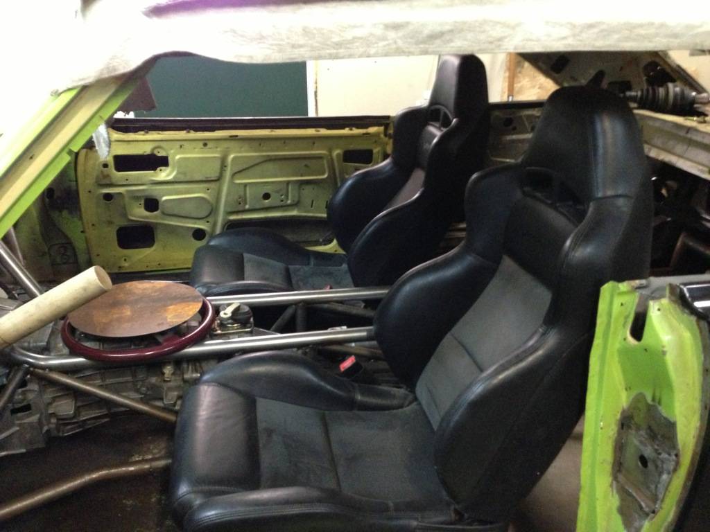

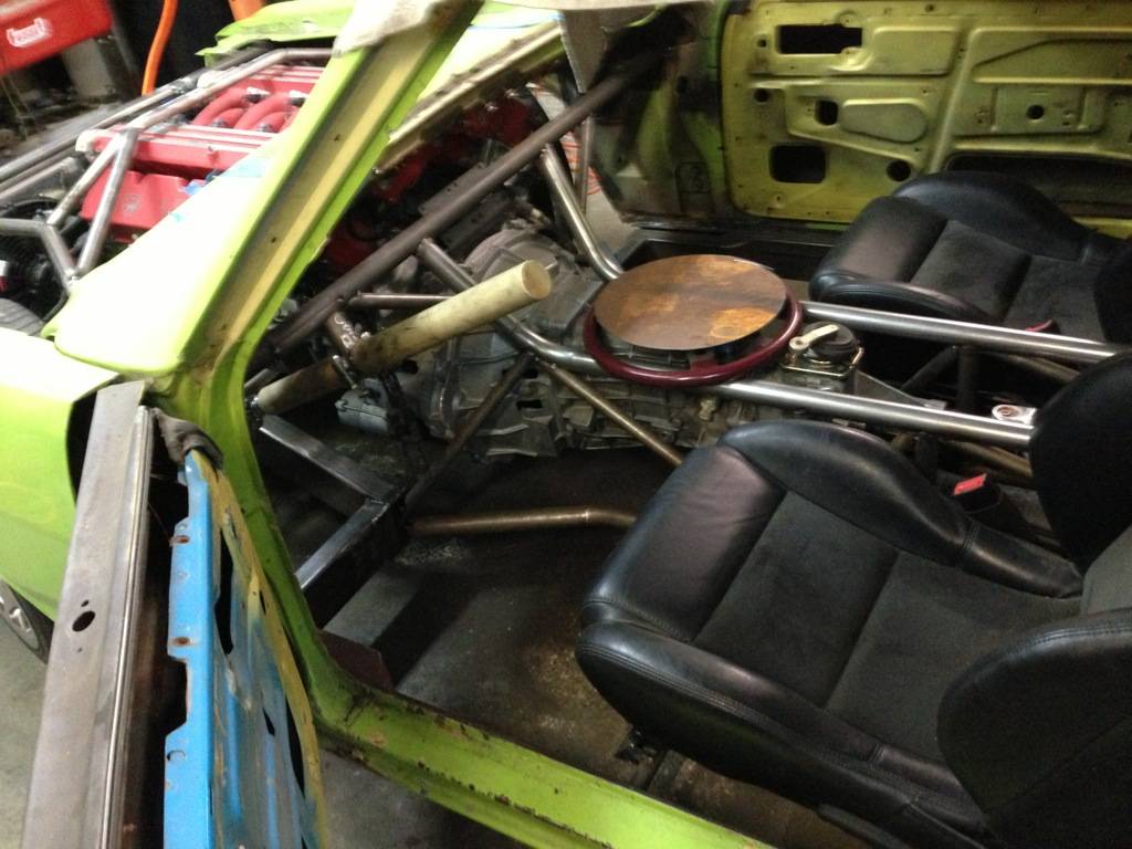

      Built my seat mounts and installed my seats...
      Mocked up a wooden steering column and will hopefully receive the real deal tomorrow, courtesy of MCB and Ididit...

      in your shoes, id make the monte carlo bar removable. would really suck to have to drop the engine out the bottom to change a valve cover gasket......
      at last thats the way it looks to me that it would go.
      michael
      Michael Crawford
      Jul 2009
      Grand Rapids, MI
      1,559
      Thought about it but the entire front clip is removable with just a few bolts, plus, though I haven't attempted it yet, I positioned the tubes so I can access all the bolts on the valve covers and "should" have enough clearance to remove them.
