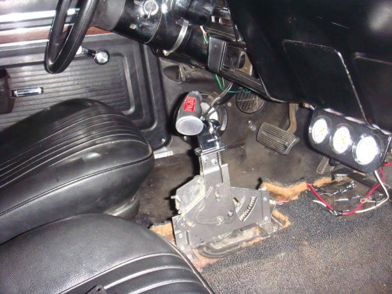

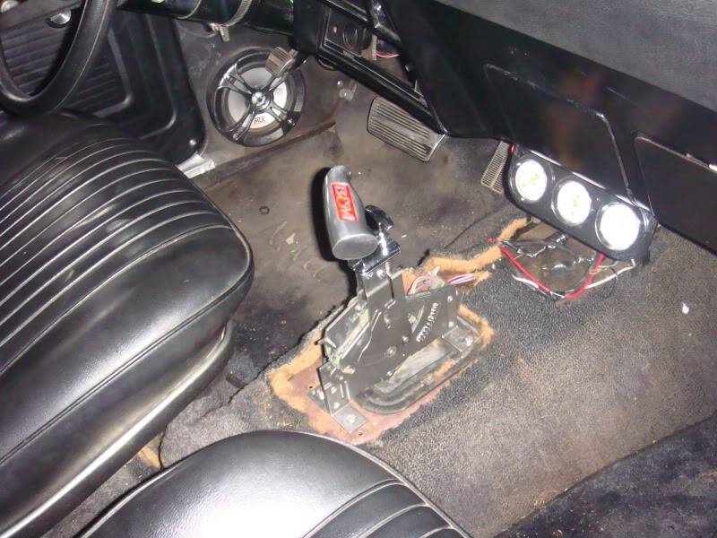

      Here are some pics of mine before I closed it up. Not sure if they are what you are looking for. If you want the orignal pictures, as they are bigger and you can zoom in, PM me your email address.

      well thats close but mine is the console fit for the third gen camaro...but see yours doesnt even have brackets??? i wonder....

      It'll sit a little low without the brackets. I believe the rise on the front was around 1 1/2- 2". 1- 1 1/2" on the rear. Rectangular tubing will be your friend.

      You can follow the link to the install instructions which will show you what they look like. The rear "c" shaped bracket is roughly 1 1/4" tall x 2" deep and the front stepped bracket is 1" tall and 4 3/4" long.

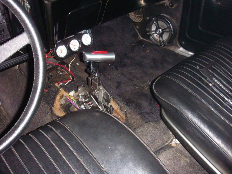

      thank you guys those dimensions will help ALOT!!! And i prolly will end up using the rectangular tubing....here's a pic of it just sitting in the car....i think it looks good and dont mind the mess...its nowhere close to drivable lol
