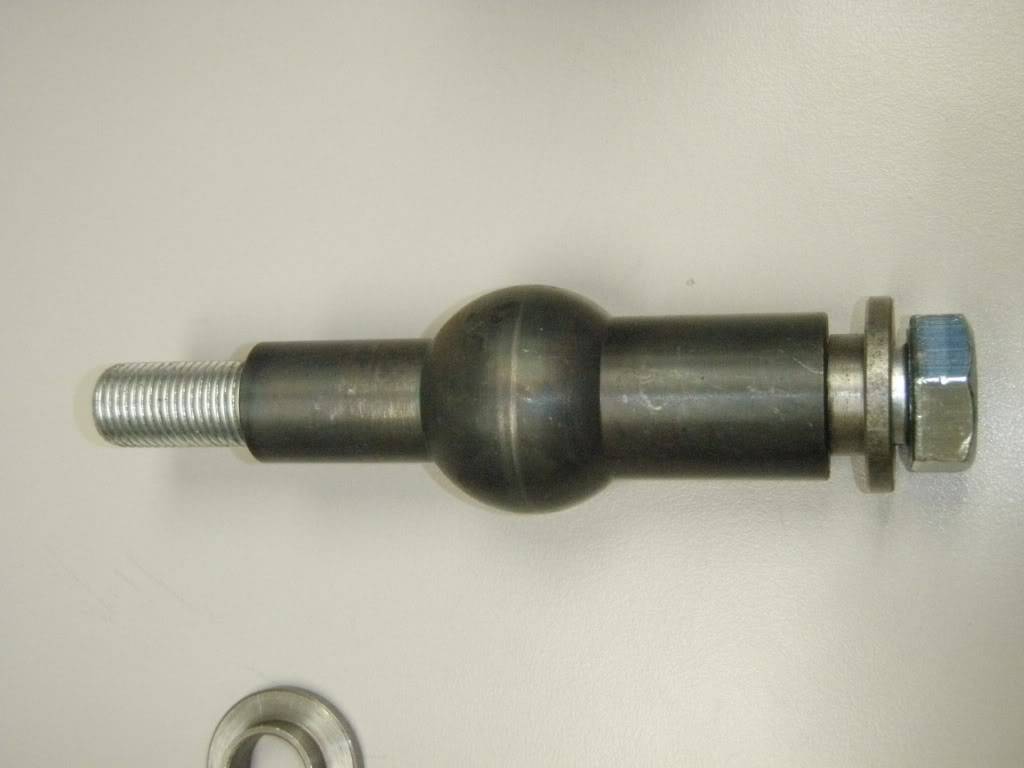

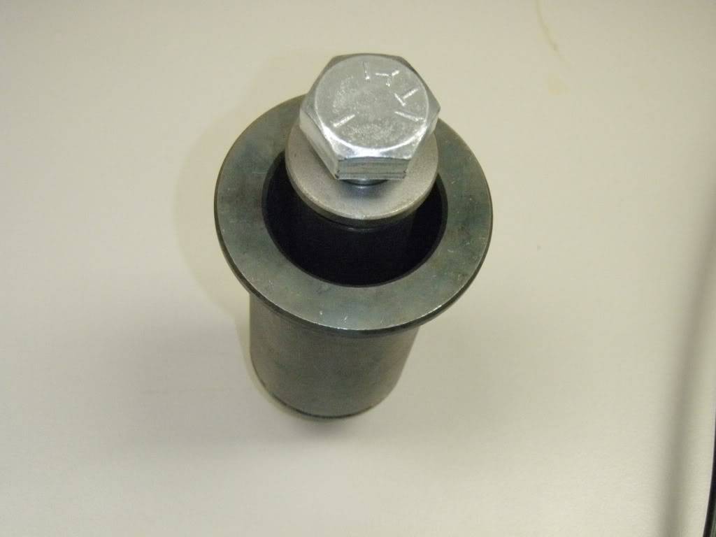

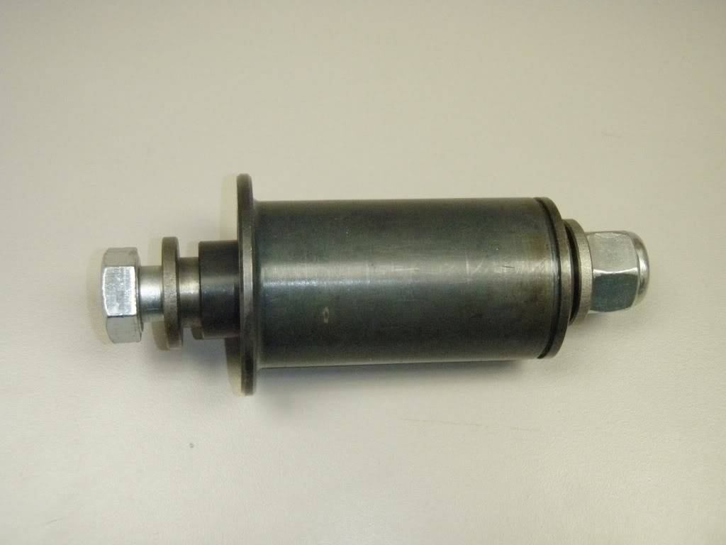

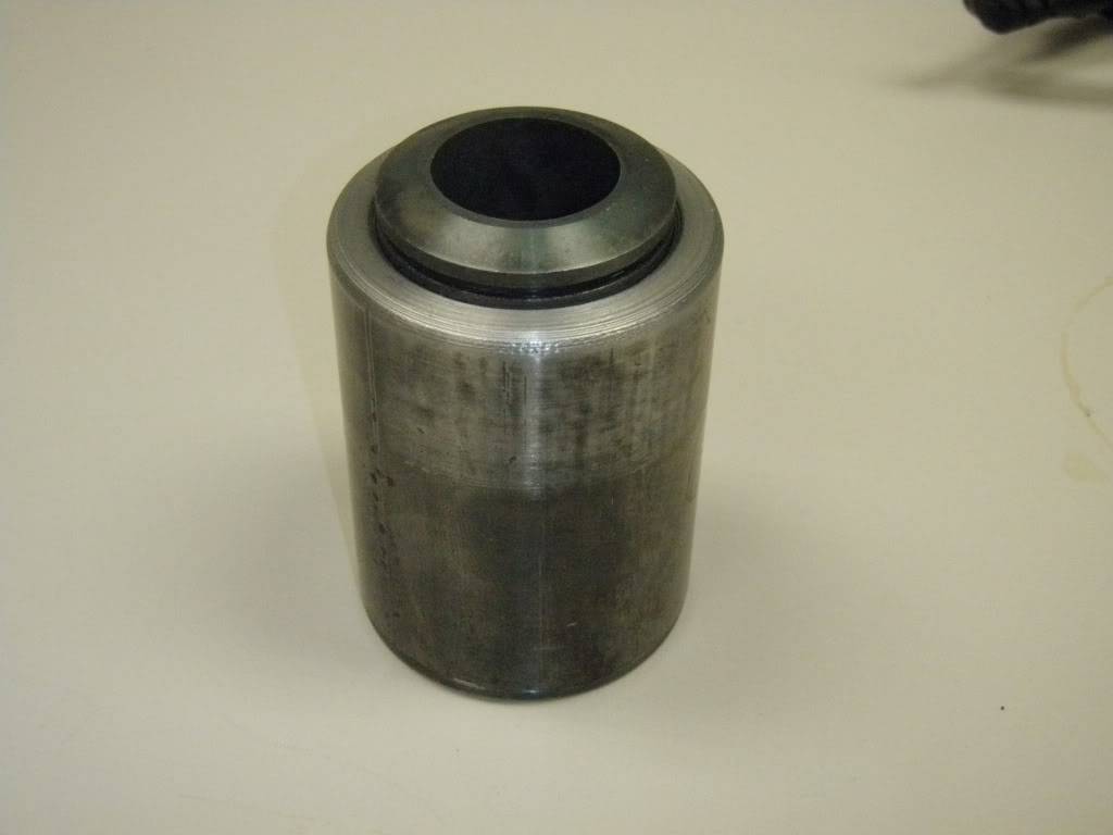

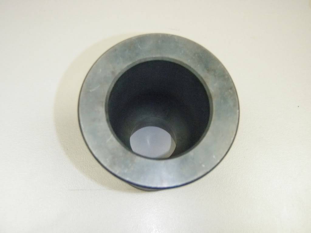

      Ok, here's what I have decided to do for now. I am going to run the stock leafs for the time being and try to focus on other aspects of the suspension first. I am going to replace the shackle bushings with solid units, and I will replace the front spring bushings with these nifty Afco pivots that I purchased. These give a solid connection but still allow the spring to twist (if the spring can't twist then it binds and affects the spring rate). Unfortunately these pivots only come in 1.5" diameter, and my stock springs have a 2" diameter front leaf bushing, so I made adapters to mate the parts together. You can see some pics I made below. Also, someone discussed adding leafs to the spring packs. How would one go about doing this?
      Afco spring pivot assembly:
      Afco spring pivot assembly (view 2):
      View inside pivot race:
      View of pivot bearing:
      View of pivot race/bushing with the adapter that I made:
