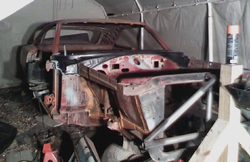

      I have tons of pics of the car. It is not very far along yet. I just got it in June. Here are a few of it

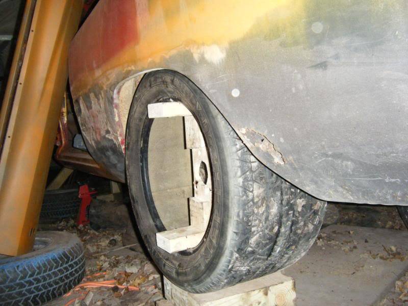

      The tires I want to run are 315's. These are some junk 315/35 16's. I built a rim simulator for em from a 2x4
      This is the latest pic I have of the car. I had to cut off the old cowl because someone cut a big hole in the grill. I got that one and had it sand blasted and painted with epoxy primer.
