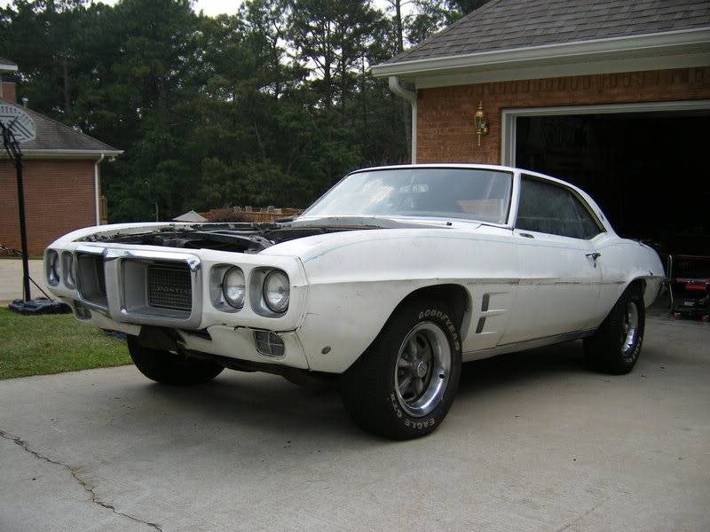

      well i have had this firebird around for awhile. i am building it for turkey rod run down in daytona florida. it is going to be a kind of different build. low to the ground, 18" wheels and two-tone paint. i am using the inline 6 cylinder and retrofitting a T5 transmission with the hydraulic clutch assembly. that is going to require the most fab. i am using 1st gen four speed pedals that i will modify to accept the master cylinder rod. i will have to fab a transmission mount and cut the driveshaft. i have alot of different motor combinations that i could use in this car (like a forged 455 w/ a th400, or a lt1 t56, or a 383 w/ 700r4 or t5) but i want to do something different that not many people would really do.. and i dont know if anyone has ever put a T5 behind a L6 but i am sure it has been done before. i am doing front a front disc conversion and hopefully a rear disc conversion a little later. 2" drop spindles in the front. heres some pictures. i hope to update this thread with progress. so keep checking in.
      here is the car as when i got it.

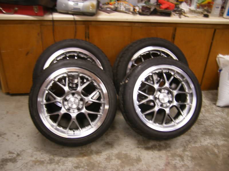

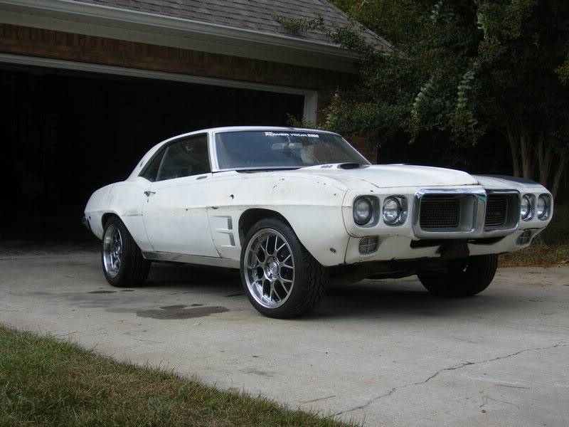

      wheels and tires are adr 18"s. 18.8.5 in the front with a 2" lip and 235/40/18 bfg t/a kdw flame series tires. ($215 per tire) and the rears are 18x9.5 with a 3" lip and 275/40/18 goodyear eagle F1's ($325 per tire)

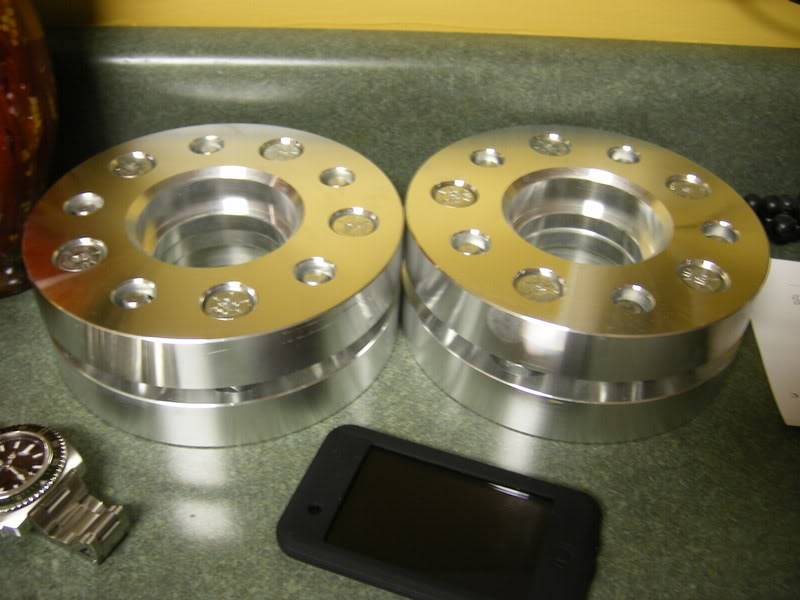

      spacers 1" hub centrics. idk if these are the right size i was thinking i was going to need 2" spacers but the place i bought the spacers from told me these would work so i will try them, if they are wrong i have to send them back and get the correct size. the front discs are going to move the wheels out a half inch so i have to get the disc conversion on for mockup so i can figure out the spacers that i need.

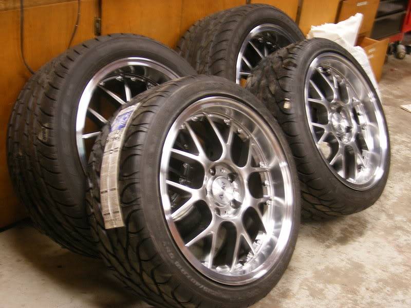

      mock up.. they look absolutely SICK!
      hopefully the disc brakes wont push the wheels out too much more because they are sitting about perfect.

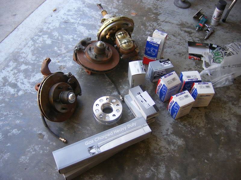

      soon to come: disc brake conversion on the front with 2" drop spindles dual bowl master cylinder, power brake booster and adjustable proportioning valve. T5-swap, engine bay detail, finish striping, primer black then paint after awhile.

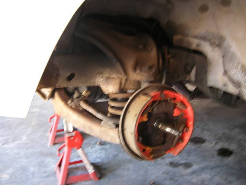

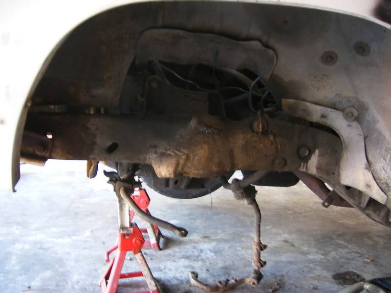

      ok a little more progress today i started on the disc conversion and front end rebuild. i got both the upper and lower control arms off the front driver side. man this thing hasnt been messed with in forever. the shock seperated on me and i had a little problem seperating the ball joints and tie rod end. im going to try and paint everything before i put it all back together.

      all of the parts for the front end
      here is the broken shock and lower control arm... its going to be tough getting that super tall spring in there with 2" drop spindles...

      great progress those wheels do look sick on there..hopefully they work out for ya..keep up the pics..

      Do yourself a HUGE favor and stake those studs in the aluminum spacer some how. I have had the studs turn in the aluminum on mine, and had to cut them off. Now I just run really long studs in the axles and hubs with an aluminum spacer with no studs.
      Jeff
      what do you mean? i havent heard of this before, this is the first car i have had spacers on and really dont have any expirience with them.

      I mean the studs that are pressed into the spacers will spin because the aluminum is not strong enough to hold them in place.
      so what you are saying is you drilled holes in from the outside of the spacer and used like a roll pin to keep them from spinning?
