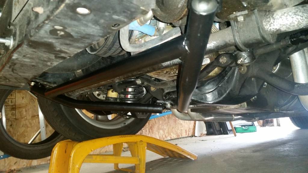

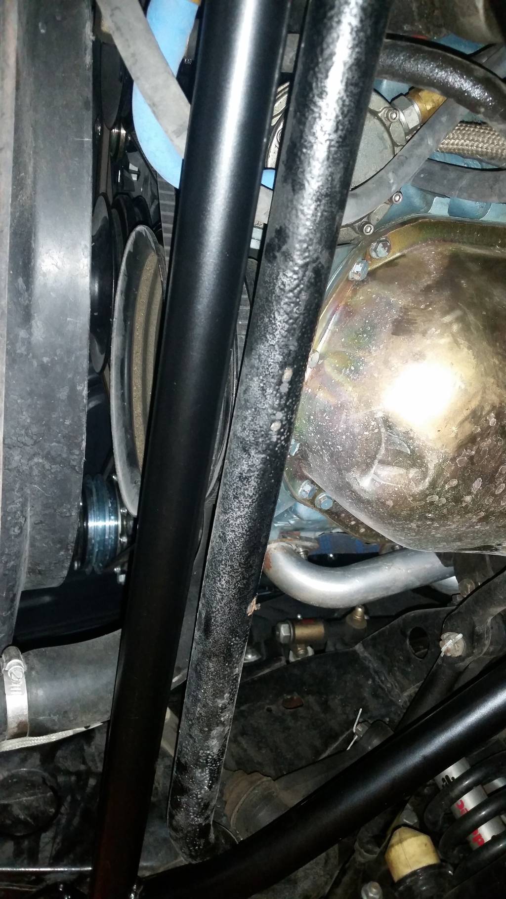

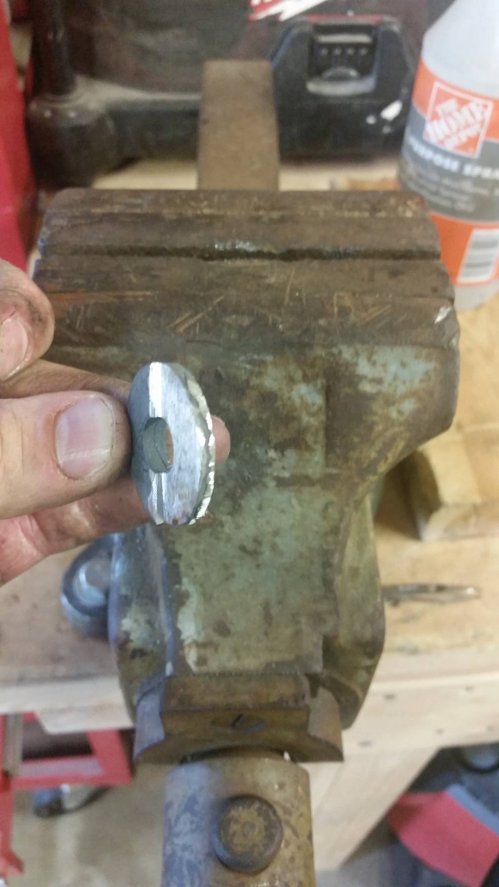

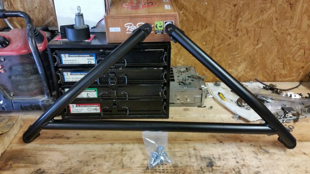

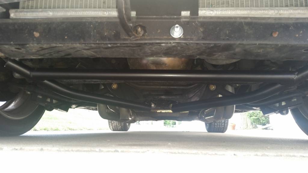

      A few weeks back I took a trip to St Paul for the Street Machine Nationals to Auto X. While at the track, I encountered a guy with a g-body that had a SC&C chassis like mine. He had pony'd up for the SC&C HD Chassis brace. This is a very common upgrade for G body guys. It triangulates the front frame rails and apparently even GM recognized there was an issue because they used a stamped version on the performance G body cars.
      I had kind of scoffed at it a bit at first but then talking to this guy about his, he was very impressed and he said the difference was instant and very noticeable, even over his stock ones he had removed. Marc had talked about how the front frame rails on these cars move under load and that the steering box takes all the abuse under steering conditions. This brace triangulates everything, ties it all together and distributes the load and A body cars really could have used these and really benefit from them...
      So I bought one. $217 shipped. It looks like about maybe $30 bucks worth of material if you wanted to hack one together yourself. This one is nice though and has bends where they need to be and it has a nice coating so ok.... Ill be the guinea pig.
      I will say I'm impressed with how much of a difference this made. My G body guy was right, it made the car much more snappy and athletic feeling. I had about 3 hrs installing it and the difference was pretty noticeable from the first corner I turned even at slow speed. I'm not sure how the frame rails move that much under load? You would think that they would wreck body panels with that much movement but they must, because the steering feels much more responsive.
      Here it is

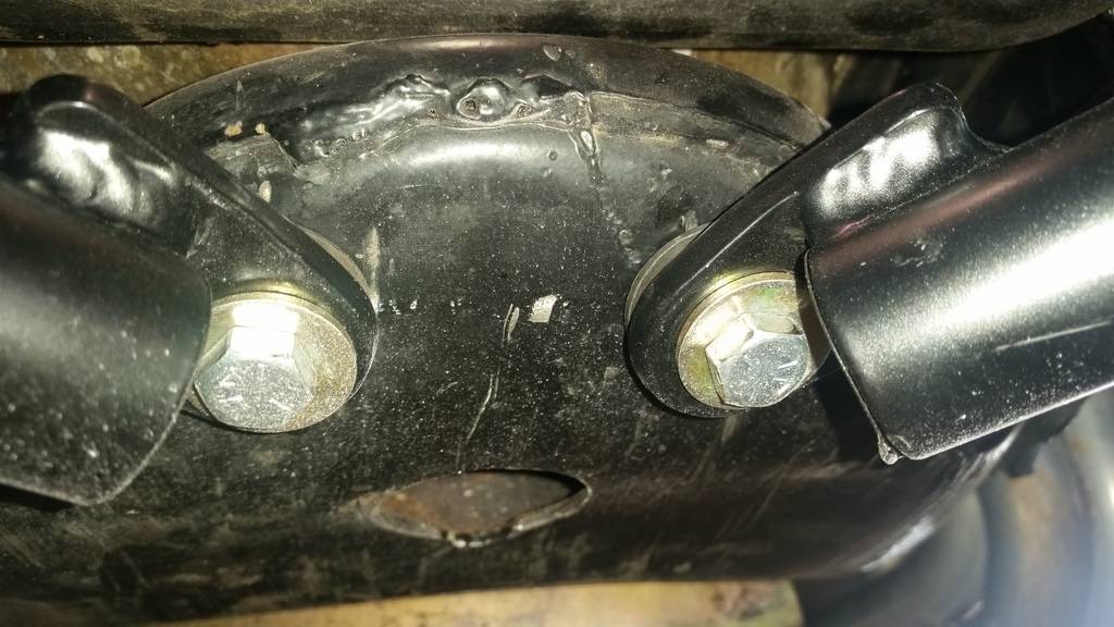

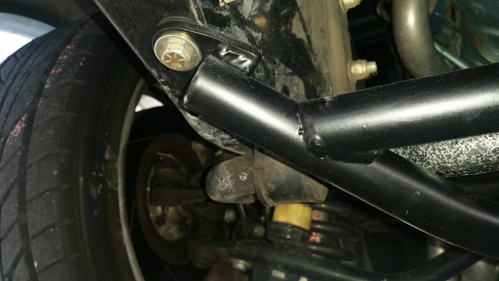

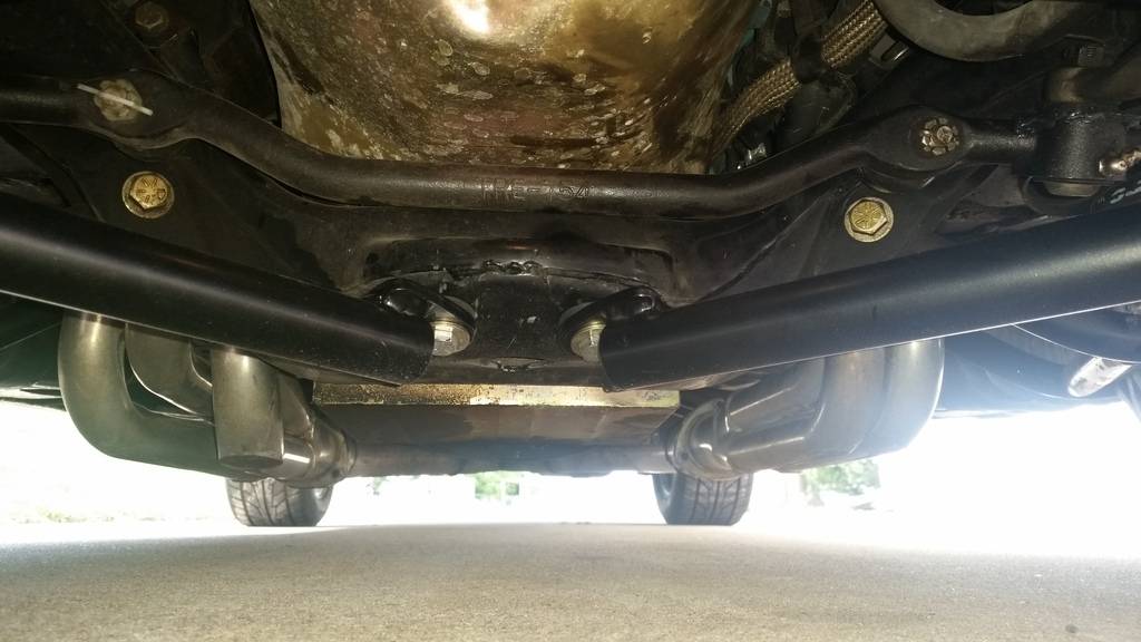

      The instructions say you have to center the piece, drill 2 3/8" Holes in the frame rails and 2 5/16" holes and tap for 3/8x16 in the engine cradle. That didn't go well for me. I ended up stripping the tapped holes in the cradle upon final TQ....so I got a 1.5" hole saw out and made a little room to get some nylocks and washers on the back of the bolts that go in the cradle. Oh well, at least its not some numbers matching frame and there was a hole there anyways so....
      I also ended up having to use .195" washers to space it down a bit to miss the swaybar. It says in the instructions this might happen so I was prepared. Inside the frame I had a buttlap weld right in the middle of the hole I drilled leaving a very uneven surface. This was leaving my bolt angled. I tried to get away with just tightening it down but I snapped a bolt off upon final TQ inside the frame rail. I used on of the thick washers to take up the difference inside the framerail and leave a flat surface for the nut to snug up against. Just a bench grinder and file was all that was needed...
      So I got that all done, TQ'd it down to 35 ft lbs all the way around, checked for interference and took it for a drive....this gentlemen is a great picture as to why you don't buy hooker super comp headers...

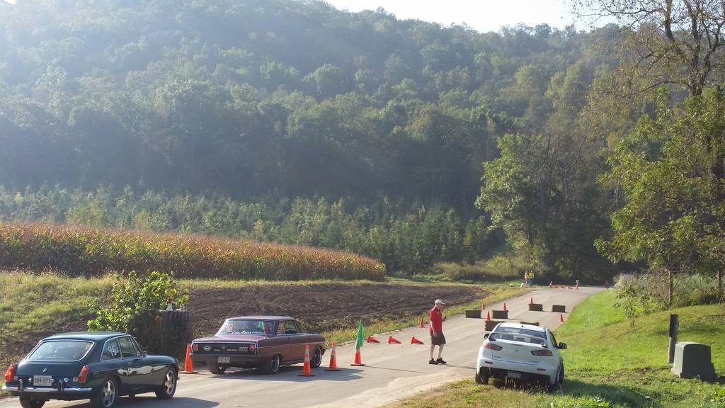

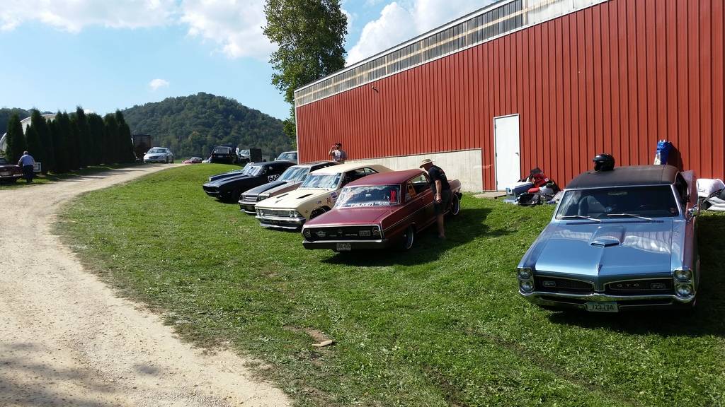

      Back at Street Machine Nationals in StPaul I was discussing future events with a friend. He had mentioned that there was a hill climb in Waumandee Wisconsin. Fast forward to last Friday. I packed up the GTO and headed up to a spot about 3 miles outside the middle of nowhere to take part in a vintage hillclimb race. Your car has to be 30 years and older to run.
      Friday night was homemade brick fire pizza and good beers on a farm with the rest of the field. Saturday morning 8:30 AM was the event and it ran until 5:30pm. The hill climb this year was a 500' ascent over 1 mile and no guard rails so there was definitely an element of danger though it wasn't really scary. The location had been moved from the last 3 years because that surface was unstable due to a recent recovering of the road. It's typically a 500' ascent over 2.4 miles on the original location and is supposed to be back there next year.
      I have to say this event was awesome. Everyone was a great, pizza was stellar, scenery was beautiful and the race was a blast. I got to ride in some pretty cool cars when I wasn't running. The event is limited to 75 entrants though we only had 51 I believe. Its mostly older "British" type sports cars like Triumphs and Austin Healey's and such but we had a pretty good musclecar showing with a Fox mustang, 2 mid 80's G body's, a 66 Chevelle, 63 Chevy II, 68 Camaro, 68 Mustang and my 67 GTO. Next year if you're in the area and you want to get involved in a blast of an event that only costs $75 bucks, I highly recommend this one...
      Directly below is a video of one of my runs. Click the small picture and it will take you to the video. Of course it looks slow because we're on video but I was probably in the 65mph range on one of the long runs in between chicanes. Just a heads up at the end of the video the passenger drops an F bomb right before I shut the camera off....I think he was just a little excited
      Random shots of my drive there and the event. I think the drive there and back was just as nice as the event.

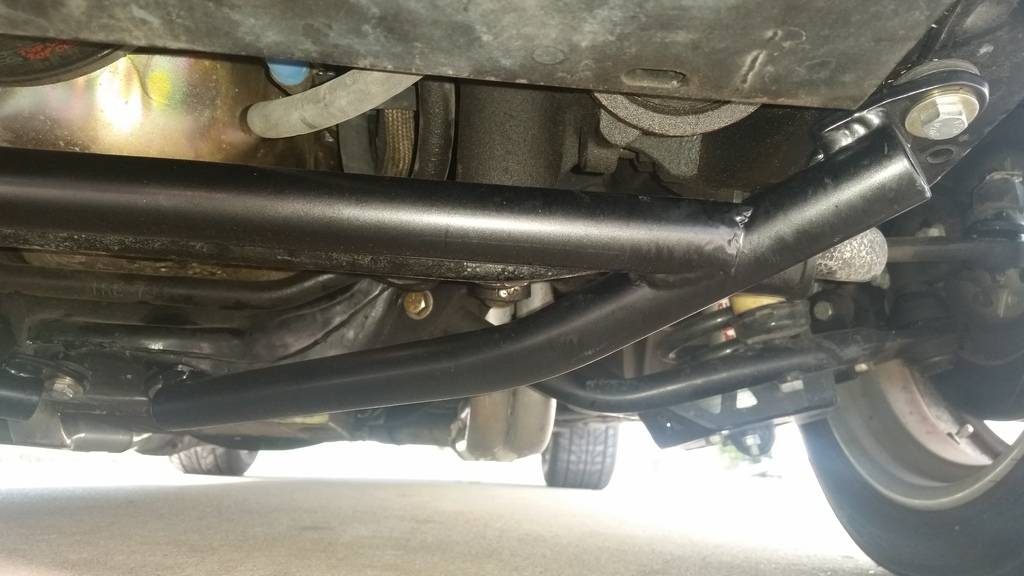

      -Fays2 Watts link. Im hoping to tame down the back end of this car a bit. Marc@SC&C says it will get it done. I guess we will see!
