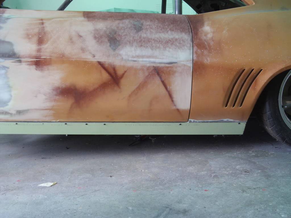

      thats a bad pic but thats mine in mock up. more pics comeing tonight so just look into my build. project md. i had mine bent where i buy my metal and they did it for free. very east. mine weld to the top of the rocker and the seem then go down and rap around the pinch. pretty east except when you have to build the fender one. alot of welding and fabricating so you can actually take the fender off
      Jan 2009
      343
      check out my build project m.d alot of pics of the fender
