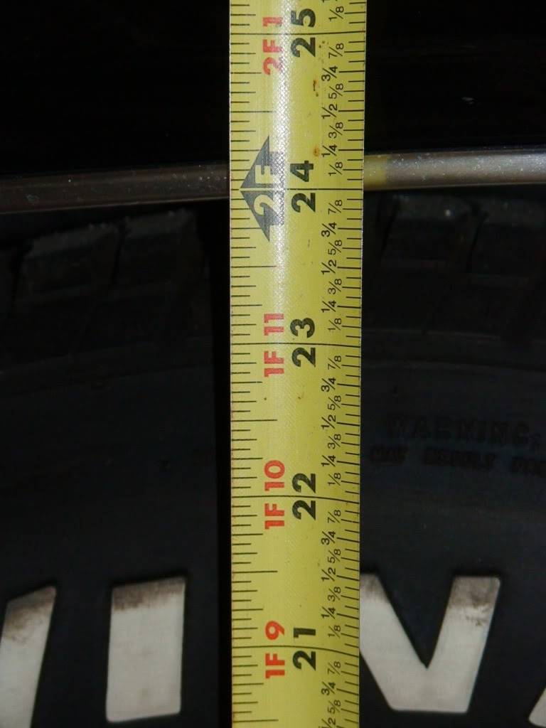

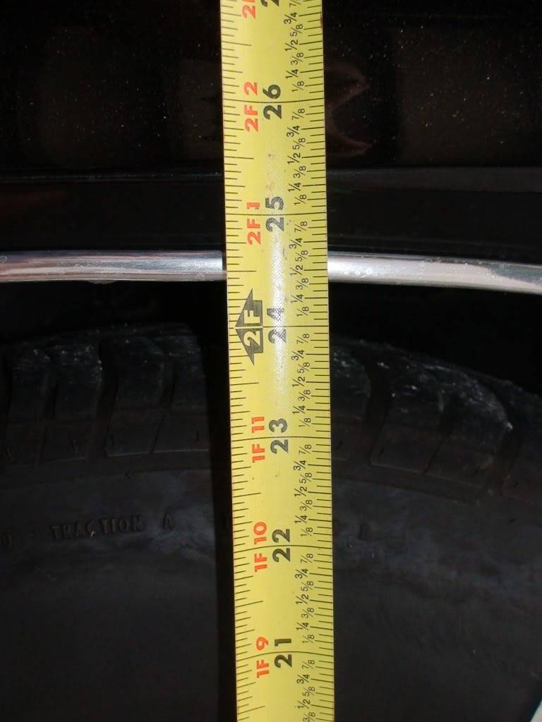

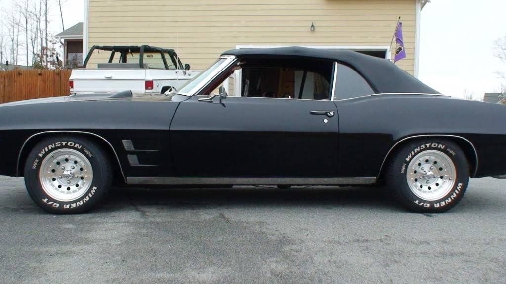

      Since North Carolina is covered in ice and snow, I have some time to post. So, here are a few pics. I hope that I post them correctly. These pics were taken a few weeks ago after completing the installation of the rear TVS kit components.
      front tire
      Rear tire
      Currently I have the front springs removed, but have not started re-installation. I'm trying to save up some $$ to get UCA, LCA, the chassis max kit, disk brakes all around and maybe even some new wheels. I figure that it’s easier to do all of this at one time if I'm so fortunate. $1500 and counting.
