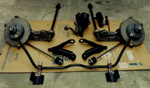

      SUSPENSION
      • TORSION BARS: .99" 184 Lb./ft wheel rate stock .87" 109 Lb./ft, livable, stiff, train tracks feel like bottoming out
      • REAR SPRINGS: Stock for 8¾ 68 Formula S. Car seems balanced now. Might need stiffer so don't need rear sway bar. If so, will just add leaves to dial in. But soft helps planting and rear transfer. Good shocks might have to come first. Need testing to sort out.
      • FRONT SWAY BAR: Addco 1 1/8" ($40 used)
      • REAR SWAY BAR: ¾" dia. Addco aftermarket ($35 used)
      • SHOCKS: Front QA1 single adj ($75 used) blew out all my hand-me-down used Konis, Rears: Hand me down KYB's
      • POLYGRAPHITE: sway bar, brake strut rods, lower control arms. Leaf bushings; can hear slight resonance when added to rear. Would not use LCA poly again.
      • UPPER A-ARM BUSHINGS: offset, Moog prt.# 7103 installed opposite, more caster, more road feel, more high speed stability
      • STEERING STEERING GEAR: Replacement Mopar remanufactured. Large steering gear spline, crisp, firmer, but not Firm Feel
      • PITMAN, IDLER, CENTERLINK: all ‘73-‘76 A-body, to accept large spline gear
      • POWER STEERING FLUID: Justice Brothers heavy duty, don't change often, so extra cost is cheap assurance
      • POWER STEERING CAP: later style multi knobbed style with rubber baffle to stop spitting up.
      • Future plans: Adding factory power steering cooler, in-line filter, and braided lines for power steering .
