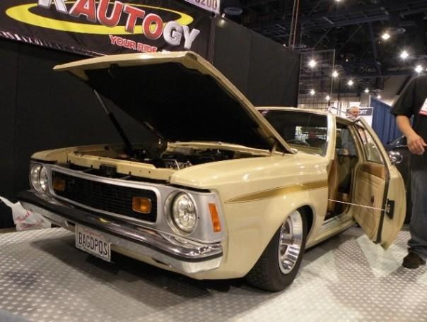

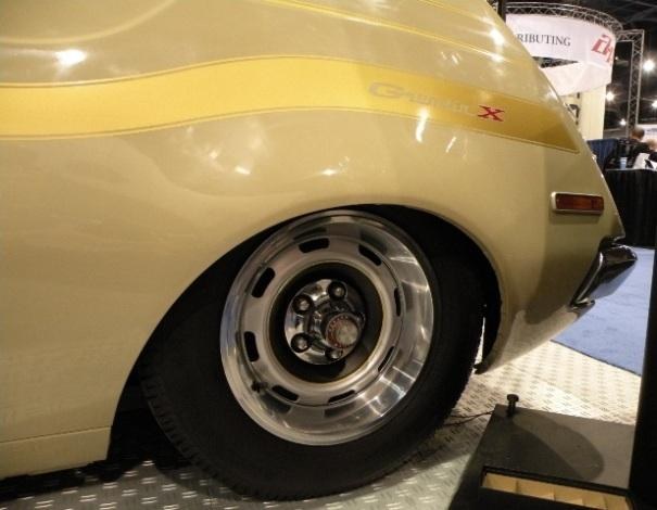

      Quote Originally Posted by 96Z28SS View Post
      There was a gremlin at SEMA it was on air ride, the doors were suicide
      I didn't get any pics
      Google is your friend...
      Tucking something awful
      Not pro touring, but pro badass

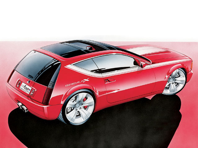

      If you're gonna do one and you've got the skills, I'd love to see this thing come to life:

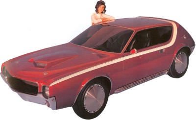

      Oooo... look... "factory" pro-touring effort:

      Quote Originally Posted by DarkBuddha View Post
      I've wanted to see that come to life ever since I saw that picture.
      I even looked for a Gremlin for a while, until I realized people wanted a lot more money for rotted out shells than I was willing to pay.
      looks like
