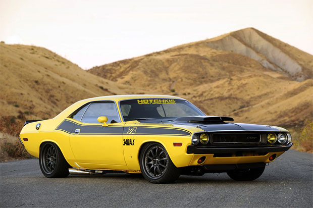

      We have lots of shop and track time on our 70 challenger, so we'd be happy to talk with you if you have any questions about control arms, steering components or sub frame connectors.
      Hotchkis Challenger on Jay Leno's Garage

      Hotchkis, ur challenger is pretty much what we are aiming for. Had the idea in my head and came across ur car and finally saw what I was planning. Off the wall question, where did u get the inside yellow headlights? Before I ever saw yours I grabbed a pair of yellow foglights from a mercedes and was planning on replacing the high beams with those.
