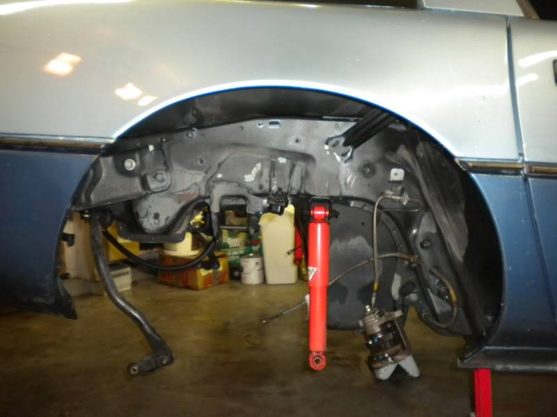

      Well, I have been working on it some lately. I haven't had as much time as I'd like for photos and posting, but here is an update:
      The Good news:
      I have finally started reassembling things!

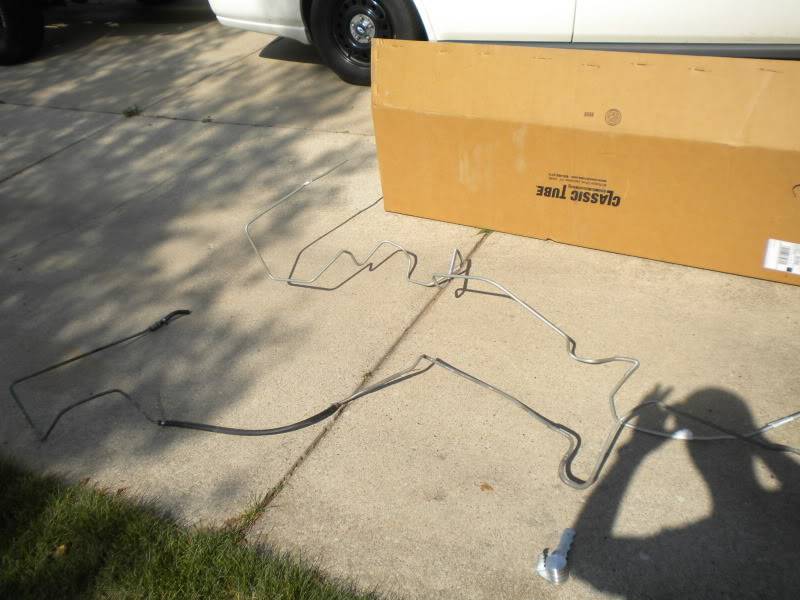

      I have the new Classic Tube fuel line in (which required the whole rear of the car off give or take).

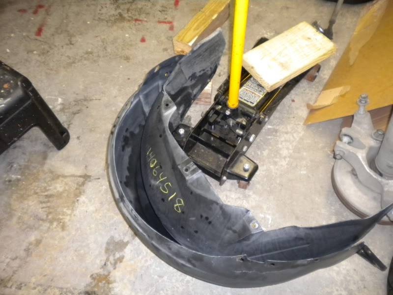

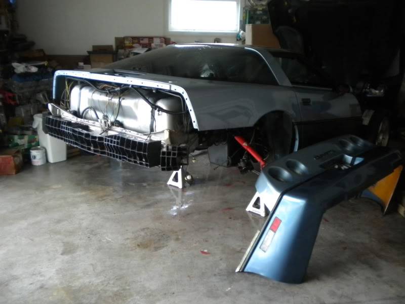

      I took off the rear facia (nightmare). Lots of hard to reach bolts and sweat and blood involved...

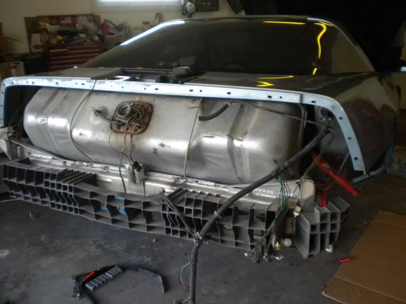

      And dropped the rear bumper/gas tank assembly:
      More on the gas tank in the bad news section...
      I have had some help in the garage today in form of my 7 year old son Patrick!

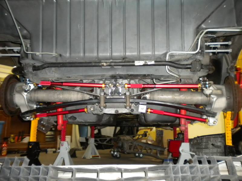

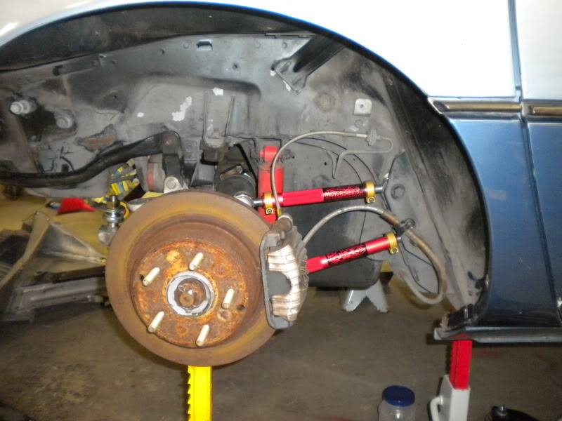

      So I was able to get all rear suspension back in. I replace all the consumables: new SKF hub/bearings, ARP wheel studs, Spicer U-joints. I picked up the whole rear kit from Banksi: rod ended camber rods, toe kit, and trailing arms.
      I deleted the dust shields on the rear brakes, and I think I'll leave the rear wheel wells off.

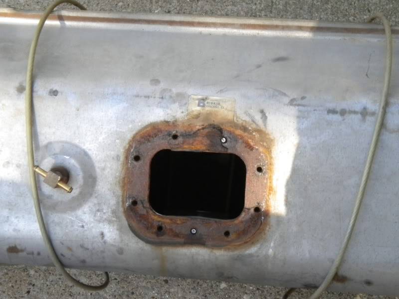

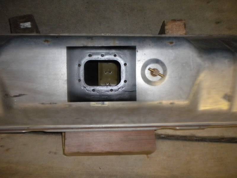

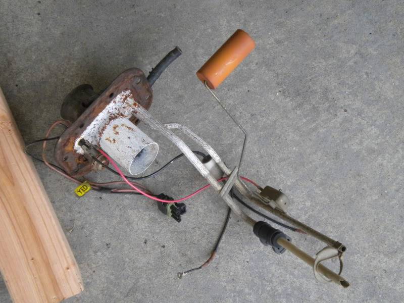

      When I dropped the tank I found the sending unit rusted to the tank. Two of the bolts snapped off. The sending unit was *******ized like the fuel line (pump replaced w hose). If you remember from early posts they also cut up the factory hardline to put an external pump under the rear axle...??? I have no idea why when the car has an internal pump. I intend to replace it with a nice Racetronics kit.
      I do have a new sending unit from Corvette recycling. I just have to clean up the fuel tank 1st. Oh, and did I mention my local radiator/gas tank place stopped boiling tanks two months ago?!

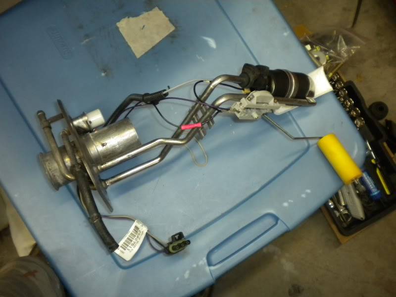

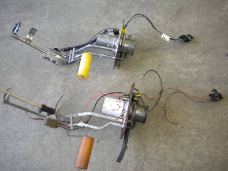

      I did some work on the gas tank today. I drained it as much as I could and washed it out w water days ago. It still smells like gas but is dry. I was worried about going after the rust (explosion). Today I bit the bullet and hit it with a plastic media wheel on a drill. It cleaned up well, and no sparks...
      I threw a quick coat of paint on:
      Down side is the cheap bolt extractor kit I bought at AZ did not help w the two broken bolts. However I did bust several drill bits... Those tank bolts are hard!
      I switched over the wiring on the late C4 sending unit. I just pulled the factory wires from the old 3 plug connector, the new 4 conector, and put the new unit wires in the old (3) connector. The new sender didn't even use the 3rd place, so I think I'm good.
      I also put in my Racetronics pump and sending wiring (just 2 splices - it was for the 84 sending unit).

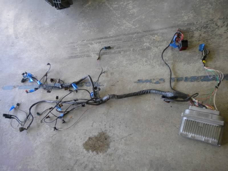

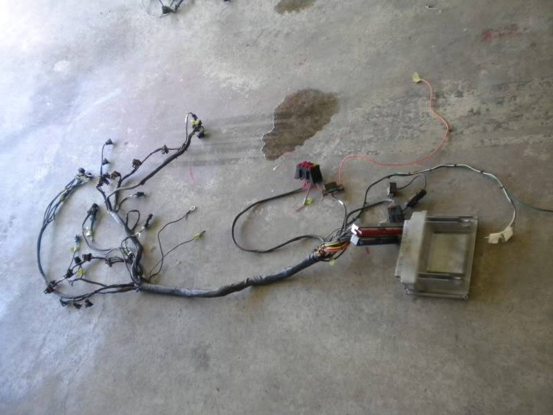

      I got my new (to me) harness in yesterday! I originally had an S&P harness for the LS1 and 4L60E that came in the car. I was going to modify it for the T56. But then I found a great deal on a used S&P harness for an LS1/T56 combo, so I jumped on it.
      For anyone doing a similar swap with an auto, my other harness is currently in classifieds.

      we have a very similar rod-end rear suspension in our track only c4. it may even be the banski, dont rememebr. it is the sam colors, though....
      i dont like it. after a bit of time, it allws play with the rear spindles. you think its a wheel bearing, but its the whole spindle moving slightly. i still avent figured out a fix, but just be aware of this.
      the rear faschia is a pain. after building a few C4's, i know all your pain.
      good looking swap thus far. keep up the good work, and i give you kudos for teaching/spending tine with your son while doing this.

      I'm not really a fan of rod end parts to be honest. On the camber rods, the stock set up was expensive and a weak link though. I feel similarly about the toe rods. They need to be adjustable, and play is a bad thing.
      However, from day one I have considered keeping the stock trailing arms. I don't see a big advantage in adjusting them, and if you don't need adjustment it is a liability. I also think a little deflection would be ok to soften the blow on the tires during hard acceleration.
      The older I get, the more I like stock parts. I would really avoid heim joints on a street car, I learned that on my 02 Z28. But this project was intended to be a track car at heart, just barely street legal.
