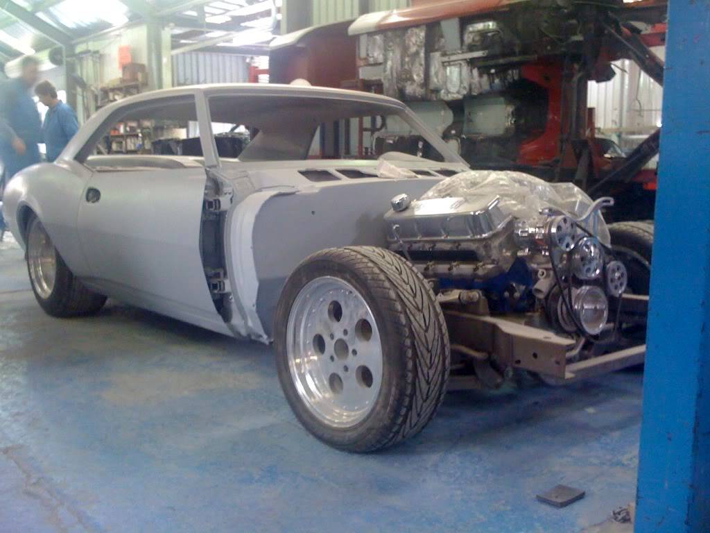

      As you can see in the pic above we cut the whole handle and surrounding panel out and weld that in. For the mechanism we leave the original latch and striker, Prob is the original handle "pulls" the mechanism up, the later model handles "push" the mechanism down. So we simply played around with switching this around. Flipped the mechanism on the back off the latch upside down. All good. Actually wasn't that hard of a job just fiddly
      Here is a current pic of the car.
      We have flushed the glass as well.

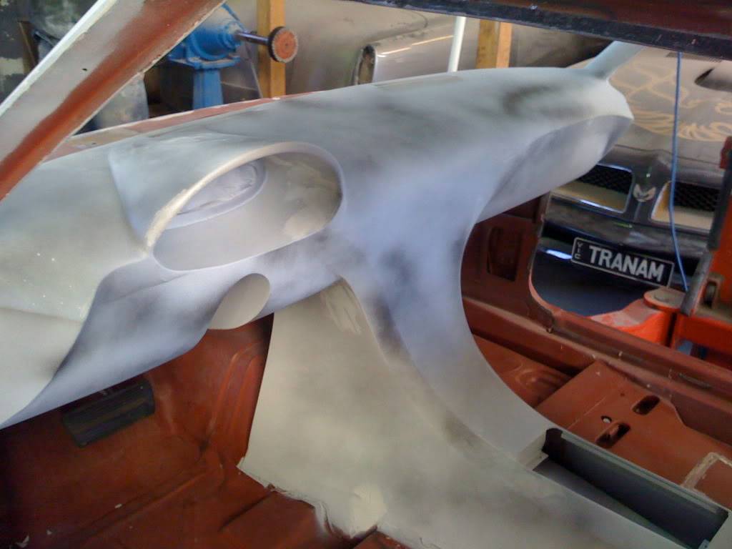

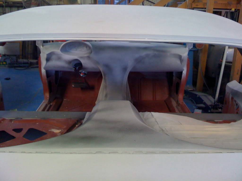

      Interior is 100% smooth. Metal hood liner, new metal dash (custom), full metal console right through to rear parcel shelf. All switches, buttons, trans shifter, everything will be hidden under a metal panel. You will literally see only the twin Dakota Digital gauges and the steering wheel inside the car, everything else is hidden

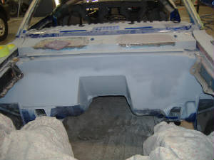

      Neil, I will try to post a pic of the firewall...(delete everything!)

      Here's the firewall Neil...note the filled in cowl vents too!
