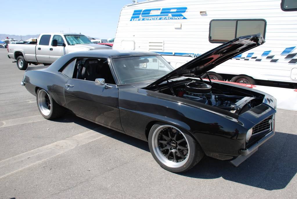

      I'm running a little more lip than most with the DSE frame with my race setup. Forgeline shaved some material off the hat to get the backspacing perfect. However, you must run a 13" rotor and you will need longer studs in your c6 hubs to make it work.
