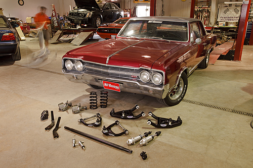

      Hope you all checked out the Jan and Feb. issues of PHR for the stories on the build up of our project. Here is where we are at...
      After we stripped it...

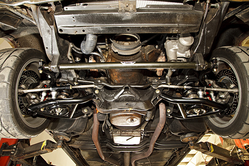

      DSE's Front suspension...
      Installed...

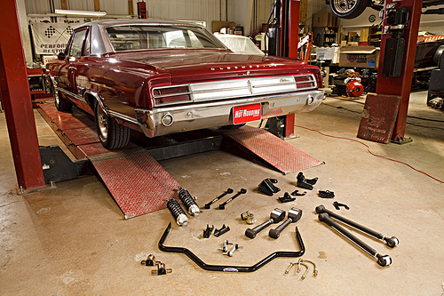

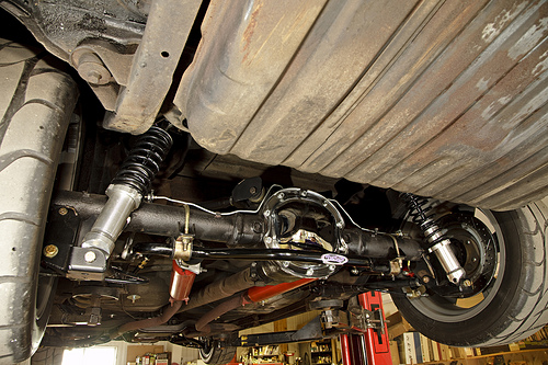

      DSE's rear suspension...
      Rear suspension installed...

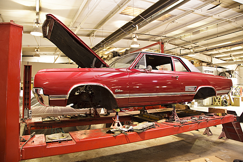

      Brent Jarvis at Performance Restorations setting up the car...
