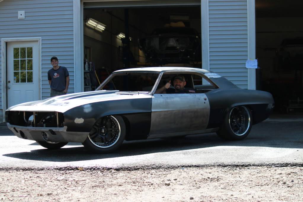

      Hey Payton yea we are coming again this year actually we are loading the truck right now to leave later this evening! Always good to see other fellow razorbacks!
      Jason the rims look great and thanks for taking care of us!
      Everyone else thanks for the kind words it just adds to the inspiration to move on!
      I think the main thing is for everyone to realize Jakes Rod Shop is not only a great place to get an awesome suspension for your car but they can do everything to help you get it on the road!

      Awesome! Great stance!

      looks great.

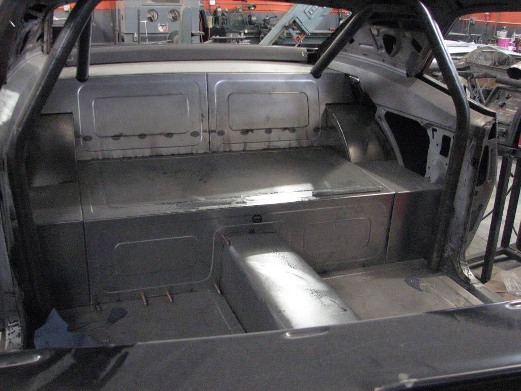

      What will be your final ride height at the rockers? I saw the wheels sizes, what tire size? Also do you have any pictures of the tin work at the rear 3-link section/frame?

      Final ride height at rockers will be 5"s, tire sizes are 345/30-19 rear and 275/40-18 front
      Jake is finishing up tubs and rear inner tin work soon and will be hopefully posting pics of the progress!

      Thanks! Looks Great! I'd really like to see the final tinwork when it gets done. Jake really does great work.

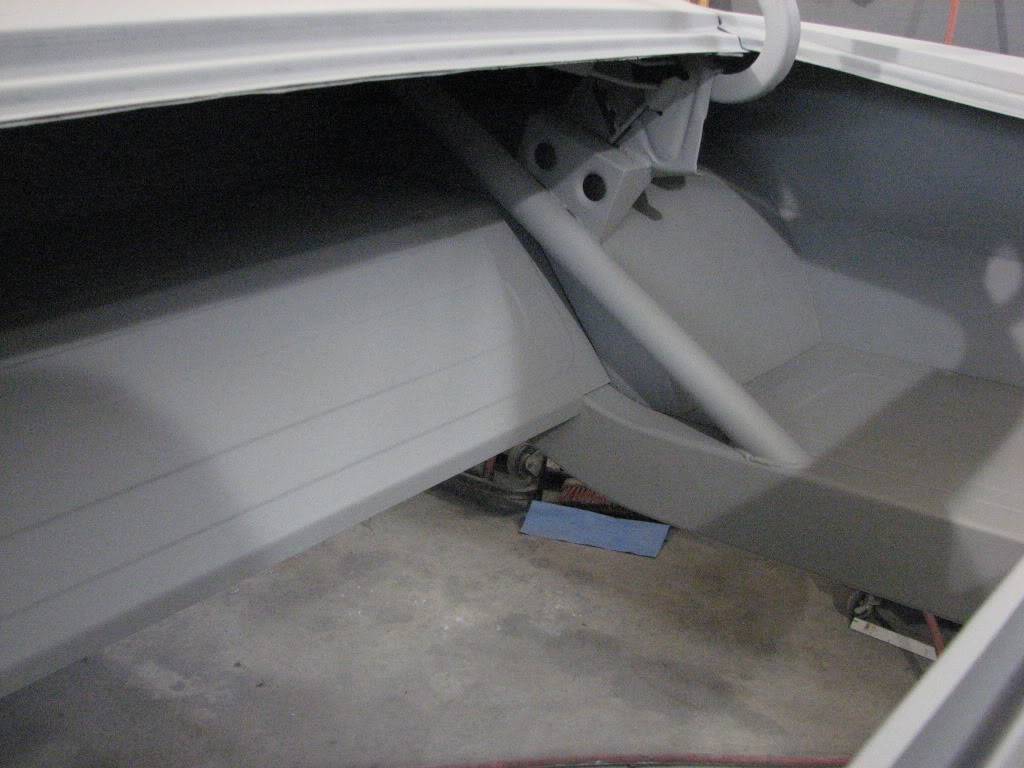

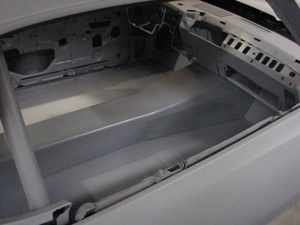

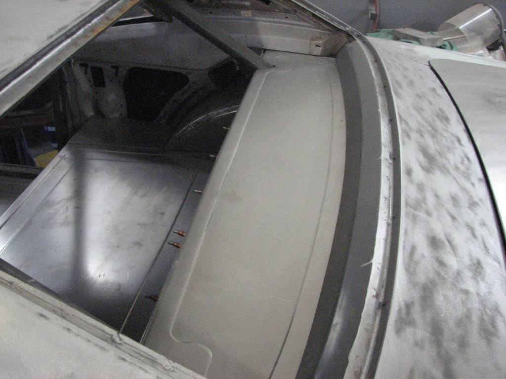

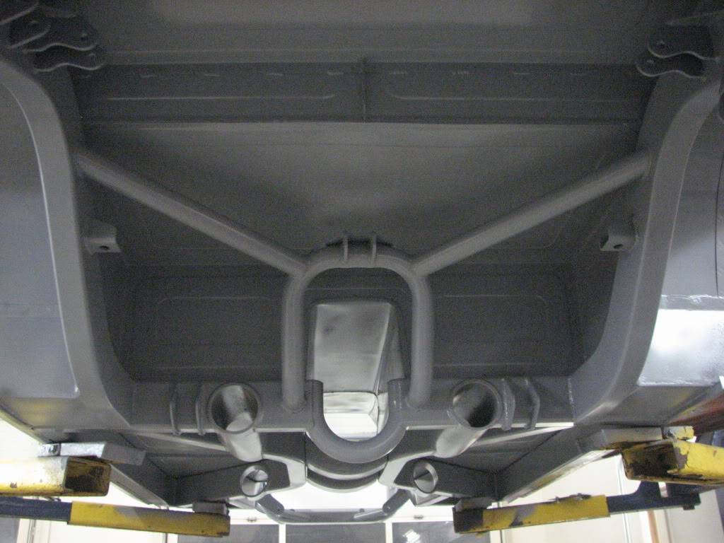

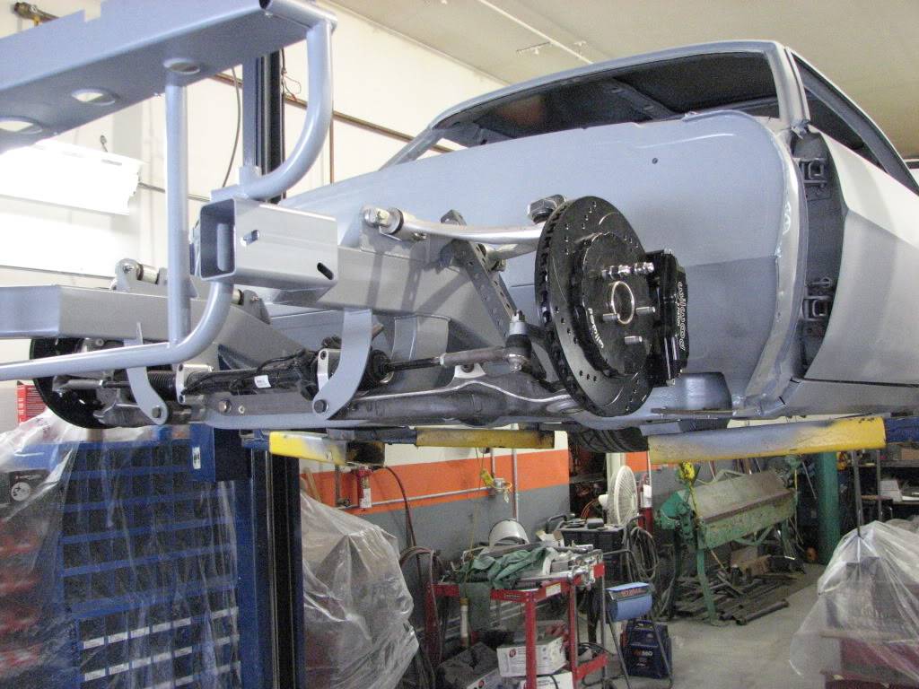

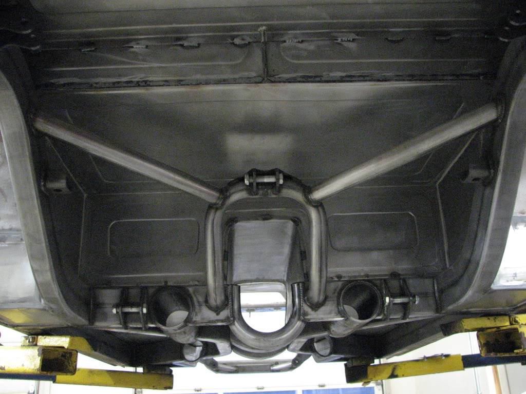

      Guys, heres an update I have been meaning to post. We finished up jays metal fab for the most part, roughed in a few area in body work and ep primed it. It is really taking shape to be a badd ass car. Jay is trying to figure out his motor selection and tranny so this monster can be finished. Its has as good of a stance as I have ever seen on a camaro. Anyway here are some updates to his build and a link to the project page. Let us know what you think.
      link to more pics-http://www.jakesrodshop.com/www.jake...aro_Build.html

      Very nice!
      Keep up the Killer work!

      That looks awsome! they do excellent fab work.

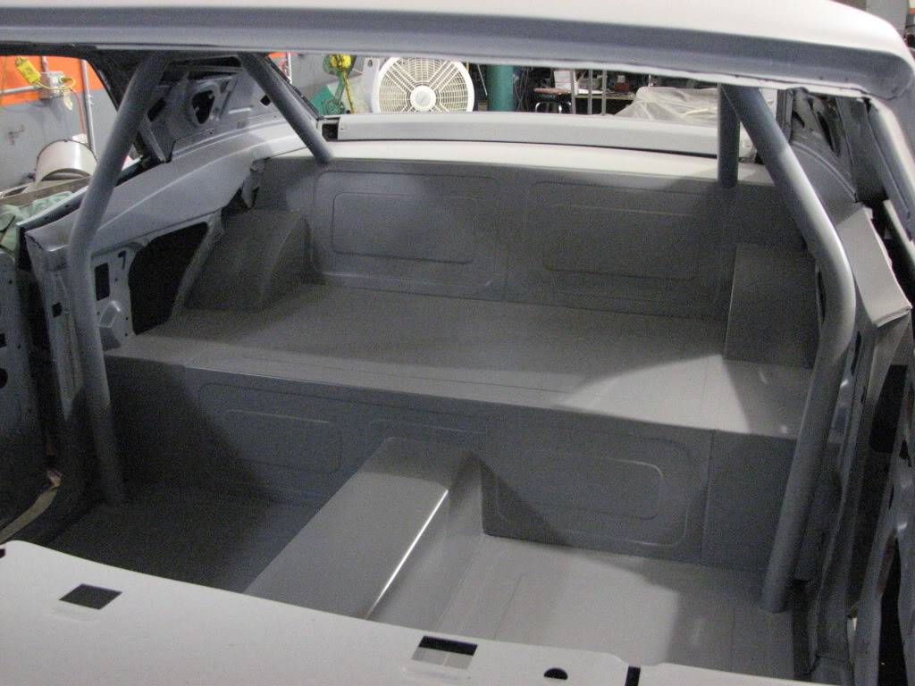

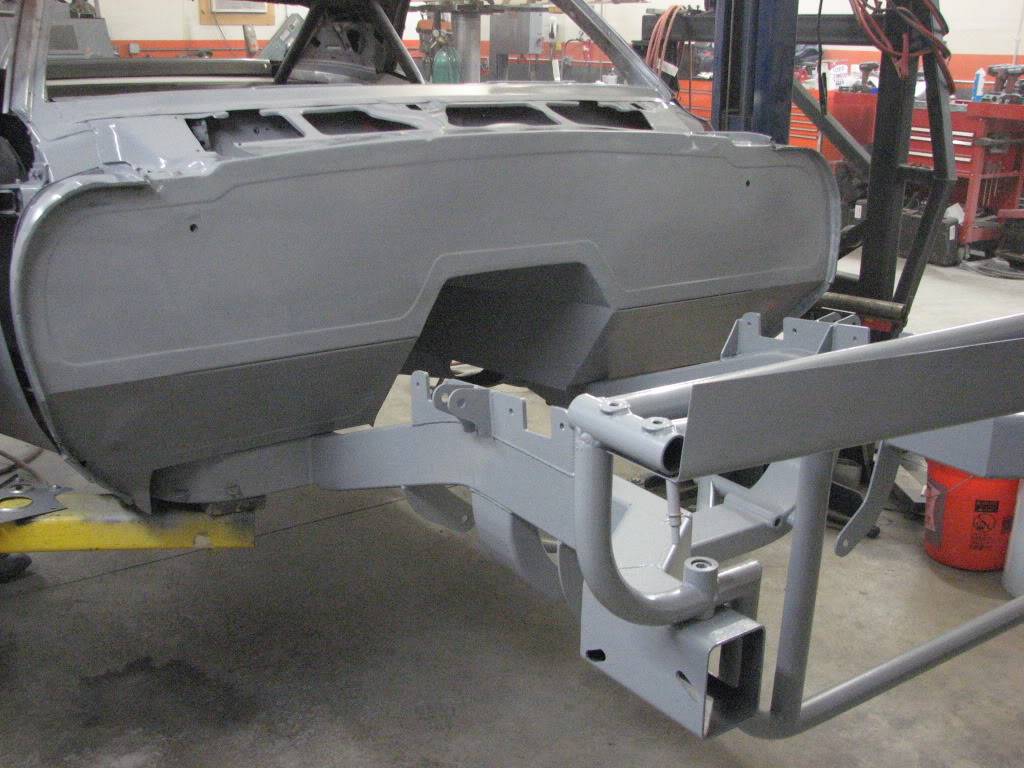

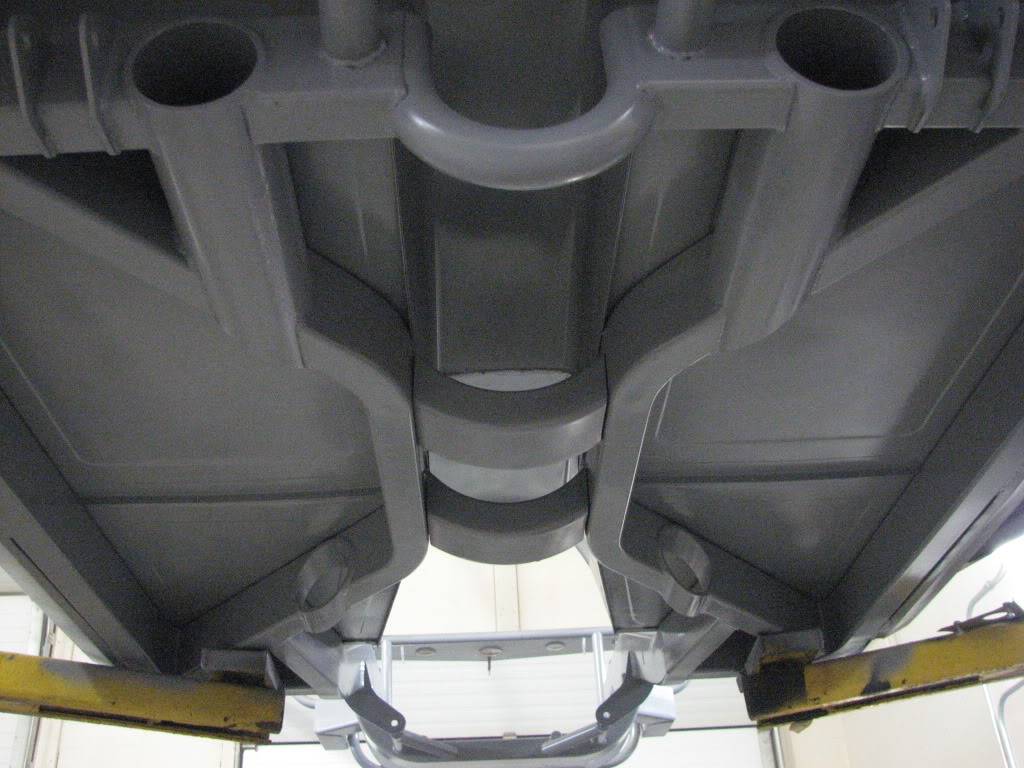

      Guys, a few more misc pics.

      That looks great!!!
