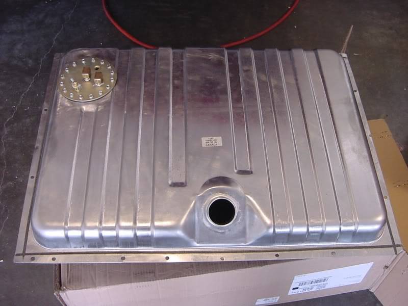

      I didn't take any pictures along the way, sorry. but here is today's finished product
      I used a Tanks Inc universal 255 lph in tank pump. Bought a new repop 22 gal tank and sunk the pickup/pump/baffle assembly in.
      Pretty easy, cut a 4.5 inch hole, cut the pickup frame to put the baffle and pump at the proper depth (bottom of the pan) then weld a ring to the inside of the tank.
      Pressure tested the tank at about 2.5 psi and all is good. I will still run the stock pickup for the gauge sending unit, but plan to cap off the line in the middle with an AN fitting/cap in case I ever need to add something later.
