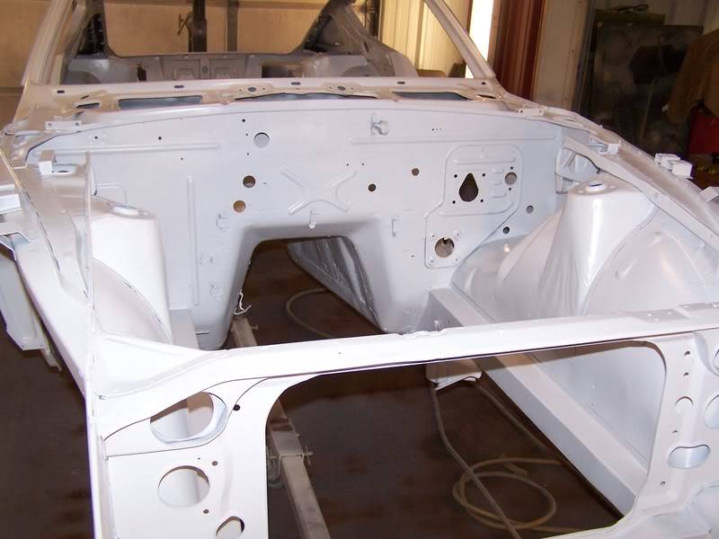

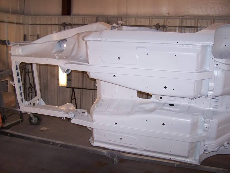

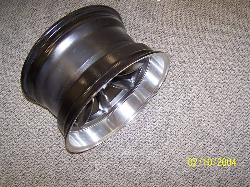

      Rota Wheel
      Media blasted and in white primer.
      Entire car will be white to include underbody, that is paint on the underside not primer.
