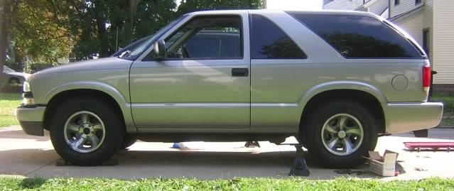

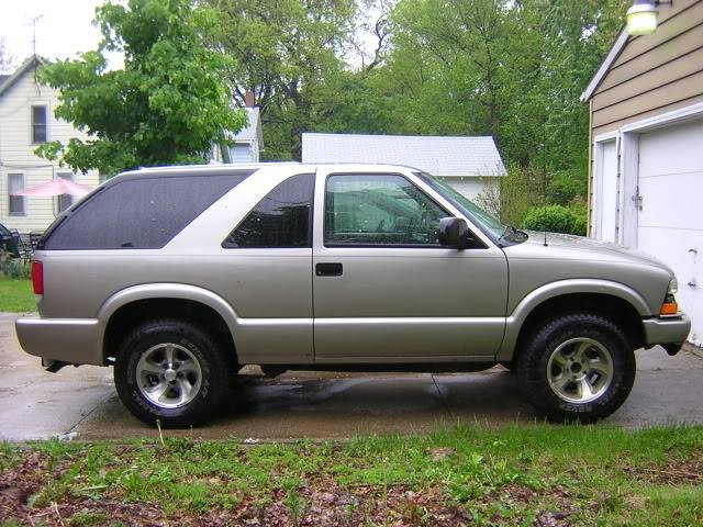

      Here's how it looked most of the time I've owned it.
      I removed the roof rack and plugged the holes and I also removed the chrome trim around the headlights and the chrome bar across the grill. (I kind of have a hatred toward chrome. I'm not totally against it but try to keep it to a minimal amount.)

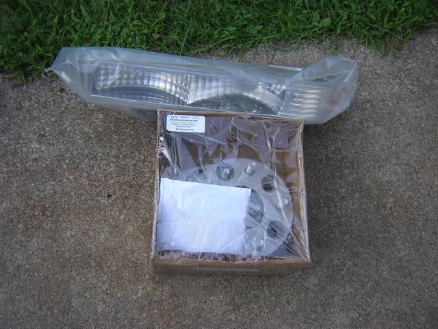

      While walking through Summit Racing looking for trans fluid, they had some clearance tables out and I just happened to find some goodies. I picked up a set of returned clear markers for $20. Not bad I thought, until I came across a pair of 25mm Eibach wheel spacers for $25 (they retail at $202!)

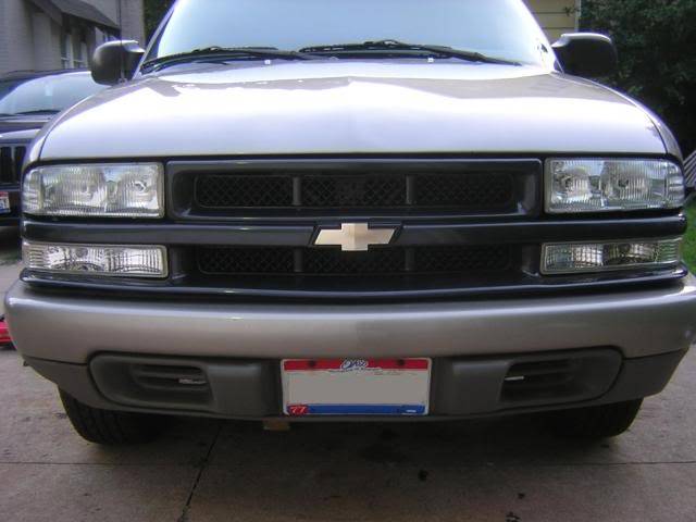

      I got a repop of an Xtreme grill from eBay for cheap. Even not painted, the new grill looks much better. The marker lights had small fitment issues but nothing a couple files and time couldn't fix. Now the front of the truck looks more complete. I still need to get the grill color matched though.

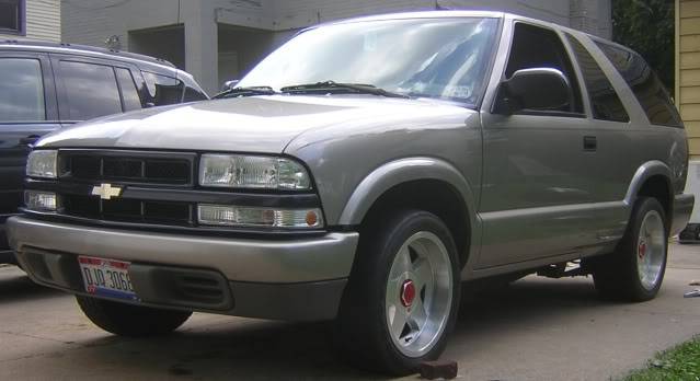

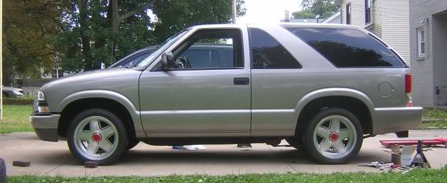

      Thanks to the wise people at GM but they decided that a 4x4 stance would be great for a 4x2 vehicle. So after a bunch of $$ and several trips to Summit Racing, I got Project WTH lowered. It's not as low as I wanted but it's close and I ran out of $$ to make it any lower this year. I think final measurements were 2.5" in front and 2.125" in the rear.

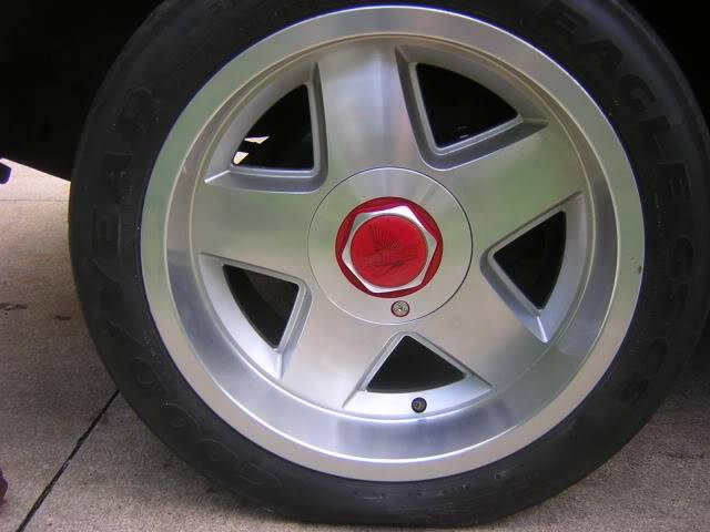

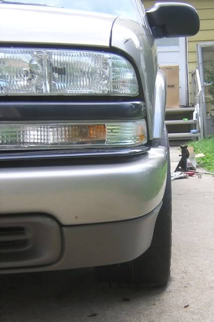

      I also couldn't help myself and threw on the adapters and 2 of my Firehawk rims. The 275/40-17 Goodyear racing tires with shaved tread really demostrates that I need to go a little lower to make it look right.

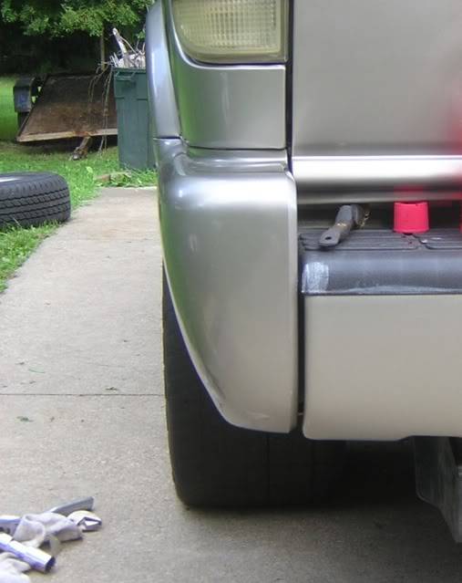

      The front rim/tire sits close to flush with the fender...
      But the rear rim/tire isn't as flush. I plan on getting 1.25" spacers, instead of 1", for the rear to fix that.
