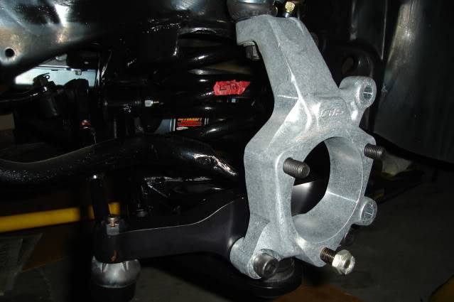

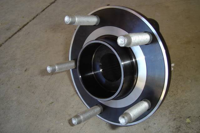

      quick AFX spindle questions
      for a g-body, do they change the track width any? what's the hub lip diameter? is it the stock corvette dia? and is it a stock 'vette bolt circle?5x120? i hope to go to AFX but i also need wheel spacers and want to buy one set only.
      while i'm asking questions, which is better, (i don't know how long before i can afford the AFX spindles) F-body spindles with adjustable control arms or the sc&c stage 2 kit? i'm leaning towards the f-body because i also need 'vette brakes and have the spindles.
      just in case, i'm going to use c5 speedline rims in 17x8.5 and 18x9.5
      thanks for the help

      The Corvette hubs used with the AFX spindles have the 5 on 4.75" bolt pattern (5 on 120.65mm).
      As far as any track width changes on a G-body are concerned I'm not sure, but on the A, F or X-body cars they don't increase the track width.
