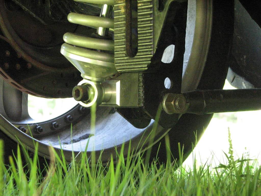

      Vinny's car still has air ride. As for my car, the torque arm conversion kicks ass. Completely transformed the car in terms of both handling and ride quality. I switched from dried out, 5 year old Nitto NT555's to Toyo R888's at the same time. So the tires greatly contribute to the improvement as well. But when I tell you the improvement is night and day, I mean 100% improvement. The car used to wheel hop badly on launch and push thru corners to the point that it would fold the outside tire under. Now it rotates nicelt with just a touch of understeer if you push to hard. The understeer can be corrected with just a little throttle input. Brake hop is a theoretical byproduct of torque arm geometry. There is none--not even in Jake's car and he has way more braking force and driver skill. Install's good too. Best exhaust clearance around--including tailpipe clearance. And the panhard bar is a snap to adjust.
      The driver (me) needs a lot of work, so I have not found my chassis' new limits. My Gingerman video is in the auto trans section. Watch Jakes, he's a way better driver. His video is more fun to watch. Also including a Jake's Rod Shop kit pic (ignore the crusty axles. They are a carryover from the prior setup.

      The updated mount is below, its a real nice cnc mount, that mounts to trailing arm bracket with two 1/2 bolts, with the lower one going thru the shock,heim spacer and block. Very strong and will never go anywhere, sorry for pics, just went out and took it off twist machines test car.
      Jake
      p.s No hardcore launches done yet, though vinny is getting a Jrs Apex front and rear susp this fall.
